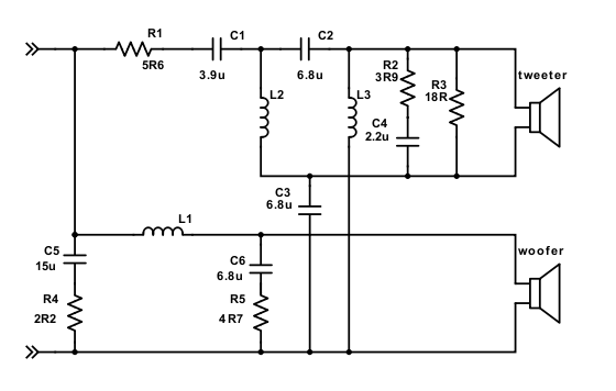

I really hope that isn't correct - it'll have an impedance that drops to around 2ohm for most of the range. Maybe lower. Ouch!
There aren't many amps that will sound good under those conditions.

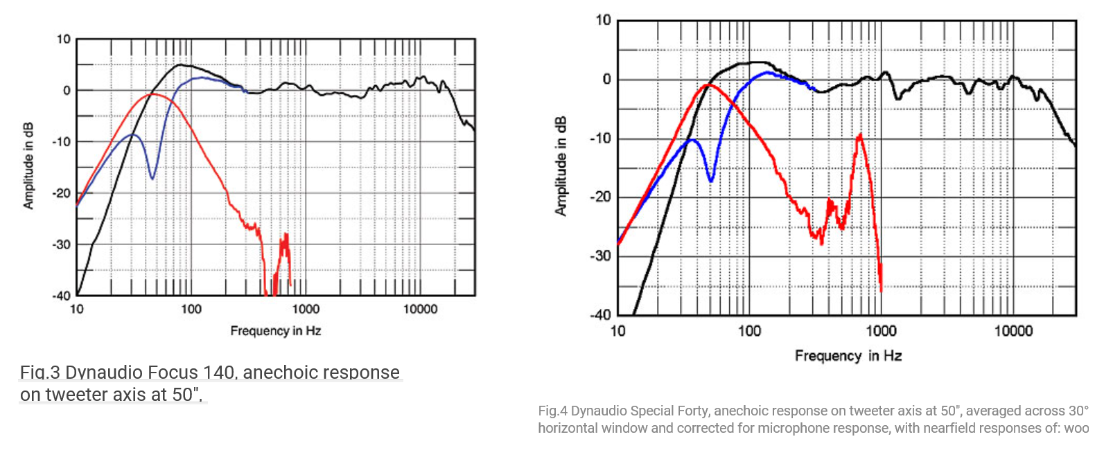

I advise OP to take a closer look at possible mods to reduce the resonance coming out of the port. Focus 140 woofer is smaller than Special 40 but I guess a better sounding loudspeaker with comparable woofer low end output, for considerably less money.

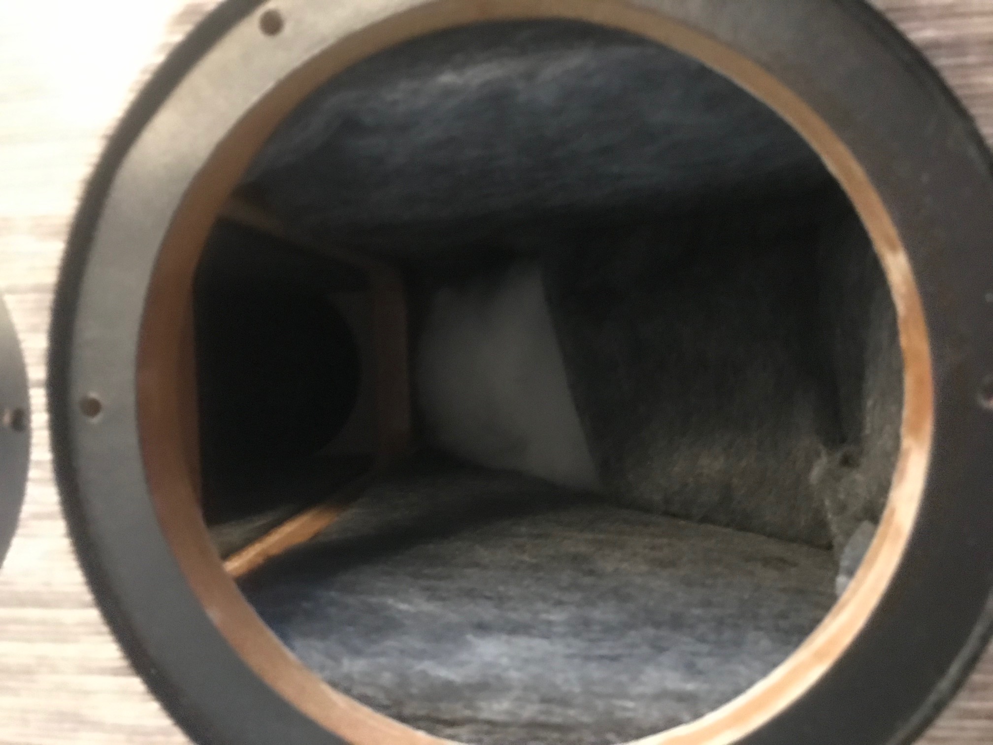

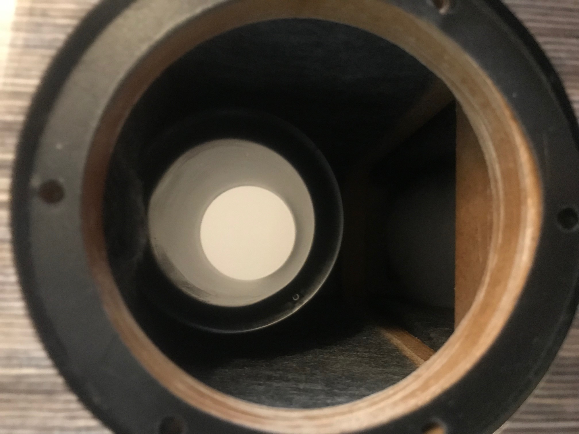

Show us how the manufacturer treated the internal of the cabinet. You would need to remove the woofer. In case it does not get easily out, help yourself by slowly pushing it out from the terminal part opening. It can appear as if the driver was glued to the baffle, sometimes.

Kawi, thanks for the photos. I would check if the internal walls were covered with bitumen pads, and at the same time perform the knuckle rap test. The sound of it should be rather "dead". If there was no bitumen by default, I'd consider getting some, like the self adhesive ones you would see used in automobiles. The resonance garbage coming out of port is likely an airborne resonance that calculates roughly to the internal depth measure. Anyway, the cavity behind the woofer should be filled with poly stuff (cabinet damping material) in such a way (neither too much, nor too little) that the woofer still has some free space to breathe to the port and suppress the resonance completely. The result is best confirmed by measuring, and listening of course. I use stuff that can be bought at upholstery supplies, looks like a poly rug 1" thick and can be easily made to a roll and stuck in the enclosure to fit tightly, without adhesive.

To post #56: an average 50 cent Wima MKP cap measures way better than any "premium audio grade" PIO rubbish. Apart from that, I don't know what you did at Bell Labs, but as an engineer you understand, that EVERY crossover apart from the 1st order series distorts the signal? No matter how much you pay for the parts.
