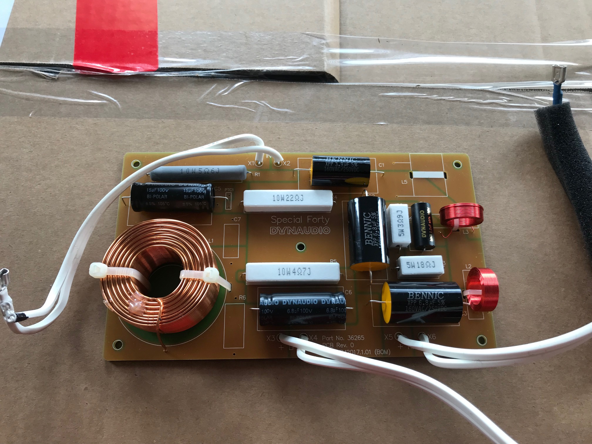

Crossover Upgrade Suggestions
Thinking of replacing some of the cheaper caps etc
Please give your input and thoughts -
Thanks so much!
Picture of crossover attatched

OK. The first question (and it's a serious, i.e. genuine one) to ask is 'what is wrong with your existing crossover capacitors?' Or to put it another way, what are the problems or limitations they are causing / imposing upon your loudspeaker, or overall system? With those identified, you can consider what will be the best of the many possible options. It's difficult to make any recommendation worth reading without knowing what these problems are, and what the rest of the system is.
When the speaker is given really difficult recordings it becomes overwhelmed.
They can be slightly muddy at times as well. I would like to have a very neutral/every so slightly warm sound with lots of detail and the ability to organize difficult recordings as well.
Fair enough, and I don't doubt either your summary, or your wishes, but my question stands, i.e. what is wrong with the existing capacitors, or, if you would prefer it phrased differently, how do you know they are the cause of the limitations you mention, rather than something else?
You don't mention what speaker it is, but from the PCB it appears to be a Dynaudio Special 40. That's a reasonable / well designed commercial standmount of its type, but if it's like other Dynaudios, it's likely a 1st order acoustical crossover. These are not without merit when implemented well, such as good phase response &c., but 1st order acoustical crossovers by nature also tend to push the tweeter quite hard, so on fairly demanding material, distortion can be higher than with designs using higher order slopes. It also tends to mean running a higher XO frequency, and that can result in a less even polar response, which in turn can affect tonality. So I hate to say it, and I could be completely wrong (not unusual), but I suspect your issue is simply that this particular design does not meet your requirements, and changing a couple of crossover caps isn't likely to change that.
Better caps and resistors (don't forget them) will give a clearer, more controlled sound.
However, where are you going to put them? A Jantzen Superior (mentioned above) 15μF will take up a quarter of that PCB! That's just one component and your speakers are fairly small.
Good quality drivers deserve the best components. The fact the speaker gets good reviews without shows there is potential there.
Dynaudios have their merits, -punchy, dynamic, outstanding bass- but transparency is not their strongest point. I think what you hear is mainly driver related. Bennic PP-s are not top of the world, but they are decent enough not to impose the mentionad limitations on the sound. Also usually there is a good reason usig bipolar electrolitics in certain positions.One thing is really worth to try replacing the ceramic power resistors with 5-10W MOX types.

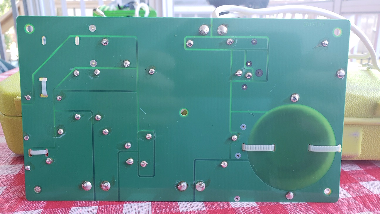

Hi kawihornet,
thanks for the uploaded photograph and if you'd be willing to do the same for the copper side of the board, that would be awesome for we would be able to analyze the circuit precisely. Traditionally Dynaudio has been considered to be a transparent sounding product and some would think over transparent. Fashion is a terrible thing and hard to fight against and as things are in audiophile circuits, caps take the blame for practically everything. I have built myself 2 sets of Dynaudio speakers, a 3 way tower (9.5" woofer, 2" mid dome, 1.1" tweeter) and a 2 way bookshelf (6.5" midwoofer and a 1.1" tweeter). All other things being equal, 3 way is undeniably and considerably better performing loudspeaker and I attribute this to the midrange unit.
For the issues you describe, I agree with Scottmoose's assessment, and would recommend a re-design for the crossover.

Assuming it's following the usual Dynaudio pattern it'll be a 1st order acoustic; likely 1st order electrical with a delay on the tweeter & whatever will give the desired slope for the midbass.

Hi kawihornet,
What type of resistors would you recommend?
