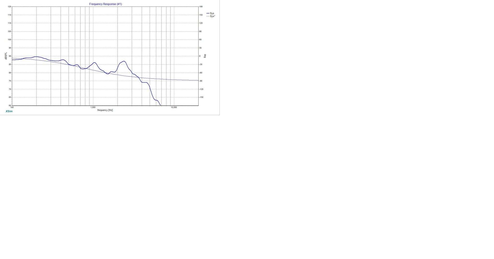

Here's the raw supplied FR for the woofer,made using fptrace, with the 1.6mH inductor added: there's a nasty peak between 2 and 3,000 Hz which needs to be dealt with as it will likely interfere with the sound from the mid. Impedance (ZMA) graph is not available.
I should have added to my post on the tweeter FR that I had the 12 microfarad cap added.
I can't find a FR graph for the mid.
Geoff

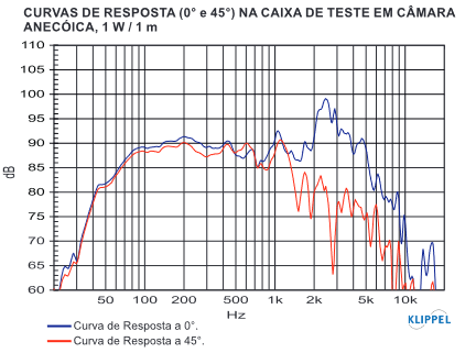

I had already seen this peak in some simulators on my computer, it is quite unpleasant, but every woofer that I get here in my country and put in the simulator always has a peak, at least all the ones with cloth edges, those with rubber edges generally they are very flat
I even thought about JBL's MG-600 10-inch woofer, but that peak persists
And that's exactly why crossover calculators don't and can't work and why a crossover should be custom designed for your drivers and cabinet.
Geoff
