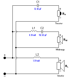

Is that all of the parts in your crossover: that's four parts for a three way crossover?Tweeter capacitor = 12.42uf
Midrange capacitor and inductor = 112.03uf and 0.18mH
Woofer inductor = 1.6mH
How did you come up with those parts and values, please: people may be able to give you some advice on whether that might/might not work and why. Also, what mid-range are you using; your post says "4 inch".
The tweeter has been widely used in two and three way speakers and I've never seen it with less than three parts: check out Paul Carmody's "Tarkus" (3 way) and "Amiga" (2 way) and Paul Graves' "Supernova Minimus" 2 ways on the Parts Express Project Gallery.
Please remember, people are trying to help and trying to get a good result for you.
Geoff
This is sounding ominously like 1st order electrical values taken from xyz calculator assuming static resistive loads & no account for FR, impedance variation etc.

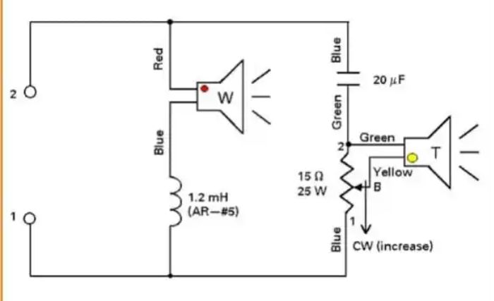

Just as a reference, the then revolutionary AR2 acoustic suspension bookshelf cabinet crossover.
Admittedly a 2 way cabinet (instead of 3 way here) but only two components: 1 capacitor for the tweeter, 1 inductor for the woofer..

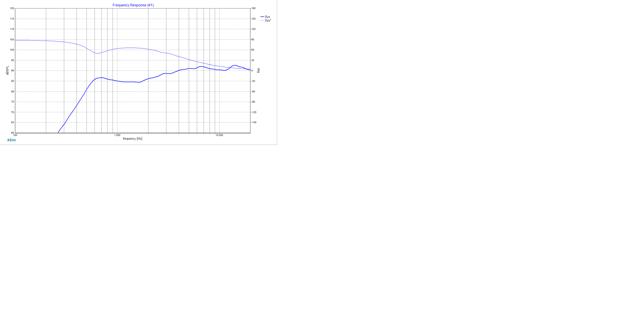

The OP's proposed crossover will produce noise, no doubt about that, but I think it would at least need some padding on the tweeter, which could of course be added later after tweaking. Here's what the tweeter FR looks like without any padding or contouring treatment:

Below is Pedroga's crossover schematic. I don't know why he didn't attach it!
They were produced by the calculator below because, in his previous thread, the T/S parameters of his drivers were unknown.

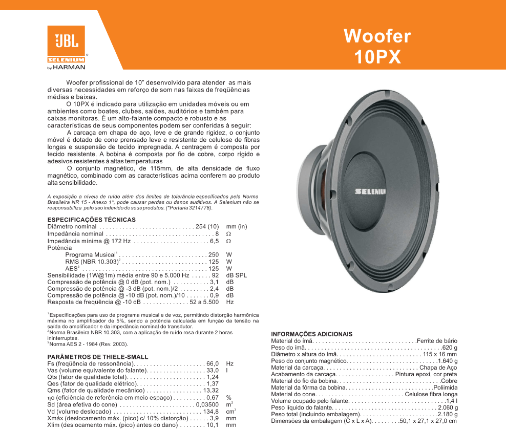

As a woofer I'm using the JBL 10px whose manual with all the parameters I'm making available in PDF by clicking right here

A quick search gives me nothing that I would use to build a crossover for those drivers except for padding the tweeter. BUT
Pedroga is very much a beginner when it comes to crossovers, but he is an eager student!
The crossover derived from the calculator was not intended to be an ultimate solution, but was one of the tools for educating him in the very basic requirements of a loudspeaker crossover, i.e., high pass, band pass and low pass filters and suitable choice of crossover frequencies.

Now first off those details tells me this isn't a woofer at all but a professional midrange and at a guess quite like the Eminence Alpha. The drivers Fs is far too high for a woofer
