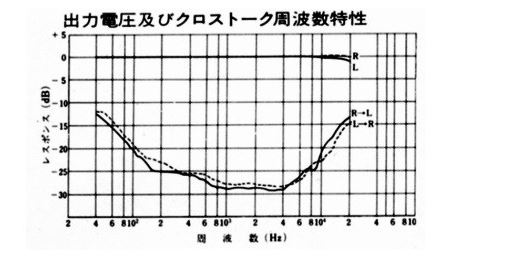

Another data point. This is from the spec sheet of the Denon DL-107, a cartridge that intrigued me enough to pick one up to add to the pile to try out. Now this is state of the art 1969 and there is no details on how they measured the cross talk, but at least a diagram rather than a couple of points.
Between 150Hz and 8kHz it's probably as good as it gets for a conical. outside those limits there is something the inveterate fiddler might want to consider adjusting.
Thanks, Bill.Another data point. This is from the spec sheet of the Denon DL-107, a cartridge that intrigued me enough to pick one up to add to the pile to try out. Now this is state of the art 1969 and there is no details on how they measured the cross talk, but at least a diagram rather than a couple of points.
Interesting that the shape of the crosstalk curve versus f follows the general trackability performance versus f curve, don't you think? Well, the inverse curve you know what I mean.
LD
Now you mention it, it does. That might explain why Thomas is getting such good numbers off his cartridge.
Hmm. I suppose crosstalk test records would generally be recorded at a strong level so as to make measuring the unmodulated channel possible back in the days before fft made it a doddle?
However, that might predetermine that traceability is typically the limiting factor in such tests. Which would also be true in programme material, but only at high levels.
Then crosstalk performance would be level sensitive at any given f. Well, above a certain floor set by azimuth/geometry.
Edit: real programme material crosstalk performance might far exceed such measured performance, especially for low levels.

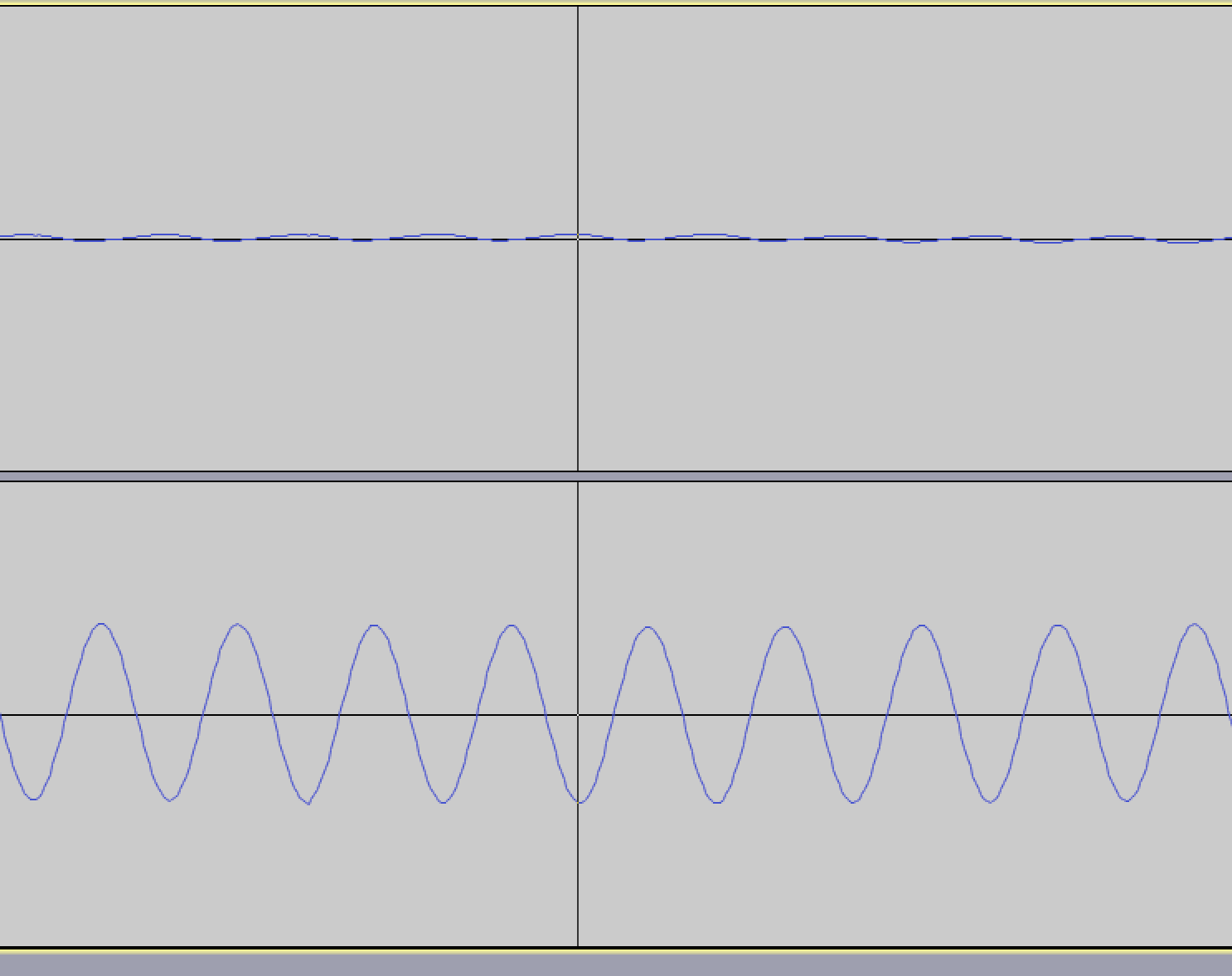

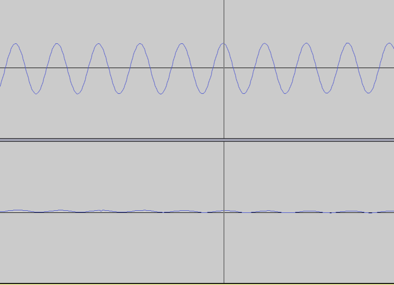

Been doing some work today, levelling the turntable more precisely and did some adjustment of the SAS stylus damper so now it is fully functional. I raised the VTF to 1.4 g and use the damper on from now on.
Recorded the Elipson test record and the signals appear to be rather good quality. However, the record suffers from rather much pops/clicks. I cannot understand why my test records suffer more from pops/clicks than the music LPs.
Yet to fix: fine-tune azimuth, fine adjust speed and fix a grounding issue in my RIAA stage. The 1 kHz left-right test on the Elipson record shows that L->R crosstalk is in phase, while the R->L is out of phase. Now, someone can give some clues if I need to adjust the cartridge clockwise or counter-clockwise? I have forgotten which way it is based on the phase figures.
After this I will do some more extensive recording and comparisons of the test records with respect to crosstalk.
