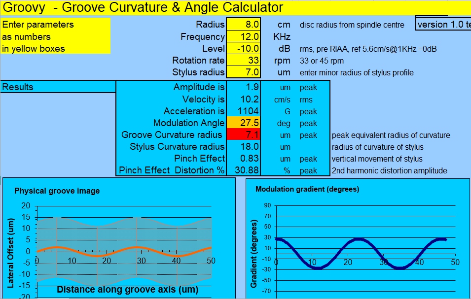

Not strictly crosstalk, but here's some figures and shapes for a physical groove for a mono sine tone if the level were -10dB - this plot is for 12kHz.
It's pretty hot, and a lot of rigs prob wouldn't trace it accurately. But also see how pinch effect is significant, though this example is for an 18um spherical, and that's unavoidable.
The software is a spreadsheet of mine 'groovy'.

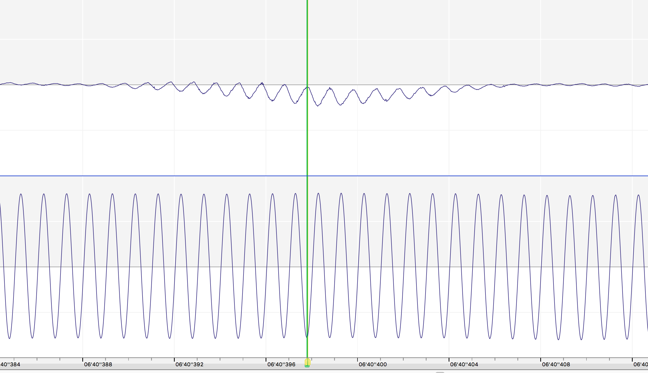

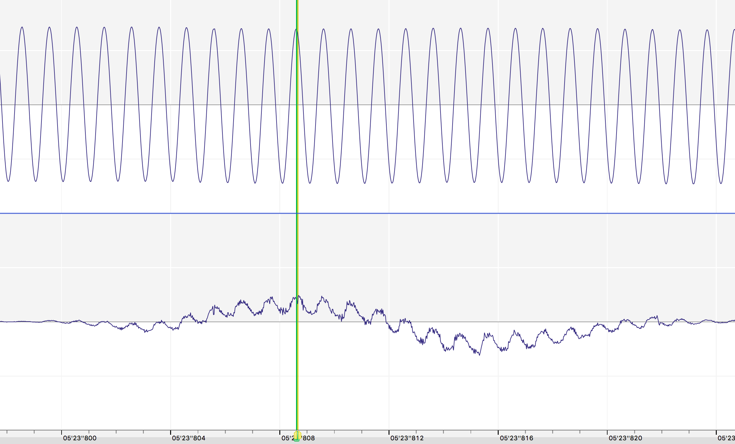

It is interesting and I'll be back and try to measure a bit more when I get the test record. While the L->R crosstalk is lower than the R->L, I think one is in phase with the main signal, while the others is out-of-phase. You can however only theoretically get a precise "null" if both the groove walls are precisely in 45° and consistently so over the record and the generator is perfectly mounted +/- 45°. This is probably very difficult to achieve.
Thanks ThomasA. but I double checked and definitely obtain antiphase for both R>L and L>R. See attached plot. I used Ortofon test record.wav from your post. I tried different parts of the same test recording, but same result.It is interesting and I'll be back and try to measure a bit more when I get the test record. While the L->R crosstalk is lower than the R->L, I think one is in phase with the main signal, while the others is out-of-phase. You can however only theoretically get a precise "null" if both the groove walls are precisely in 45° and consistently so over the record and the generator is perfectly mounted +/- 45°. This is probably very difficult to achieve.
You can see timestamps in this plot. But the level of test signals can't be compared in my plot, because gain isn't calibrated - I was only interested in phase.
I did double check, and I can't see an error?
LD
LD
Yes you are correct, at least for the first 1 kHz test L-R. The second pair 1 kHz measures a bit different though in my software. I am not sure why, it is further in on the record and may be differences in pressing or that the record is not perfectly flat that may cause these differences.
At least I have some small possible adjustment to make to equalise the crosstalk, but it is pain of work with a unipivot arm. I need first to ensure that my table is perfectly level which it is not at the moment.
Yes, and I was just now also able to reproduce your result by using the exact time stamps as you used. How very strange!Yes you are correct, at least for the first 1 kHz test L-R. The second pair 1 kHz measures a bit different though in my software. I am not sure why, it is further in on the record and may be differences in pressing or that the record is not perfectly flat that may cause these differences.
There are parts of the 2nd pair of test tones in the recording where crosstalk phase appears in quadrature too...………..
I don't understand. On the face of it the two pairs of tone bursts appear identical for the test, and I don't see another stimulus that could do this.
Sleep on it, yoda shall.
LD

Yes. A closer look at the Ortofon Test record recording shows that the first pair of 1kHz crosstalk test tones behave coherently: they each remain in antiphase to the source for both L>R and R>L parts throughout the whole test.
The second pair of 1kHz crosstalk tests show that the R>L part is coherent and remains in antiphase throughout the test. But the L>R part slowly and apparently randomly slips phase in the Right crosstalk channel throughout the whole test. That is to say, it passes through all phase relationships with the source (L) channel.
We think we only have 0 and 180 deg as available phase components of crosstalk, but it's impossible to create the observed phase slip from just combining those phases. Then there's either another phase source, or something is up with the recording, I think.
Continuously slipping phase physically means change of frequency: which is impossible to just happen to crosstalk but not the source, I think?
The first pair of 1kHz test tone recordings behave coherently, the second pair don't ! Well, one channel doesn't, only for the 2nd test.
Perhaps it points to the recording being somehow faulty, but that seems unlikely too and I think it's probably an unexplained loose end that should be explored because they often lead somewhere interesting!
