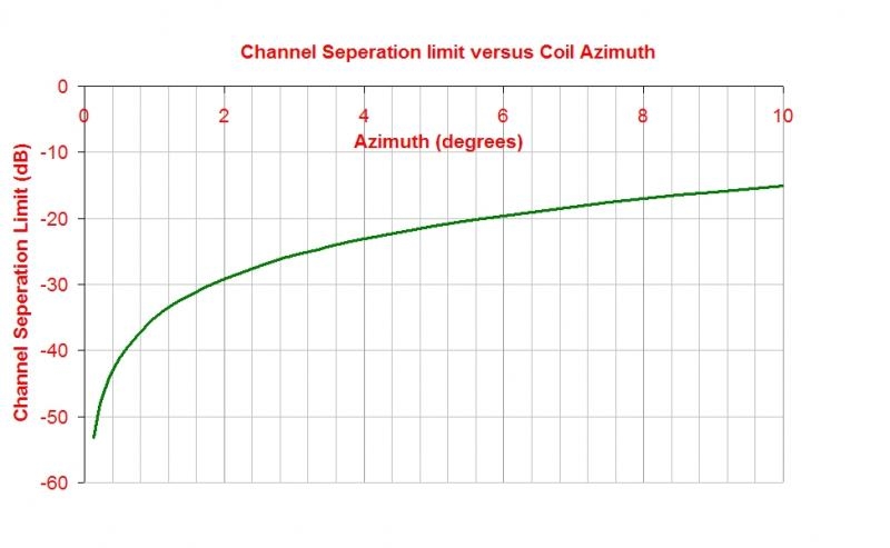

Meantime, here's a plot from my archives that shows calculated theoretical achievable crosstalk/separation versus error in coil azimuth. You can see how sensitive the adjustment is at the sweet spot!
Crosstalk due to geometric misalignment of coil azimuth should not vary with frequency, of course. It would be interesting to observe real measurement though, because one might predict that tracing error indirectly would be a cause of crosstalk, as stylus deviates from locus of the groovebase. This might well depend on level (angle) and frequency (curvature) of tracing a sine wave, one might think, and so vary with frequency? In which case it would also vary with level of a sine f sweep, and be modified by RIAA too?

Moving on, I should explain more about why I dived down this particular rabbit hole. As part of the ongoing mission creep on my new phono stage I am thinking about putting a M-S processing section in as it gives me a couple of extra options for when I record files. The board I was looking at for this has a stereo width control that works by adjusting the level of side compared to mid and also has a simple tilt eq on side which apparantly can help lock in the stereo image on less than ideal recordings.
So I got all exited that I might be able to kill two birds with one stone. Until Thomas pointed out the flaw in my argument. However I still think there is worthy investigation here over the sources of cross talk and what (if anything) can be done to correct it.
I have a feeling that the cantilever flying around in the groove will produce as much cross talk as any misalignment, but as usual happy to be proved completely wrong 🙂
I think that is true for real programme material esp.However I still think there is worthy investigation here over the sources of cross talk and what (if anything) can be done to correct it.
Yes, that's my instinct too.I have a feeling that the cantilever flying around in the groove will produce as much cross talk as any misalignment, but as usual happy to be proved completely wrong 🙂

When one thinks about it, for a sine test signal on one channel only, one groove wall is entirely plain, and the locus of the groove base has a 3D shape moving laterally and vertically so that effectively the stylus rides up and down the plain wall (as considered from the groove top) if all is tracing perfectly.
Which is a close relation to mistracing motion, where a stylus loses contact with one groove wall, and therefore (by definition) rides up the other wall.
Perhaps then, crosstalk performance might also be a figure of merit for tracing performance - or at least they might be correlated ?
Picture worth 1000 words and all that.
Edit: or consider pinch effect which moves a stylus vertically, and vertical motion involves components of both left and right channels?
