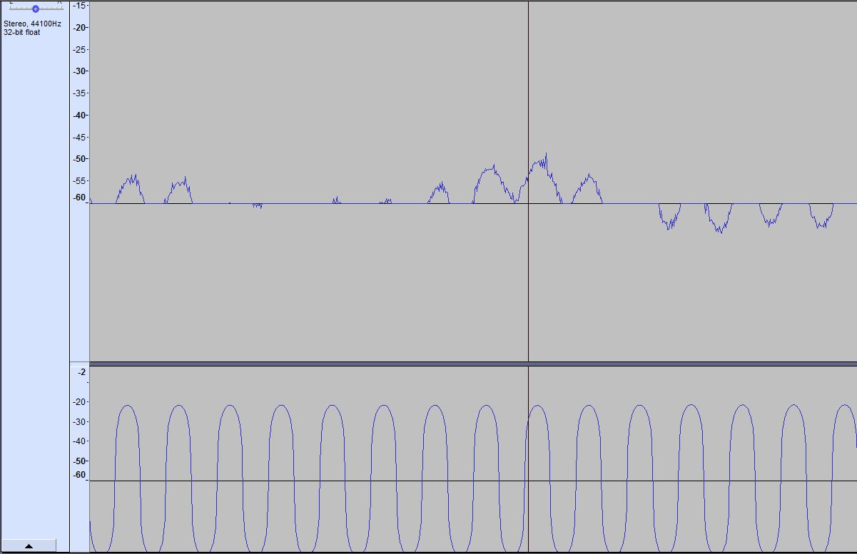

Well so far stumped with analysing that file you uploaded Thomas. The cross talk is so low at some frequencies that is is swamped by record eccentricity and other issues. I am severely impressed though with the performance of that cartridge.

Thank you. Attached is one of the examples of where audacity gives a confusing result. I haven't tried high pass filtering the file to see if that helps yet, so just need to find time to hunt for samples where there is a clear peak. I only need 3 or for data points to get a view. Then I can try and measure a less good cartridge 🙂.

I hadn't considered the self centering of the diamond, but that does make sense.

Thanks for that. I’ve seen that effect which could have two possible explanations both originating from the unpivot tonearm.
1 my player is not level at the moment. Thus any up and down-movement of the tonearm will change azimuth dynamically.
2 it may be the inherent unstability of the unipivot reacting on non- centered records. Stability was significanly improved using a 600 000 cst oil also revommended by Moerch.
