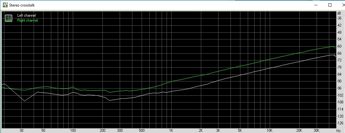

When measuring crosstalk of a "typical" preamp then you see something like on the attached graph.
Most probably a similar phenomenon takes place in the cartridge body where mechanical movement of the cantilever is converted to output voltage. And judging from the quite different values given for different cartridges the crosstalk incurring during that conversion may be of significantly different level (or character).
I wonder how different results (also frequency-domain wise) the voltage generators of different cartridges can produce ...
