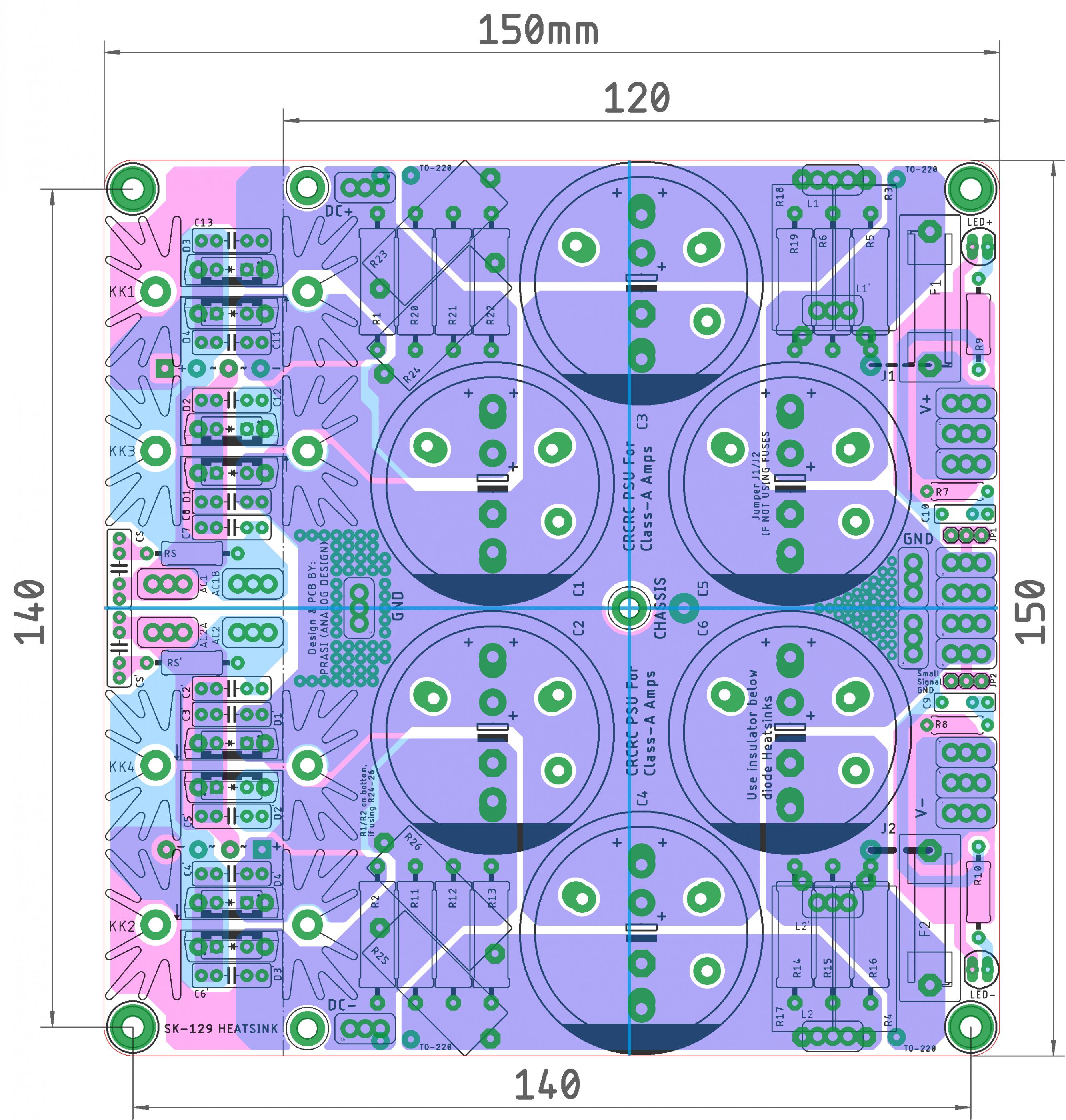

Isn't the Resistor-2xdiode-cap usually used as a GLB between PSU/signal gnd and chassis (safety earth)?
Yes, but added impedance (even 1R is better than a solid trace) can't hurt in this case if you want to isolate the main AC currents from the low level signal ground.
The diodes are needed anytime a resistor that may go open like fuse, to provide a safety return path.
The suggestion for ground trace mod is a known best practice and suitable for an universal PSU that will cover for situation including where you can not install a small isolation resistor. You can also have multiple ground return types with different return currents and it provides more flexibility.

So been adding few more options
1. TO-220 resistors for the R's of CRCRC https://www.mouser.in/datasheet/2/62/MP800_Series-2189.pdf
2. vishay PB RECTIFIERS http://www.vishay.com/docs/84807/pb3506.pdf

And pin compatible with this enhanced bridge too?
Ideal bridge rectifier GB

What form of heatsinking would be required for the PB Rectifiers?
Will any be available on the board?

Hello Fab,
Yes one my friends asked that too, but the pin spacing ideal rectifier is 5.33 mm. So I can either accommodate either ideal rectifier or the Vishay PB.
I will go with the popular demand and make changes to accommodate ideal bridge rectifier by tvicol.
To stryker, For the PB rectifier, it would have been using your own piece of heatsink cut from a larger sink or finding some thing suitable on mouser.
But now lets use the tvicol ideal bridge rectifier that has become popular.

Also the board can now take up tvicol ideal bridge rectifier.😀, as per popular demand.
