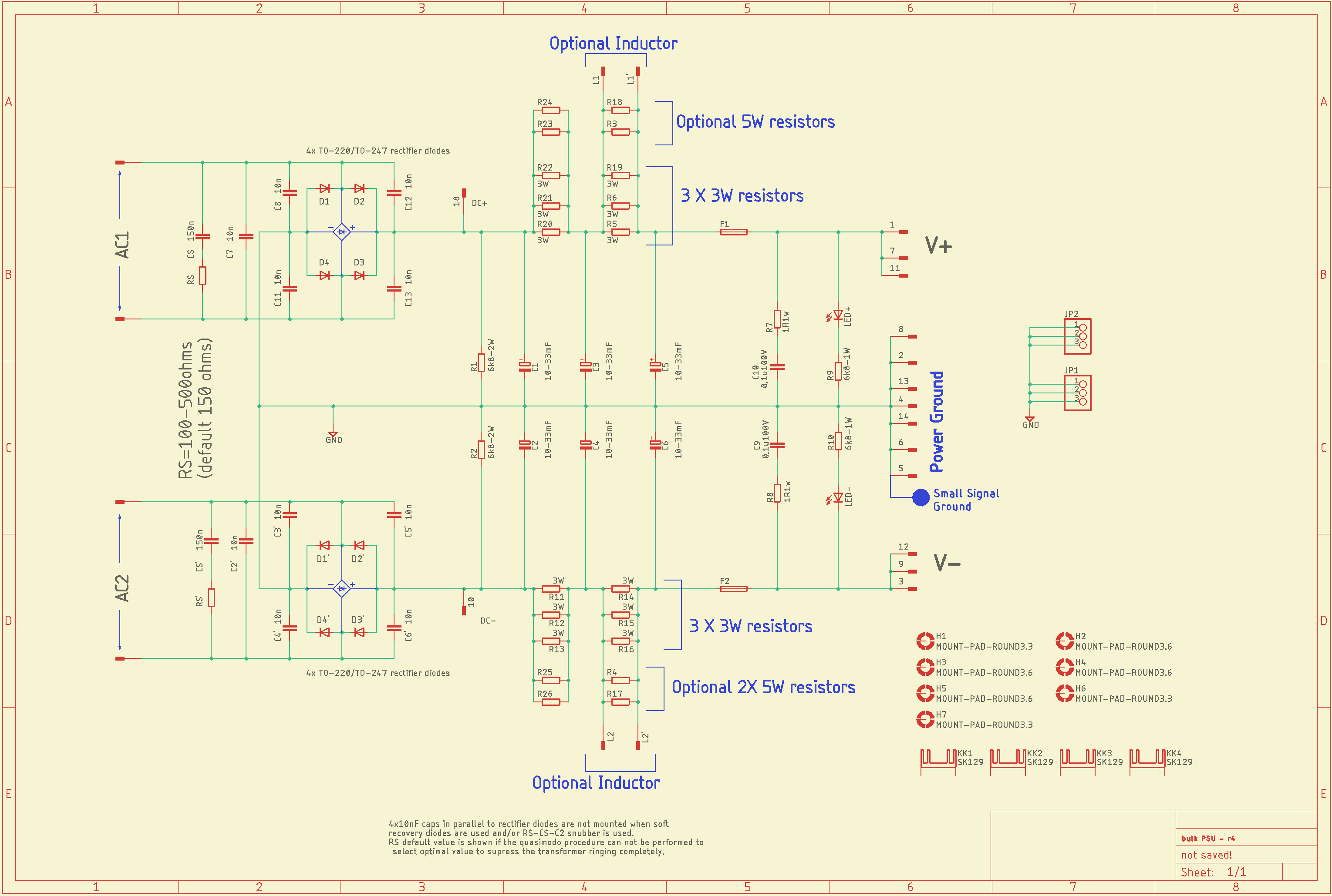

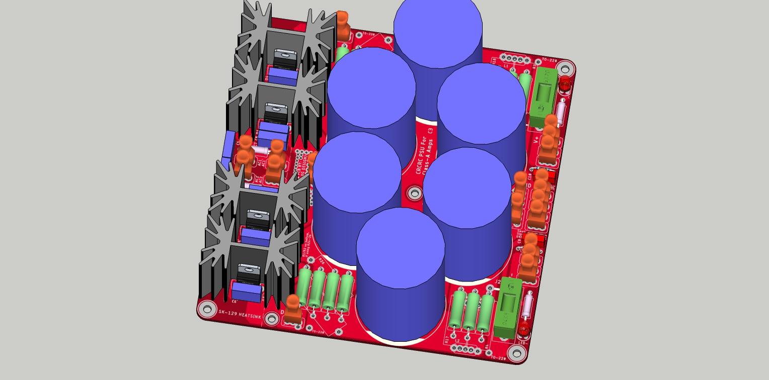

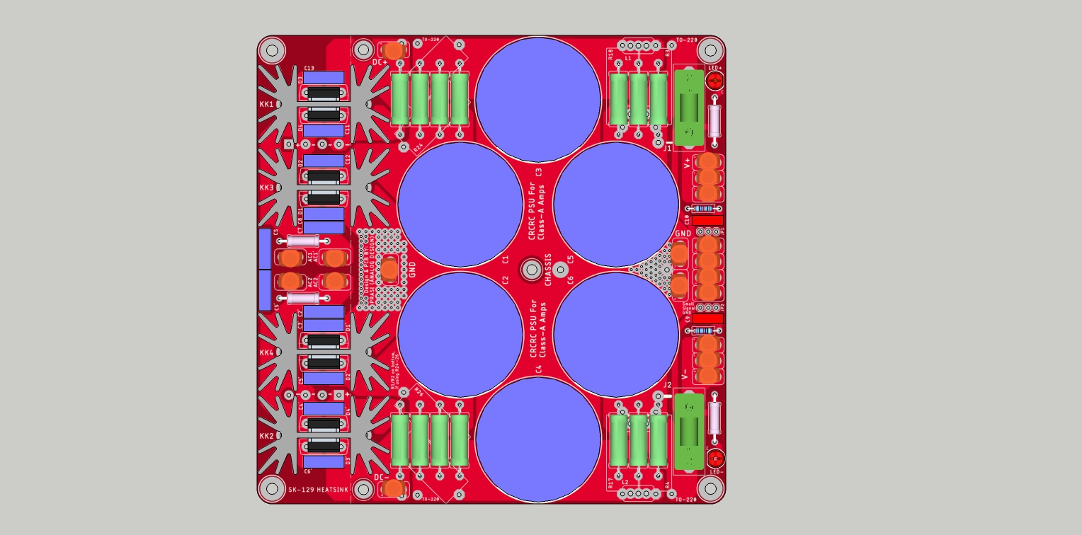

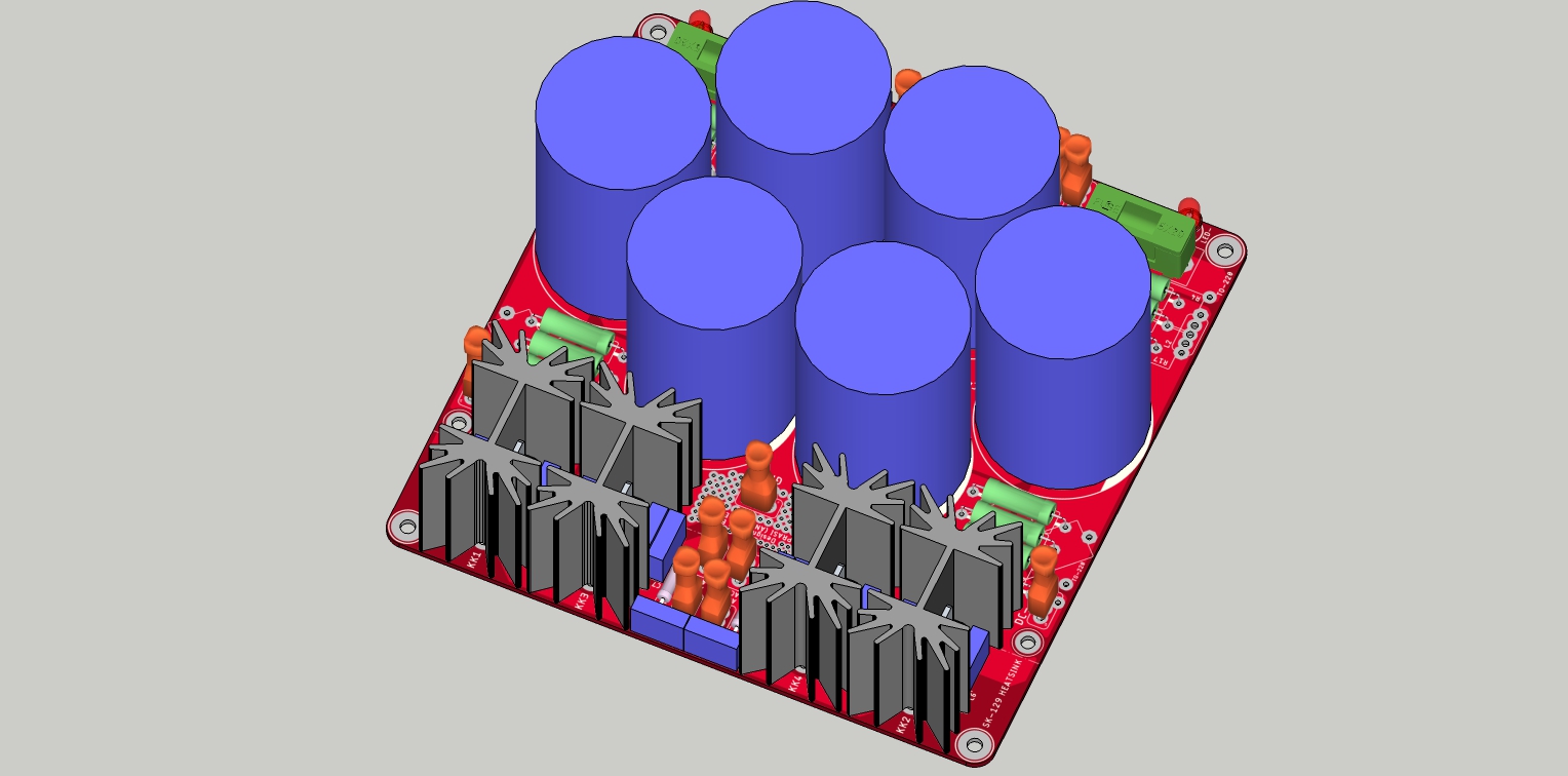

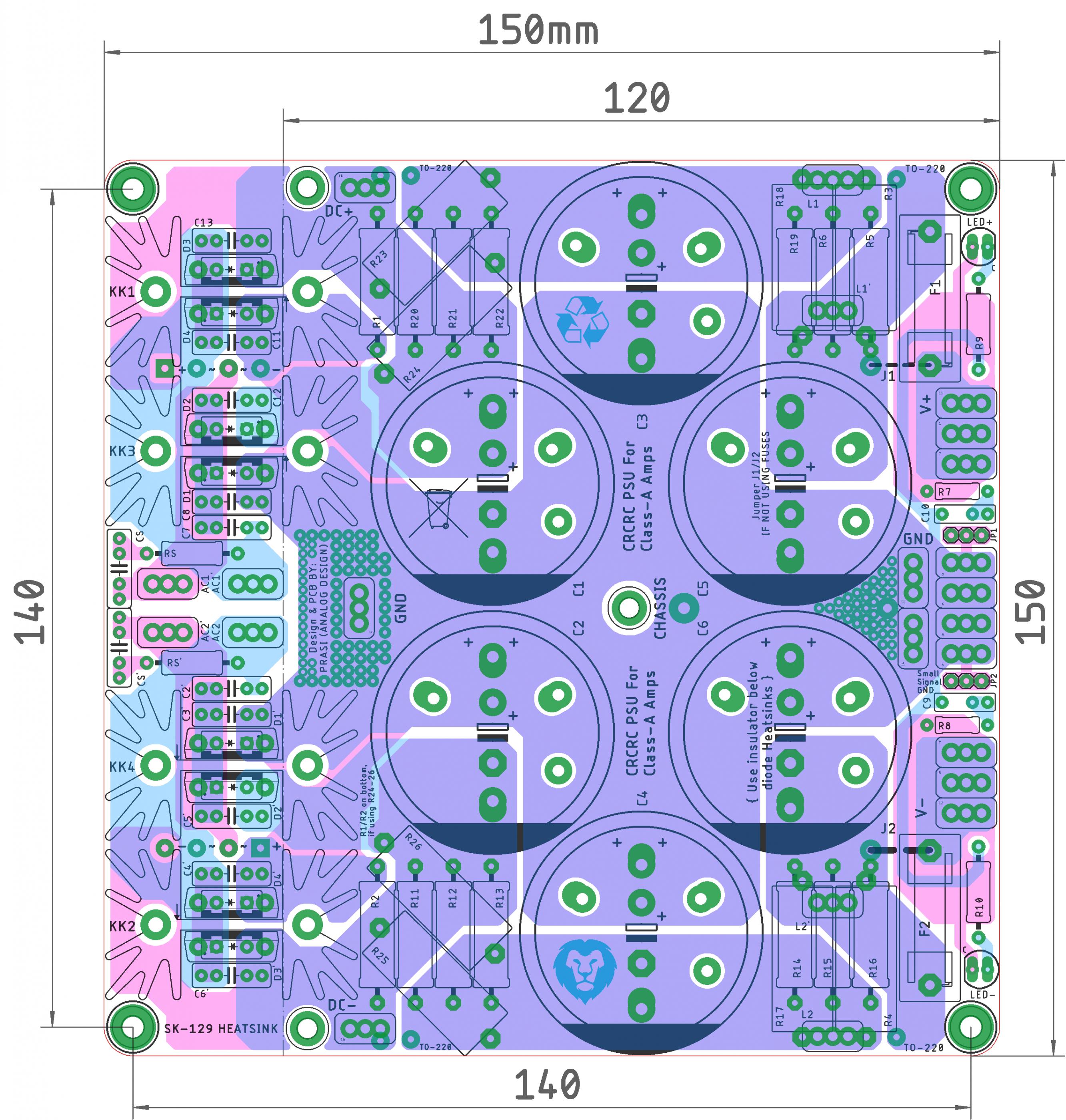

Hello All,
I think I am now ready to manufacture.
Here are the documentations.
Also attached is the 3-D models and tentative BoM.
Please go through , if anyone spots any error, please let me know and i will incorporate the changes.
ALso as an option, it was suggested by P16 to open a separate thread , because it will make me easier to edit first page and upload latest document and info. I am ok with either.
regards
Prasi

Hello Prasi,
Fabulous work!
I would agree with P16, starting a dedicated thread for this psu would help keep all info and questions easier to manage.
Fabulous work!
YES, This time it is perfectly symmetrical! 😀
Bravo Prasi, it's a fabulous job, very professional.

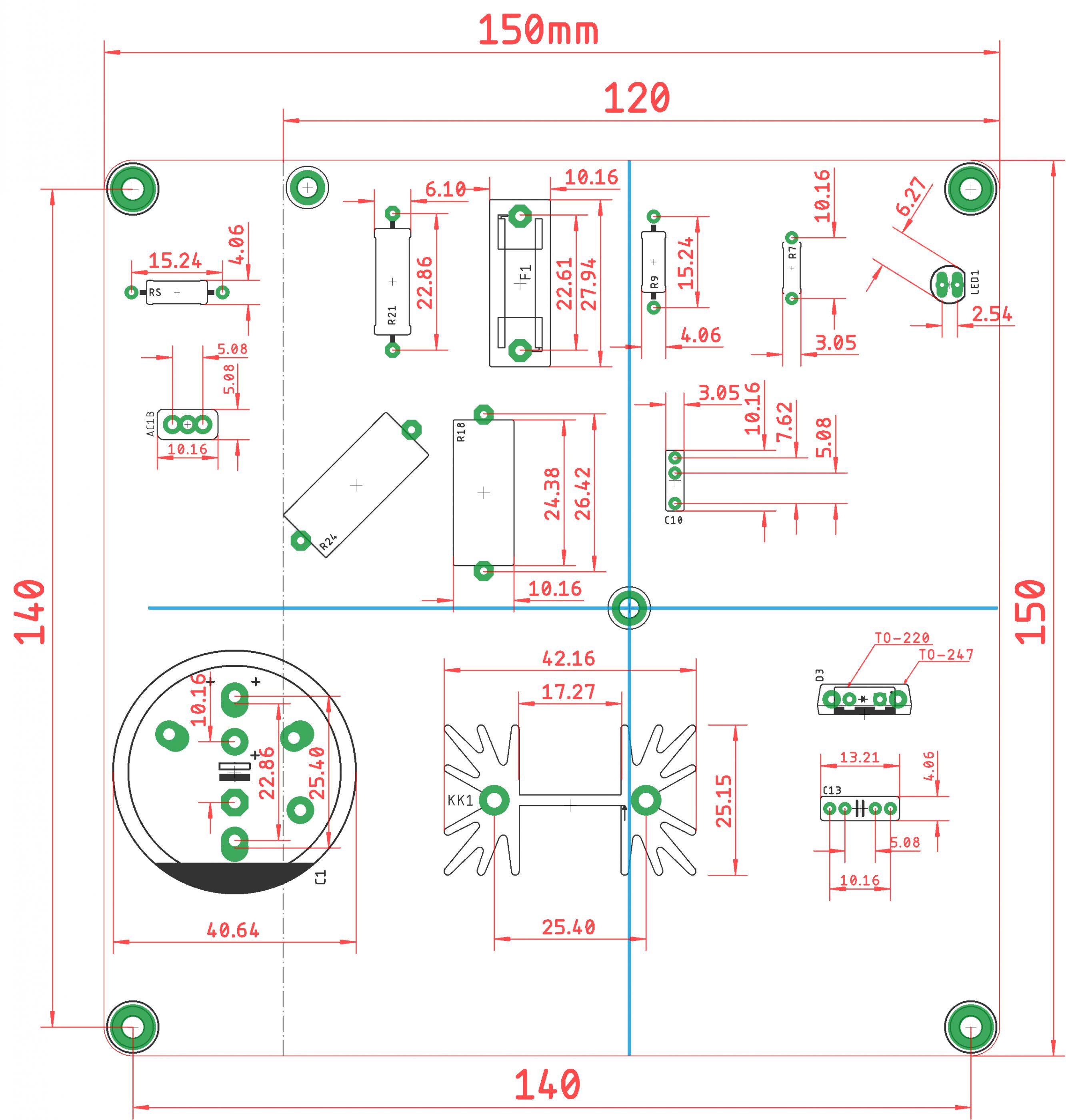

Hi Prasi, 😀something like this?
Caps 40mm.
One can cut it at 147mm and use a separate external bridge and supply the o/p of the bridge to caps.
fuse optional.
I like this version, you could place more info about this plate, greetings

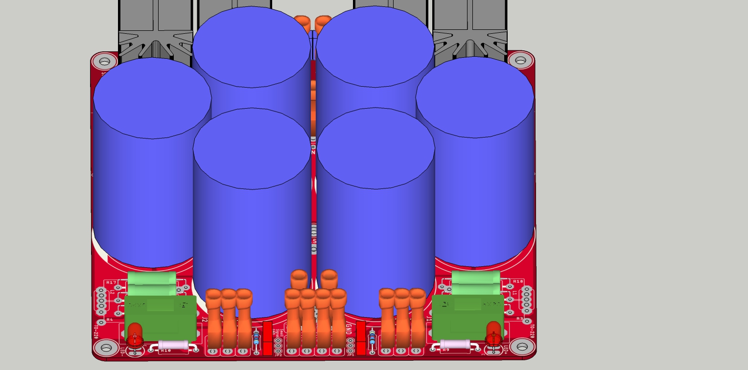

Hello.
I’m upgrading this PCB from 2-pin capacitors to 5-pin snap capacitors.
Second + and - pin’ pads are not connected on that board.
What is a reason for that?
Pin’s contact area with pad looks quite small for hight current, even soldered.
Should I connect second + and - pads to first ones?
The board is designed for 2 pin 10mm spacing
4 pin -22.5mm spacing
5 pin - 25mm spacing.
So everything is OK. contact area is ok, you will not have problems.
