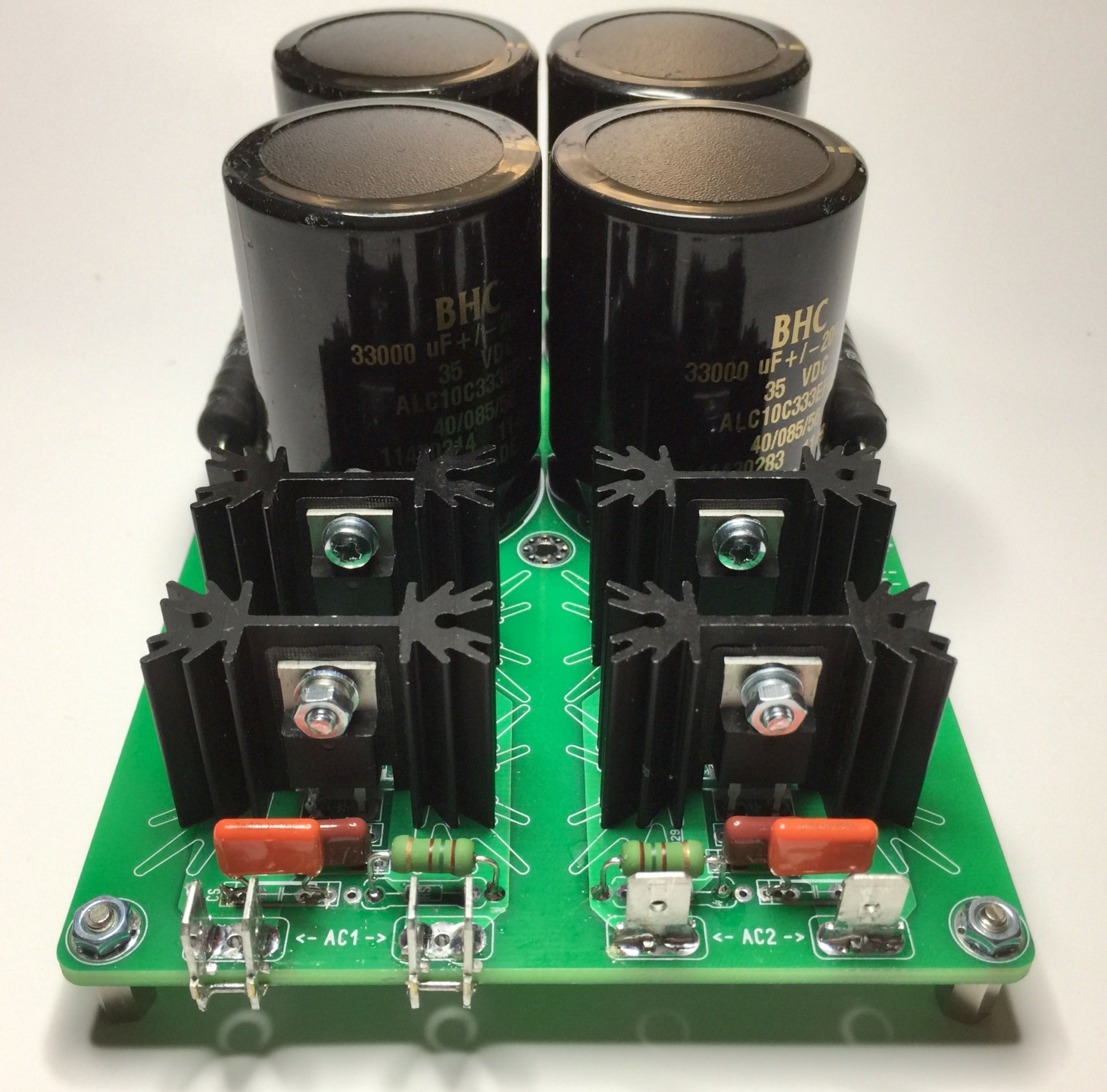

I've made many PS's and always used SIL's and nylon shouldered spacer/washer on the diodes, without any issues, ever!
Do use a flat washer on each side of the shouldered spacer, and a lock washer and plain nut - I attach a shot to explain more - Photos tell the story more than any words. I would use metal screw, nut and washers because nylon may not be able to squeeze the assembly enough when tightened.

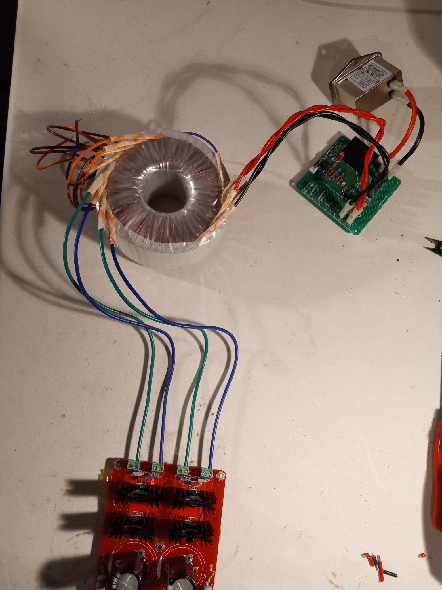

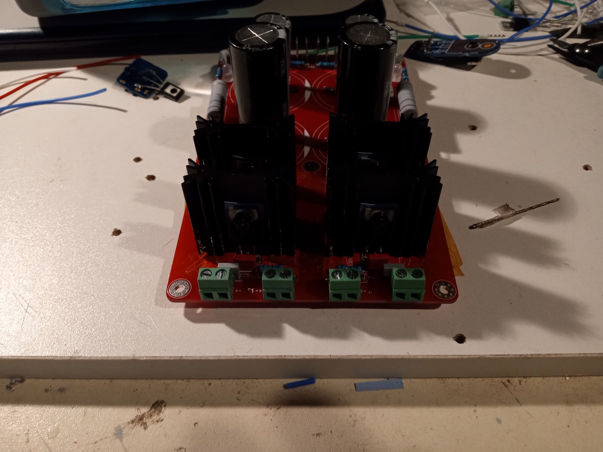

Hi Folks, a quick question if I may,
I have soldered 4 x 2 post terminal blocks for AC1 and AC2, rather than spades. I am using 1 transformer with dual secondaries and 1 psu for one channel.
My question is: Can I insert a single secondary wire into one side of a 2 post terminal block and expect the psu to function properly, or do I have to desolder and change to spades. Thanks for the help.

If I understand you correctly, you have 1 connector per primary-wire (with connection for two wires)? Then yes, no problem.
Post a pic to verify, pls…

Prasi and other builders,
Please see attached pic with iec inlet, soft start, transformer, and the psu. Primaries wired in parallel for 115V. Secondaries wired as shown. AC1 has a blue/ green with confirmed continuity. AC2 has blue /green with confirmed continuity.
Should be good to continue with wiring, Correct ?
