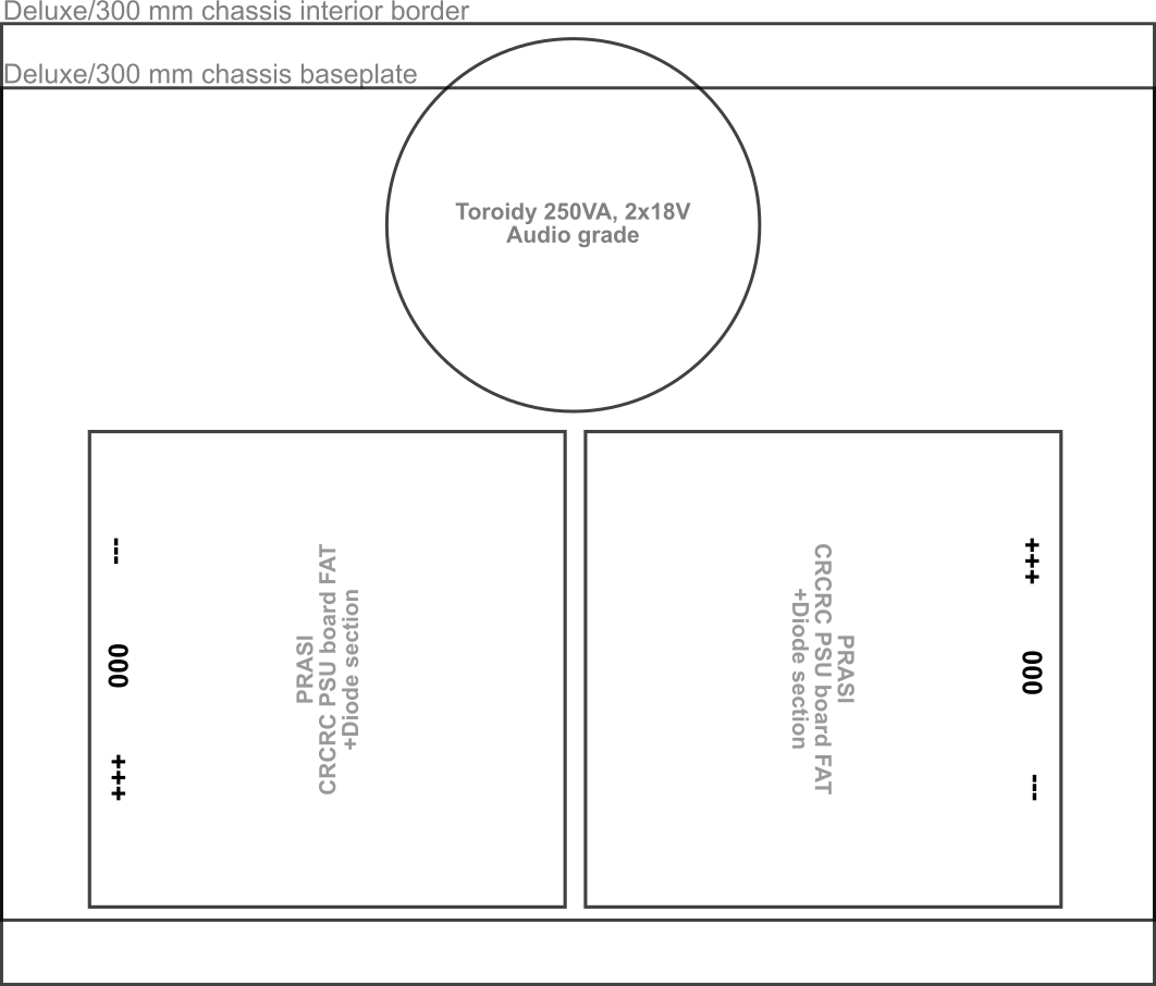

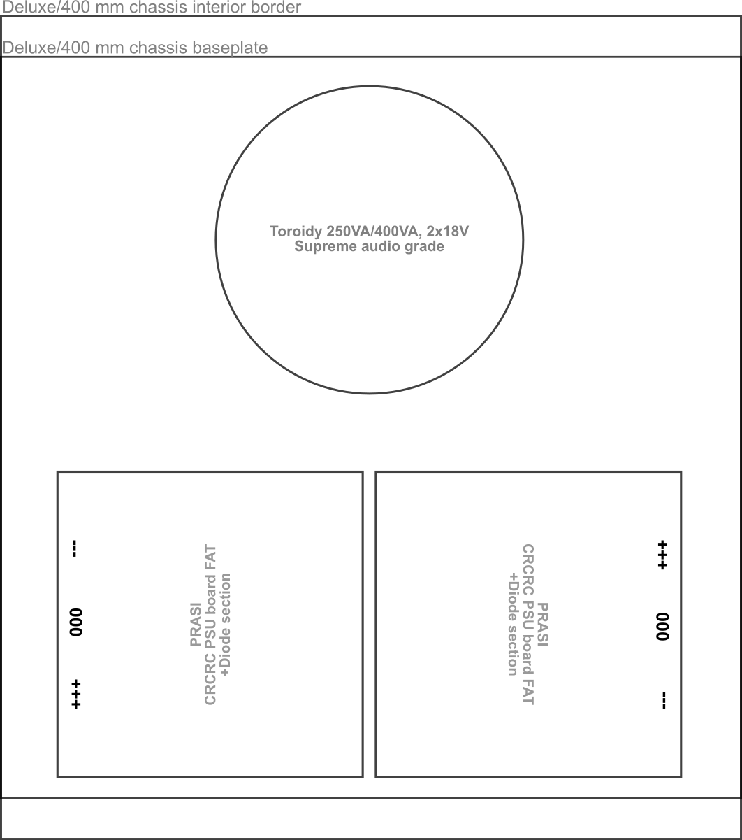

I like it, but it'll be hard to fit into a 4U/300 case at 20 cm long (bearing in mind the baseplate is 26 cm). For 400mm Deep chassis you can fit two and do dual mono, so looks pretty good for that purpose.

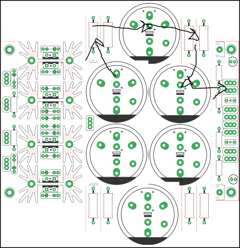

Would it be possible to make it fat and wide, a bit like this?

Prasi, that is excellent! With that you can even build a dual mono setup in the 4U/300 chassis using a pair of stacked toroidy transformers (e.g.) - see illustration.
EDIT: Ok to be really annoying, how about a version without the diode section :D

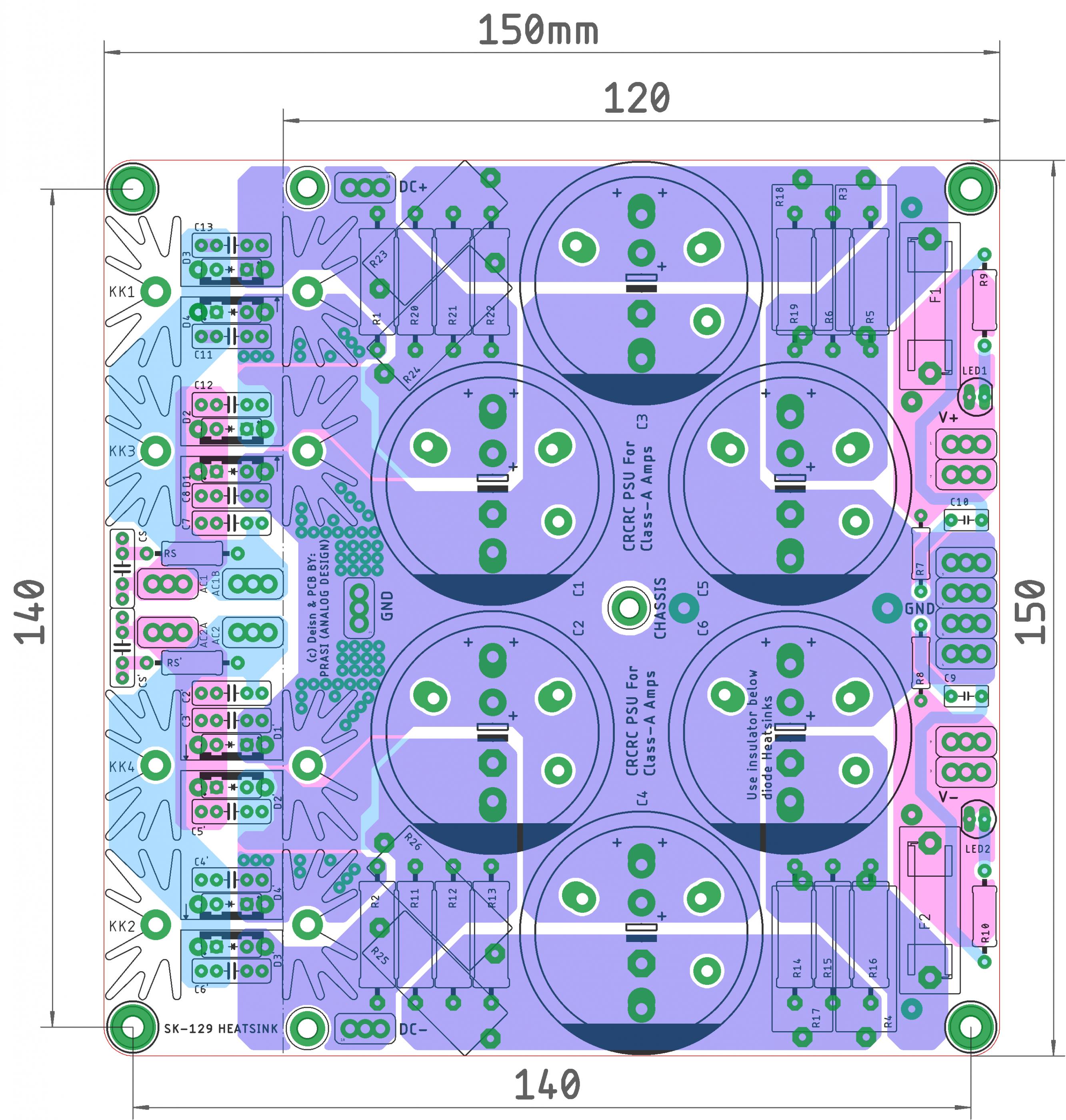

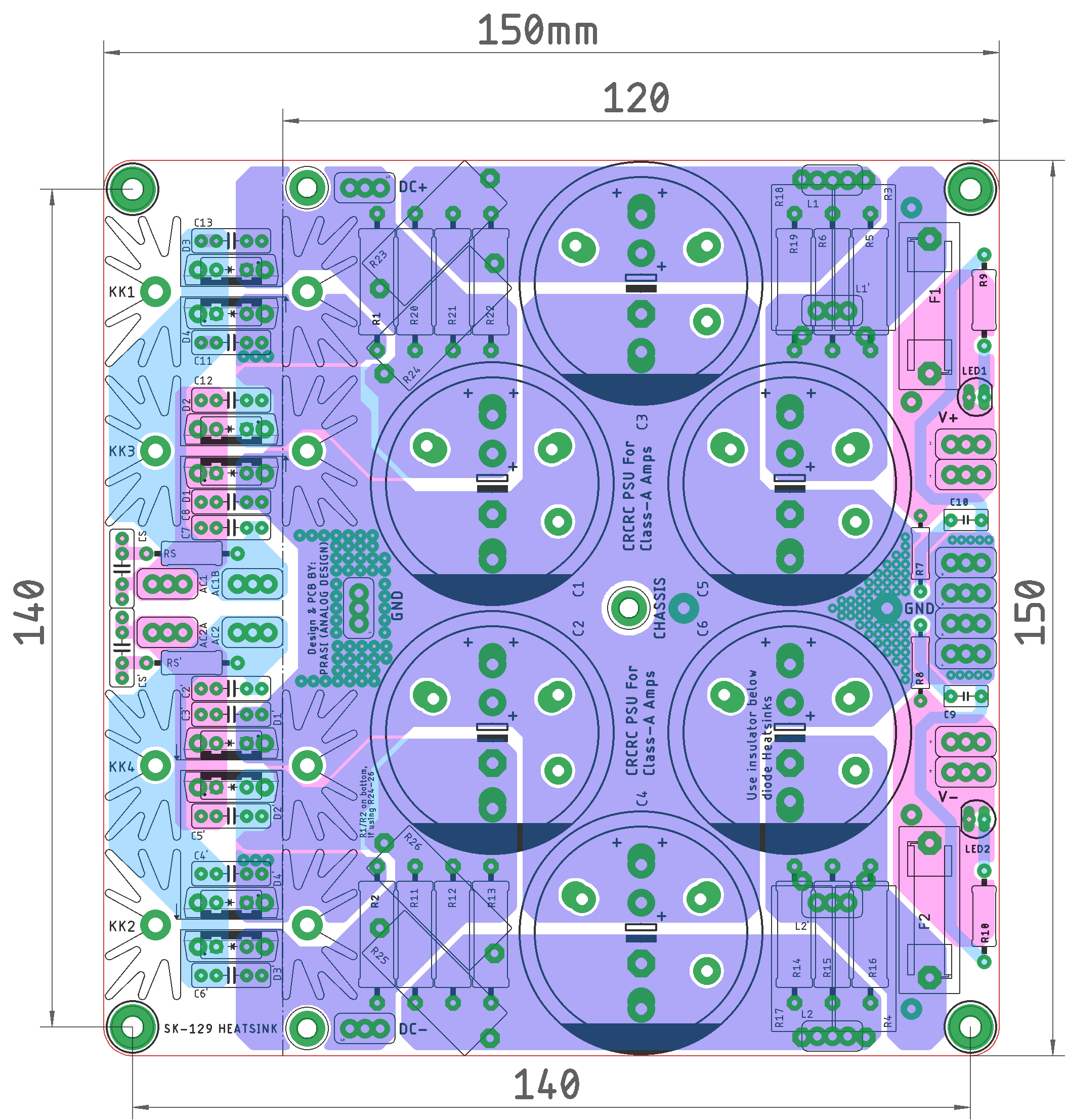

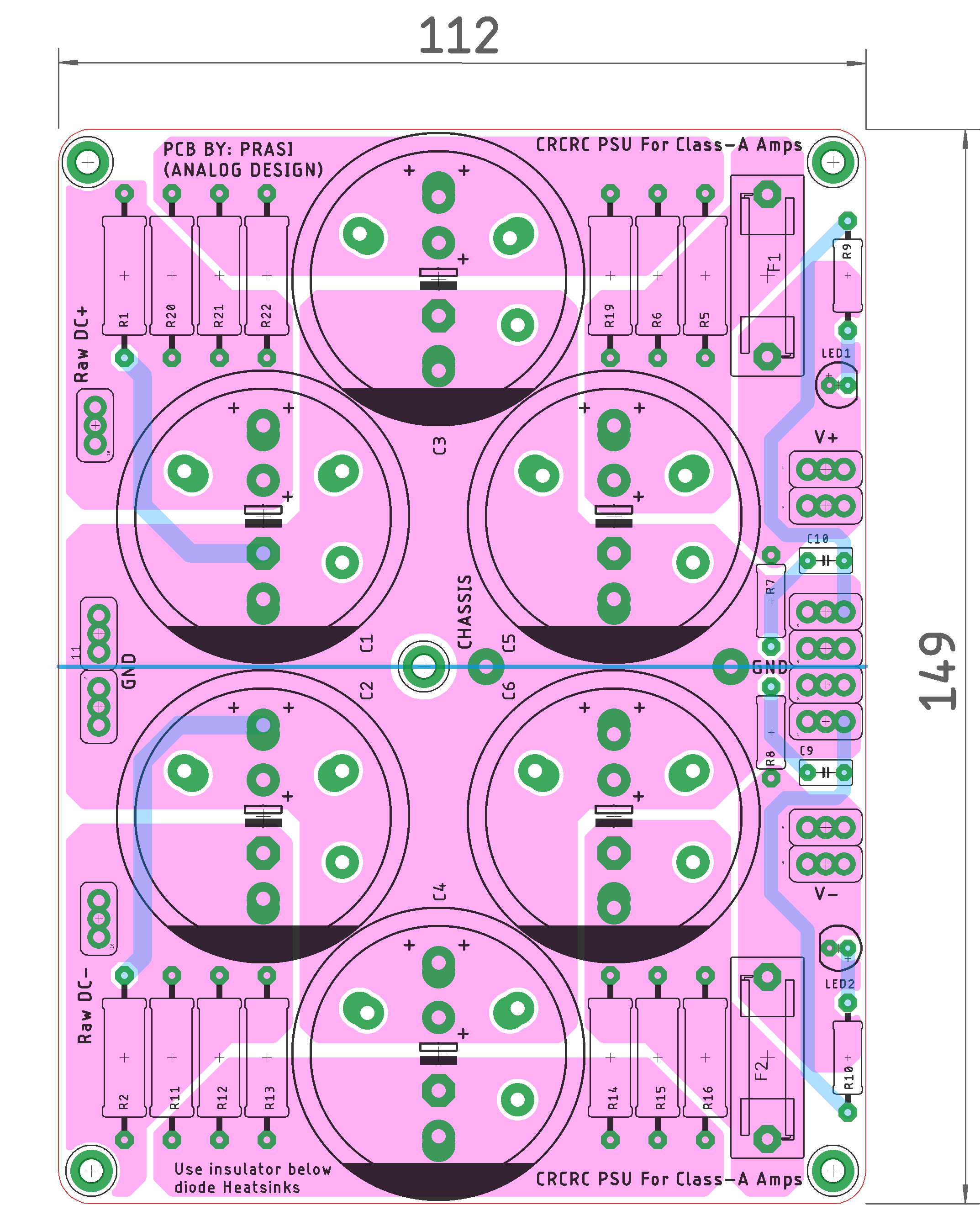

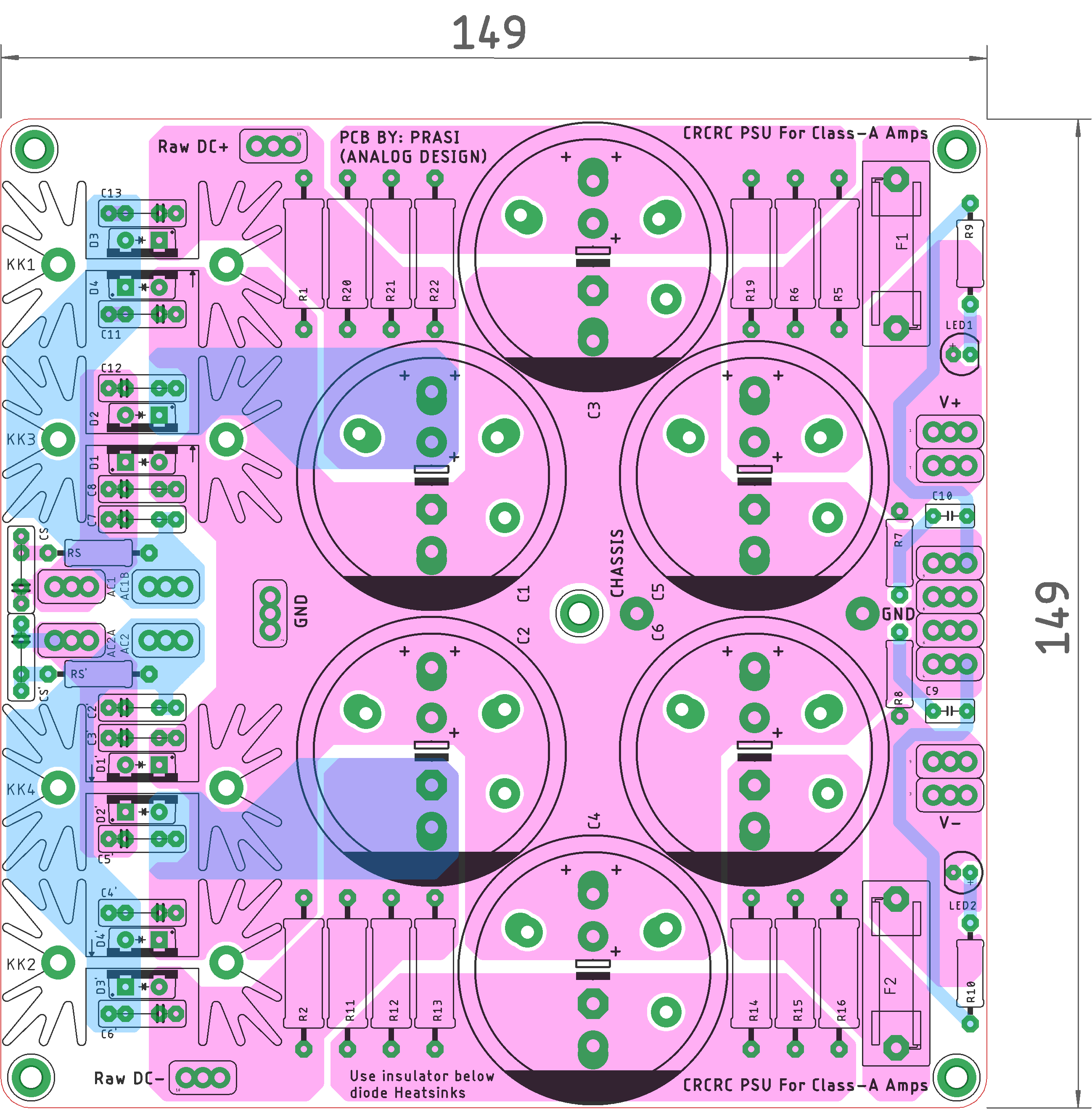

OK , here is the refined version.
If anyone is intereted, pl state your requirements now.
if requirements go above 50 , i will produce pcbs and supply. pcb is 150mm x 150mm.
same specs; 2.4mm thick, 70um cu, green mask, white silk, double sided. cost about 9 usd per piece+ paypal+shipping as before.
otherwise, it will go into analog design archive;).
Regards
Prasi
