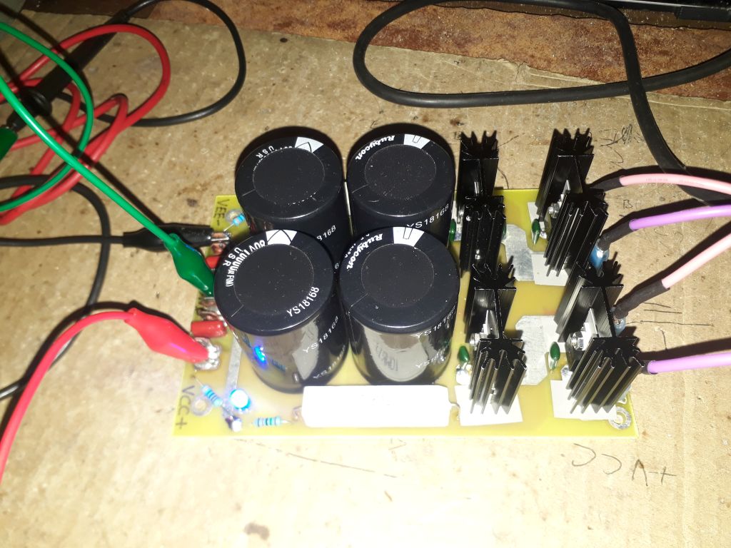

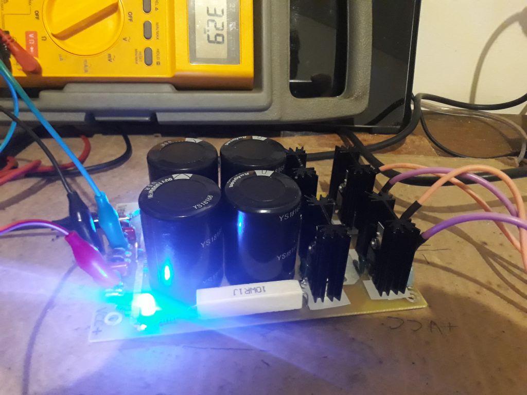

Hi Project16 and Prasi,
I was looking for a psu for my Cordell Super Gainclone project and was unsure which way to go until I stumbled across your designs (schematic and PCB). Seeing so much attention and confidence being given to the design, I thought I'd try a home brew PCB.
I went for the model with caps on the diodes and left out the other options for the sake of simplicity. Its on a 6"x4" 3oz Cu board. I only had 10,000uF caps and 0.1 Ohm 10W resistors so that's what I used. Definitely works!
Thanks for all the effort.
Regards
Mike

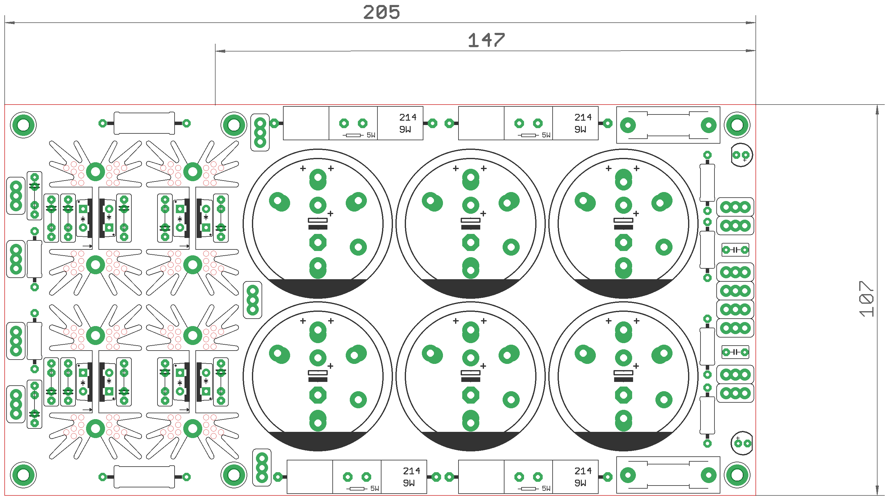

Hey Prasi, a while back you mentioned a CRCRC PCB.
https://www.diyaudio.com/forums/gro...wer-supply-class-amplifier-4.html#post4953822
Did this ever materialize and are any available?
Best,
Silas
Hello Silas,
It uses a CT and single bridge.
How about making it into a dual bridge and dual secondary design? been wanting design something for a break. Tarkus speaker building took too much of my energy and time and no where near finished:irked:.
Lets take this CRC to the next level:smash:.
regards
Prasi
Now we're talking! Although i have to acknowledge early on that talk is cheap and I am a babe when it comes to electronics, so the majority of the heavy lifting (ie. designing) will be on you...

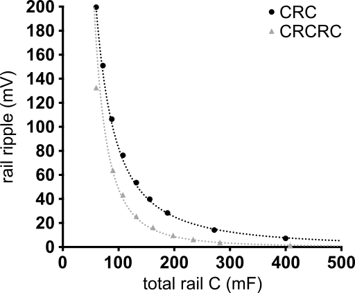

I just was playing around with PSUD2 trying to compare modeled ripple values for the standard FirstWatt PSU design using different total capacitances/rail (CRC), and comparing them with a CRCRC setup. I know i cannot necessarily expect psud2 to accurately estimate ripple, but the comparison was interesting (see attachment). DISCLAIMER: This is simulated data only for single rail PSU ripple into 8R load and has no experimental verification/follow up.
I know this comes as no surprise to people who actually know something about electronics, and i've seen the sentiment several times here on DIYaudio that a CRCRC will net you lower ripple for the same C. But since i have a stock of 15 and 33 mF caps i would like to use for a future FW build, and it seems (according to PSUD2) that 33mF caps used in a CRCRC will give performance similar to a CRC using very large (>>35mm snap in) caps, i thought why not look at this route also.
Now, i am sure there are several counterarguments, one important one being "the firstwatt PSU is proven and definitely good enough for purpose", but since this is DIY we are free to pursue our own screwed up overwrought ideas 😎 And who knows, for some this might actually be really useful (i don't see a lot of CRCRC PCBs available out there)!
So here is a wish list that you are free to discount as you see fit since you are the designer (not to mention the more knowledgeable of us on this matter).
- as you mentioned yourself, dual bridge/dual secondary (just like the standard FW)
- Possibility of mounting discrete diode bridges, or a snap-off diode section (i guess the latter makes more sense, as the discrete diode bridges are probably better off mounted to the case)
- Room for 35mm caps (or bigger) at least 33mF (and also a few sizes larger) seem to be available, which gives close to 200 mF/rail.
- Small enough to fit into modushop 4U/300mm chassis :Pirate: I know this is a tough one...
Feel free to add more.
