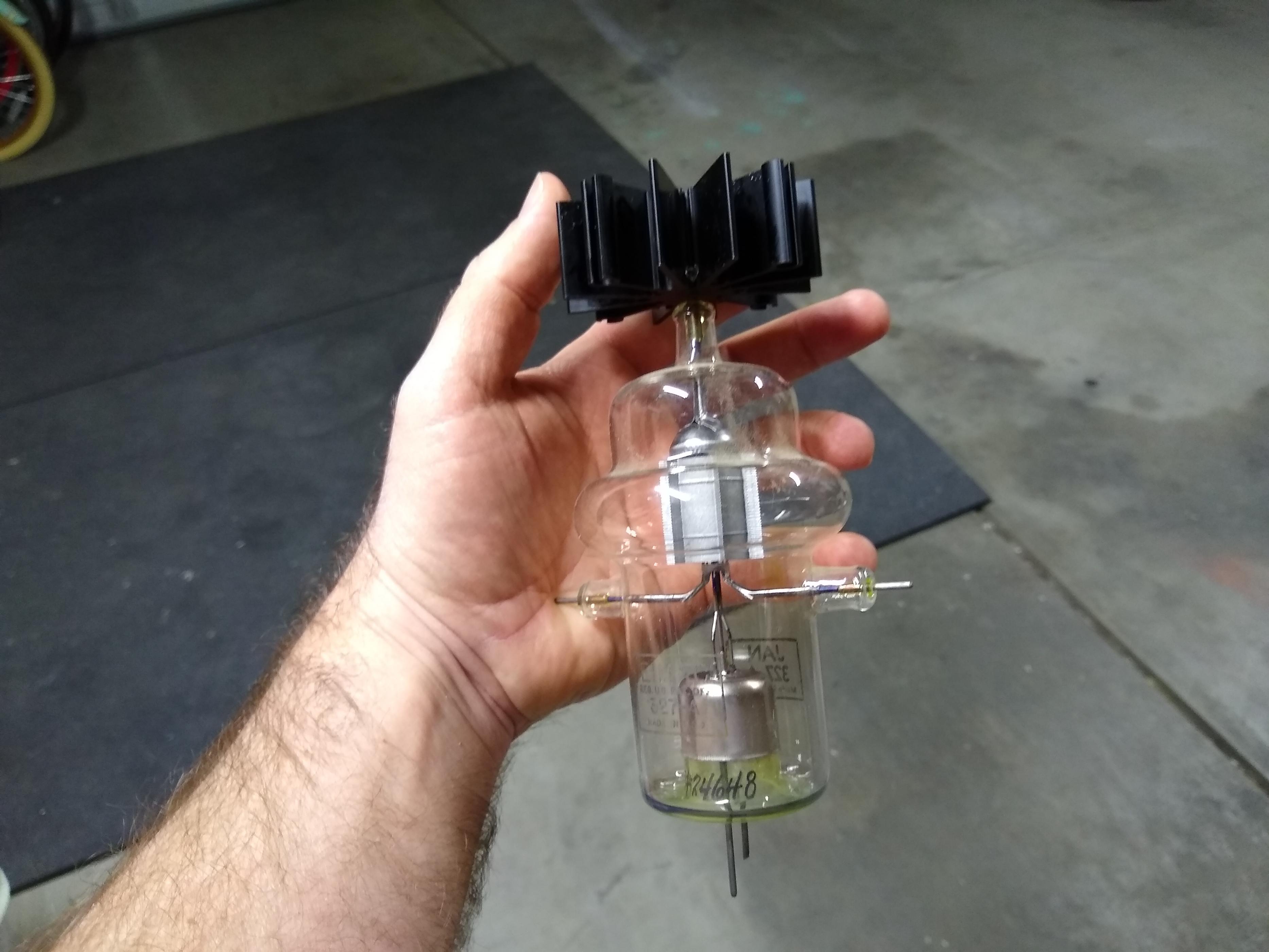

Here's how the caps are turning out. Pretty huge, and heavier than the tube. In the application these tubes were designed for, the anodes were inserted into a larger metal structure, so I may have some structural support (made of an insulator) on this anode cap. I don't like the idea of putting a bunch of weight on the anode glass/metal seal. I'm still working out how I'm going to mechanically support this thing.
The transmitter tubes are fun to play with and if you get the right ones, can be had for a decent price.
Very nice! Certainly have more surface area than the Eimac originals. Maybe you could suspend them from the cage with some non-conducting material?

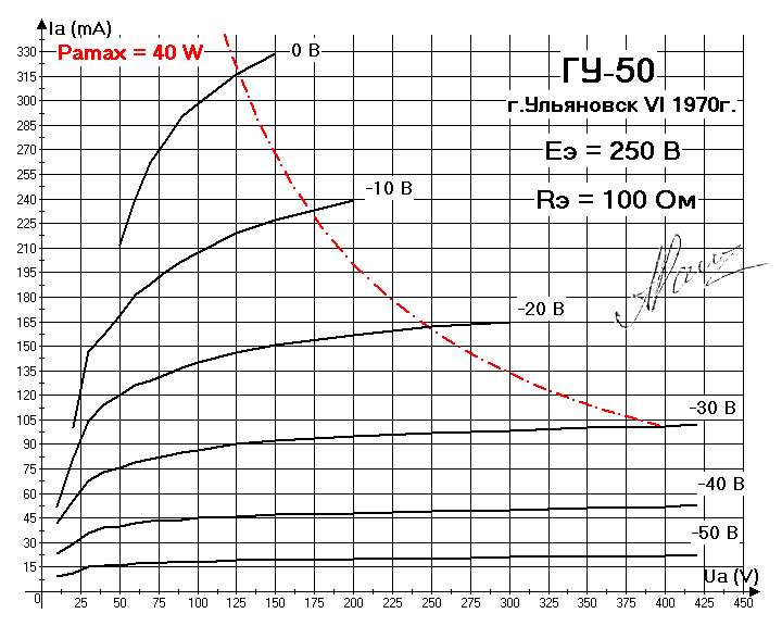

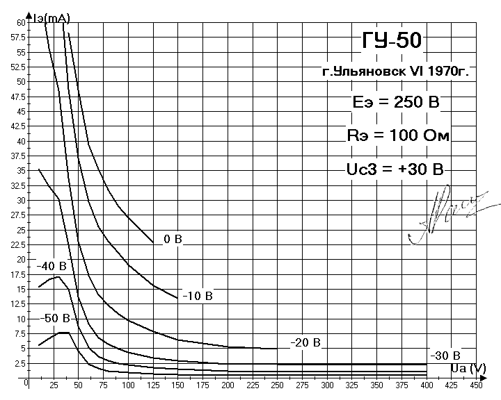

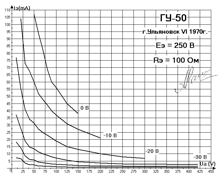

I just remember looking at smoking-amp's curves for various types and noticing that small G3 bias could have remarkable effects on the curves. +12V on GU-50, for example, gave sharp knees to the curves and made them look like 6L6 curves.
If you have a curve tracer and a variable +-15V supply to vary voltage to G3, you could get a really clear idea of whether this will help things or not.
Hi, great suggestion, haven't tried it. Perhaps will fire up again the curve tracer and test there G3 voltage impact. Any suggestions?
I posted in this thread earlier some screenshot of my Gubernator-71 amp that shows that. ;-)

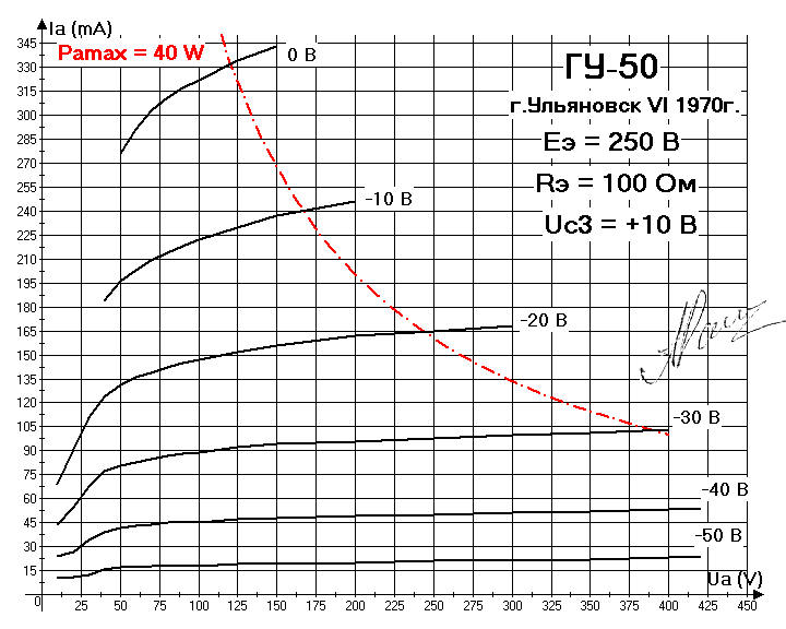

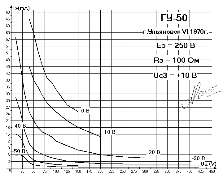

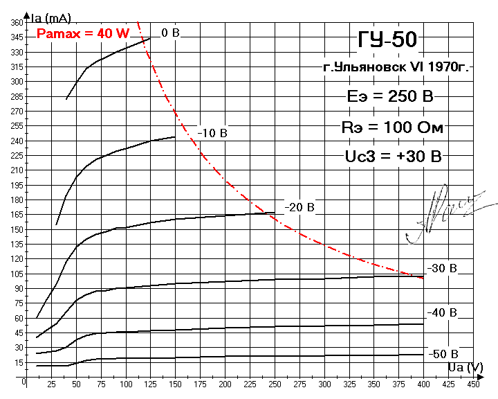

In attachment some of the GU50 curves at different voltages on g3.
I downloaded them from Anatoliy's forum when it was still available online and I was looking to design a bass amp with them.
You can see how curves square up and screen current goes down at the same time, while increasing the voltage on g3 (up to a point).
Has anyone ever tried with a EL34 or EL84? Will they have a similar behaviour?
Will it square up the curves in UL too? (I know none of you is an UF aficionado)
Thank you for saving them! Since I am moving, I had to shut down the server in my barn, and move the content to the cloud. I am afraid, the forum had been lost. :-(
Thanks for pointing me in the right direction, good reading. I remember few times back in time when Anatoliy mentioned the use of +12V on the GU50 G3.
Will experiment....
I did some quick test and was happy to see easy and quick improvements by squaring up the pentode curves. I played before a while looking at the FFT to optimise the screen bias setting so not sure if there was too much room for improvement in this case. Nevertheless, I was happy to see shelving distortion by 0.1% at 200Vpp on the driver. The harmonic profile can be tweaked slightly as the curves get squared up between 12 and 16V in the case of the EF37a.

What's taking up all of my time right now is building the structure to hold the 327-A. I was able to stuff the filament leads into a tube socket and test with some alligator clips and a plate cap that wasn't the right size to determine that the tubes were usable, but I have to do something better if I'm going to use them for any length of time. I have one that was just a little gassy to start with that I'd like to run for several hours but I don't feel comfortable doing that until I'm all set up with something that is mechanically sound and will keep the leads cool.
AudioXpress (or maybe GA?) had an article about making sockets for pins. Although you need a mini lathe and mill to do it.
I'm making plate/grid caps out of LED heatsinks and that only leaves the filament leads (10.7A current) that come out the bottom. I looked at 38999 contacts and unfortunately the filament leads are right in between sizes. I can't use heatsinks or even the old Eimac caps because the leads are too close together. I'm just drilling 1/2" aluminum rod and tapping a hole for a set screw to clamp down on the filament leads. It's the best I have come up with so far, but I am a little worried about the high current and I'd like the best contact I can get.
