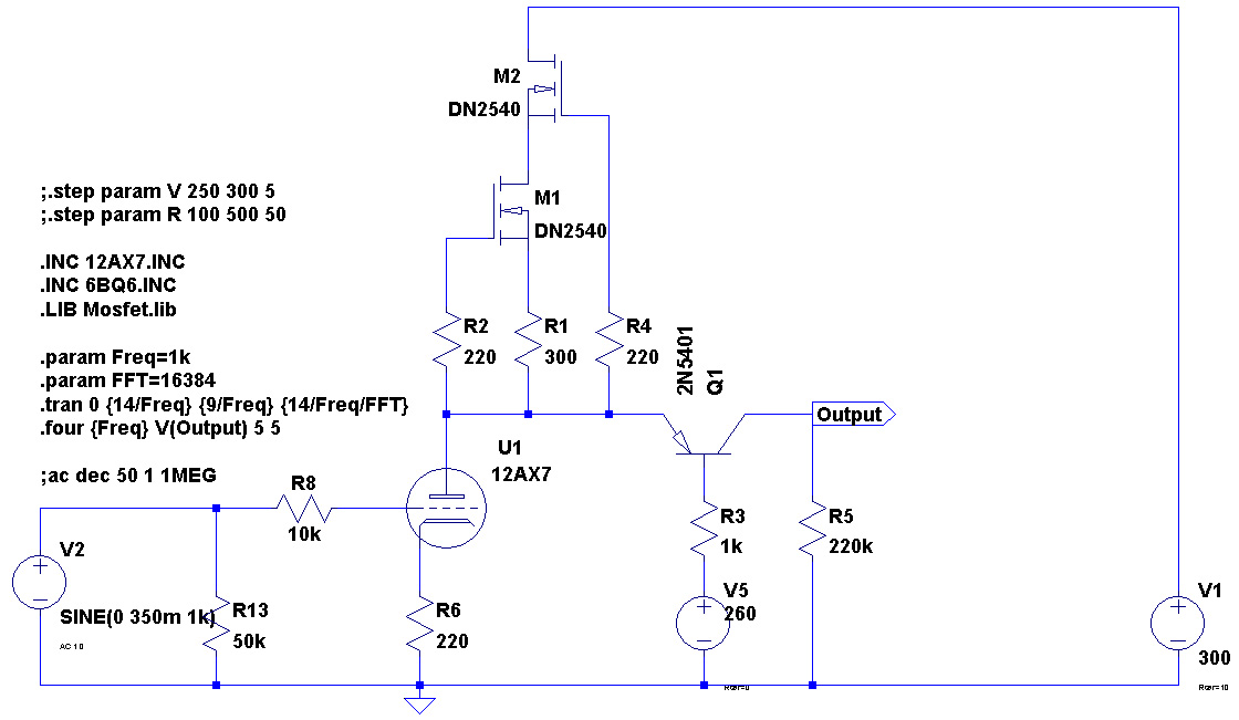

Dear SpreadSpectrum,
while thinking on how to apply your system to cascode, another idea came to my mind.
You use an (almost) horizontal loadline with a pentode, while Rod Coleman uses a vertical loadline with a triode ( Shunt Cascode Power Valve Driver ). Your feedback back to the cathode of the triode can be applied too.
I will try to simulate it.
I will simulate a PP version too, with a power MOSFET concertina phase inverter and ouutput tubes in pentode/UL can have anode to grid shunt feedback with a voltage divider to a negative voltage supply to give at the same time a bias reference to the grid (your feedback cannot be applied in that case, or at least I cannot see how).
It would not be a "Shunt", AKA Parallel feedback, it would be a series feedback.

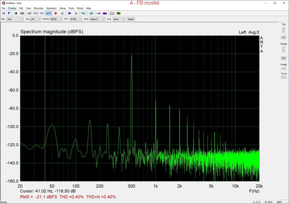

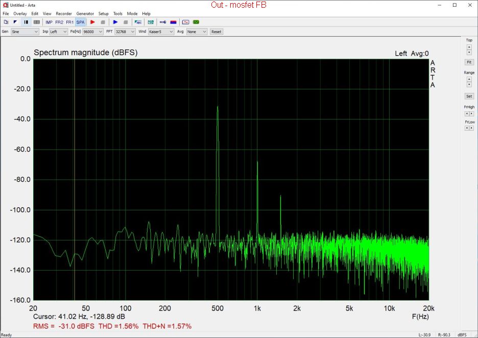

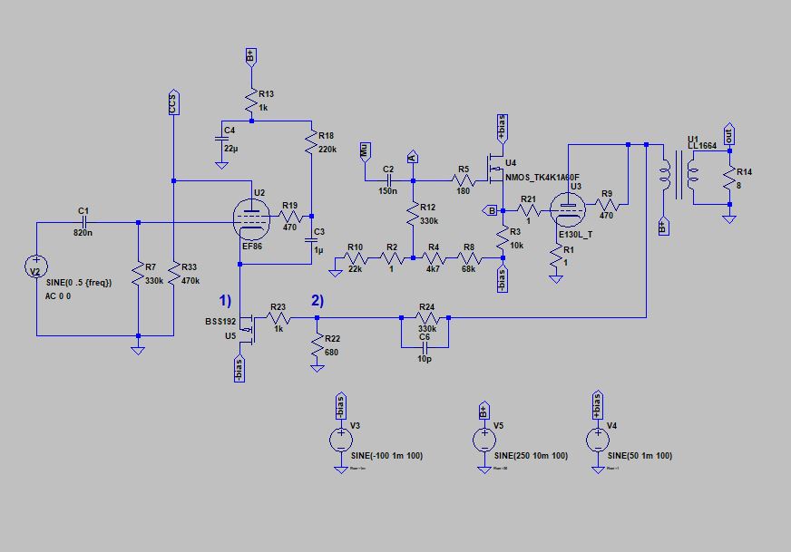

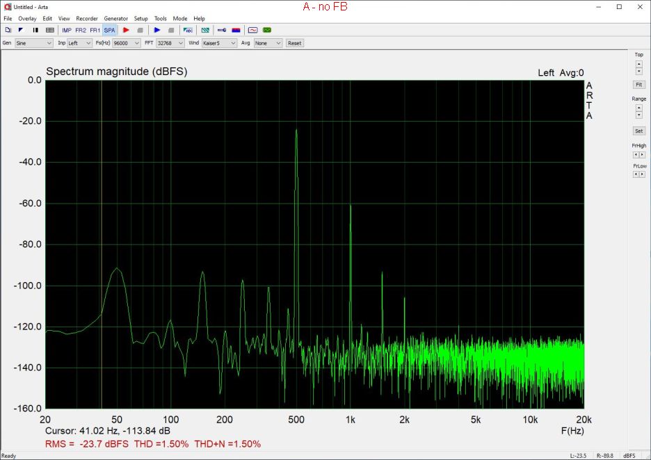

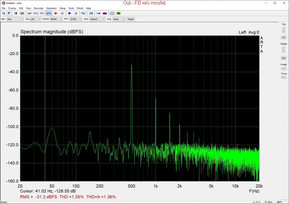

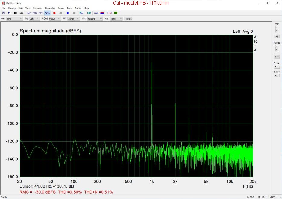

I made some tests with SpreadSpectrum's FB topology on the E130L SET I showed in post #94 Corona: An Ultra-Low Distortion A2 DHT SE Amp Prototype.
Here is my test setup:
The CCS I used on EF37A was similar to Gary Pimm's Self-bias CCS. I tested GFB with mosfet (1) and without (2). The measurements were made at roughly 1W using 6.8 ohm resistor as load. I made measurements at output and after EF37A (A on the schematic).
The results were quite disappointing (see attachments):
GFB with Mosfet
THD @Output: 1.56%
THD @A: 0.40%
GFB w/o Mosfet
THD @Output: 1.35%
THD @A: 0.95%
Without GFB
THD @Output: 0.068%
THD @A: 1.50%
I think the low THD without GFB is due to significant distortion cancellation between stages and output transformer. Applying FB lowers the distortion after driver but the distortion cancellation does not work as well resulting in higher distortion at output.
Another drawback of this setup was that CCS on EF37A made it very prone to oscillations. EF37A is probably too wimpy for CCS.

I'm not sure how negative feedback could make distortion worse like that. The only thing outside the loop that could cancel distortion would be the transformer, but I don't see it producing that much.
Have you measured distortion at the output tube plate? Something seems off here.

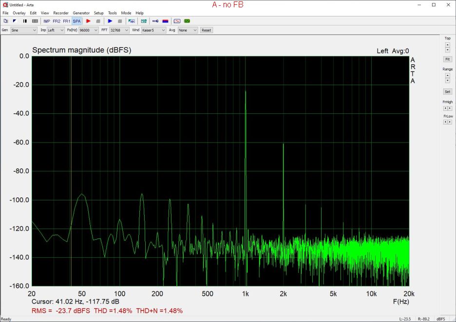

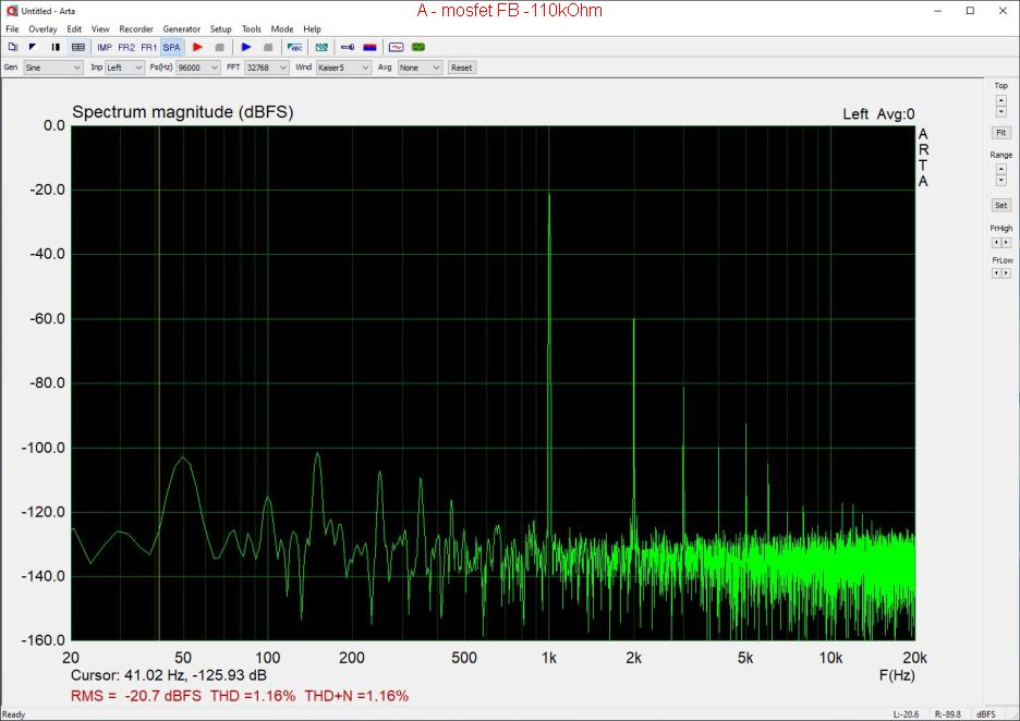

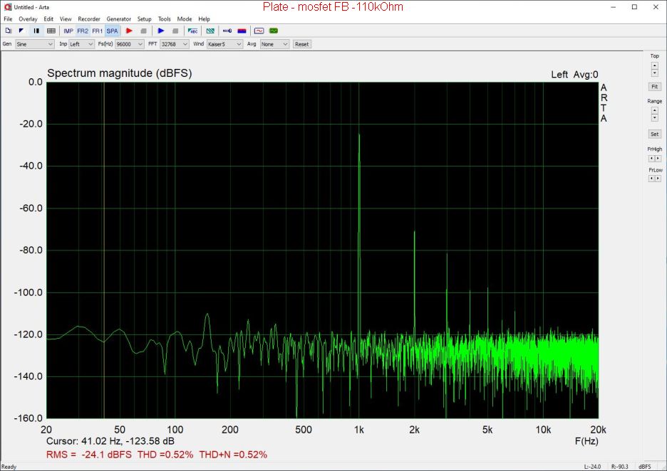

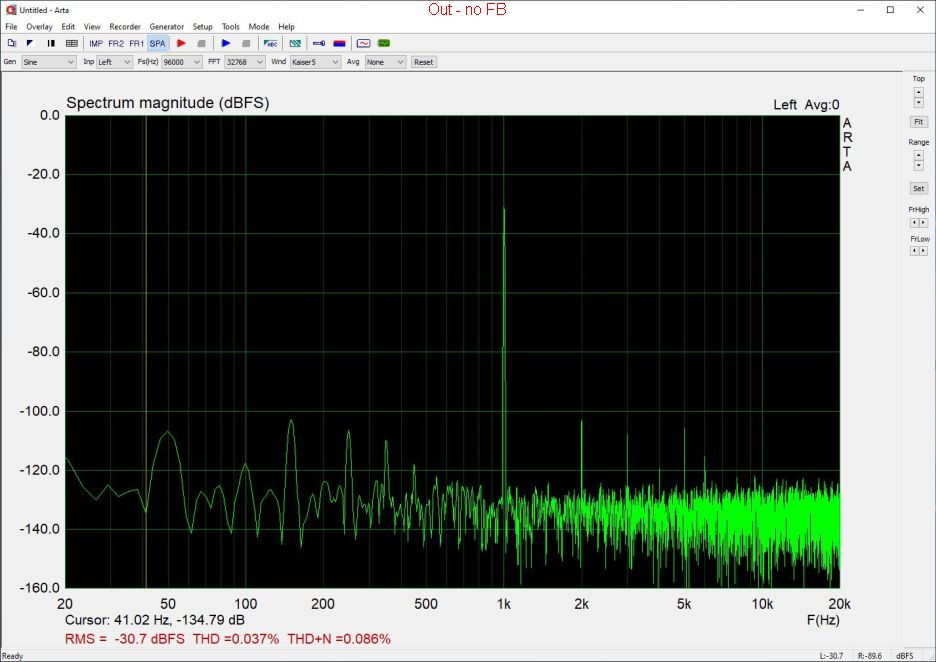

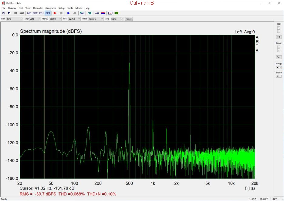

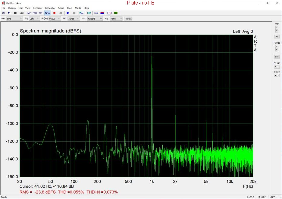

Here are measurements from A (after EF37A), E130L plate and after output transformer using mosfet GFB and without GFB. I lowered the FB resistor to 110kOhm so the distortion with mosfet GFB is now a tad lower. As can be seen the output transformer does not have much effect on the THD. The distortion cancellation occurs mainly between driver and output tubes. In the mosfet GFB version the mains related spuries are lower. This may also be related to having CCS anode load on EF37A.
Strictly speaking these are not the same circuits as the GFB version uses CCS as EF37A anode load where the non-GFB version has resistor anode load and led bias on EF37A. This may explain the rather unexpected outcome of applying GFB.
Ok, that makes sense. You probably did just get really lucky and found a good combination of input/output tube that cancels distortion.
As for the feedback circuit performing at such poor levels, I'll have to look your circuit over some more when I have time. Typically, I see more distorted levels inside the loop (since the feedback works to drive levels to where they need to be to cancel the distortion). My output tube grid waveform at 19W output looks like a triangle wave, but distortion at the plate is only 0.3%. I'm sure THD at the grid is off the charts under those conditions.
Actually this all started way back in 2005 when I traced real triode curves of some E130Ls I had. I noticed that some of them had very low distortion (actually much lower than the Spice models predict) so it is not pure luck 😀.

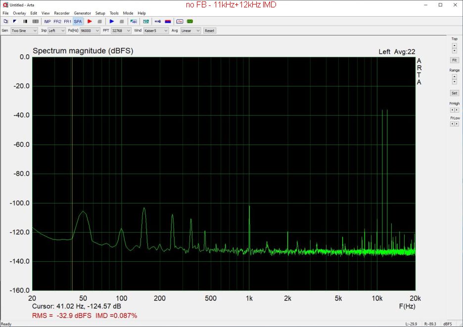

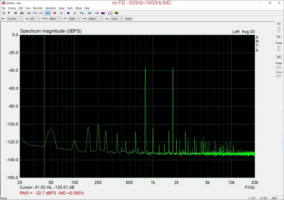

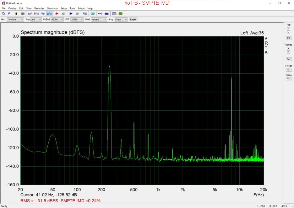

And for those of you having some doubts about the distortion cancellation here are some two-tone IMD measurements without GFB. At 800Hz+1800Hz, 11kHz+12kHz and DIN IMD (250Hz+8kHz).
Actually the FB circuit can be "tuned" in the same fashion as the non-FB circuit by adjusting the screen resistor of EF37A. Tuned to the the minimum THD setting for non-FB, the THD for FB circuit was more like you described: higher distortion at output tube grid but with this setting the output THD was more than 1%. The measurements I showed earlier were made after tuning the FB circuit to minimum THD which also had a lower THD at output tube grid. But like I said before the CCS anode load on EF37A made the whole circuit very touchy. It burst into oscillations very easily so tuning for minimum THD was difficult.
