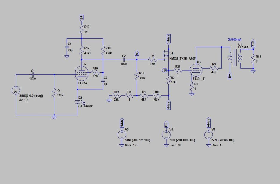

Does the output of M1 do anything funny when you are hitting the stage with the square wave?
Nothing too funny, DC at g2 but littered with HF noise, around 11MHz, have a 1K gate stopper on the DN2540. The prototype is a mess of alligator clips though, so the long wire runs are not ideal.

At that frequency and amplitude, it is self-oscillation of the FET.
It could well be that the screen-grid is provoking it, so adding a little resistor in the source (100Ω) may be helpful (to help to avoid the source looking into a reactive load).
Source followers are more stable if the drain is decoupled to HF standards with a 100µF 'lytic, plus a stacked-construction film cap, say 100nF. This reduces the risk of the drain wiring thinking about becoming the L in a Hartley oscillator.
Shorter wiring is probably necessary too, and the grid stopper is better at 100Ω, IME: higher values present a higher impedance to the (internal) transfer capacitance, which can be involved in self-oscillation.
I changed my gate stoppers to 100ohm and added 100ohm between the source and g2, which did not have a significant effect. However, I took your suggestion Rod and placed a 0.1uF stacked film cap + 100uF electrolytic across the drain and ground, which dramatically improved the noise I posted above. The ringing on square waves persists, so perhaps it is two separate issues. I suspect the CCS is playing a role as I had this problem before with a different set of FETs, but that is all I have time to troubleshoot today, I will have to look into it later this week! Thank you both for your input.
If some of the wiring is long, it's possible that there's some coupling between the output and the gate, bypassing the 1M resistor. If possible, making the gate and source wires to the cap as short as can be, an putting the 1M up close too - may reduce the susceptibility to unwanted intrusions.

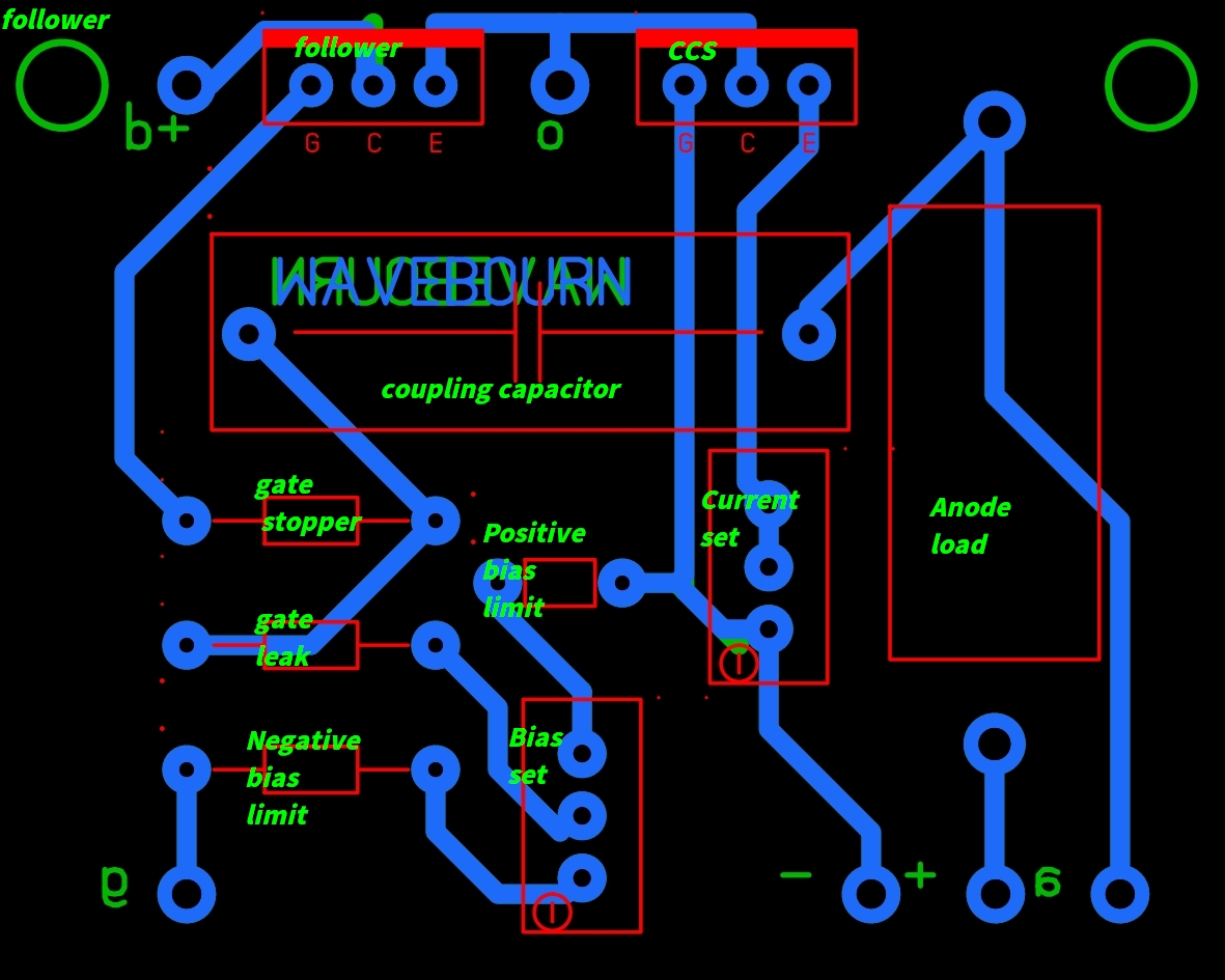

Thanks, Rod. I am going to mock up some PCBs for the screen supplies along with some other circuitry going in the final amplifier, see if I can't shorten the leads in the prototype with some real boards, will help with wire management and get a closer approximation of real-world "final build" performance.

Yes, a tightly laid-out board is the best solution.

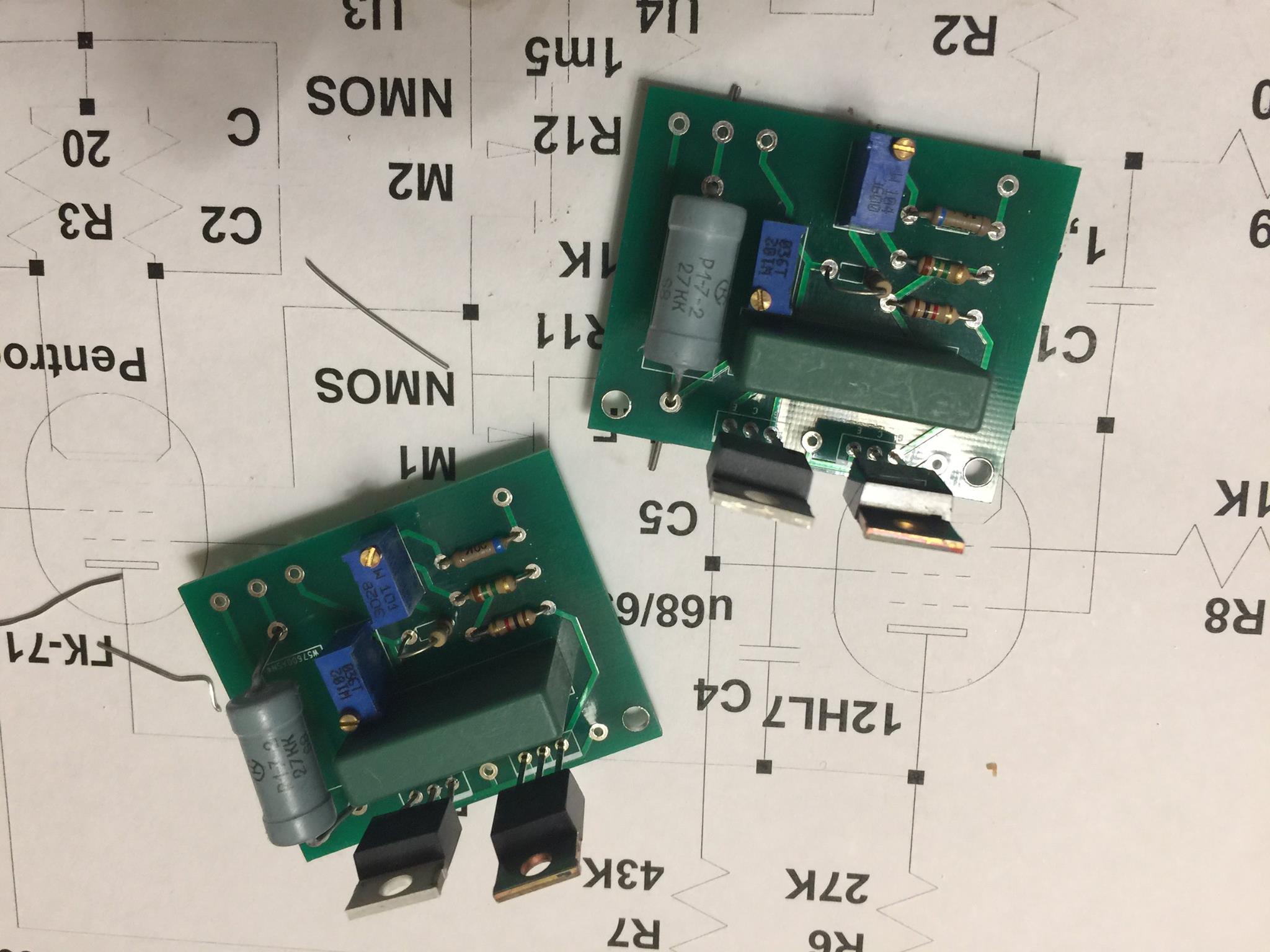

Good progress, definitely shortening the connections and looking at high-impedance nodes, loops, etc. is key here as recommended by Rod
I have some PCBs made for screen supply, etc. which will definitely help. Just ping me an email if you want some.

Thanks, Ale, I'll continue to investigate and I'll give those PCBs some thought!

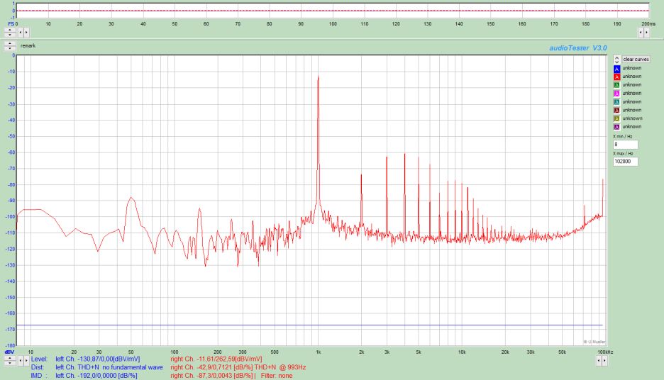

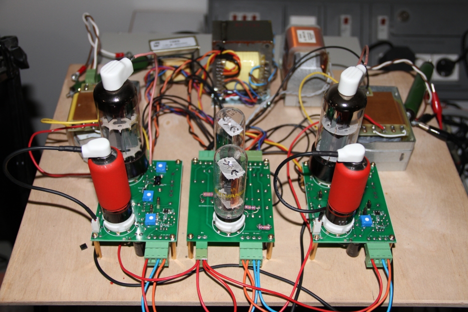

This thread reminded me about a similar SET I breadboarded around 2005. It has EF37A front-end and output tube is E130L trioded. I also added a mosfet source follower for A2. Output transformer is Lundahl LL1664. The operating point is 250V/100mA which is about the max for trioded E130L.
This SET had surprisingly low THD for open loop SET. Actually way below what Spice predicted. But for some reason I never built a chassis for it. However inspired by this thread I decided to re-breadboard it.

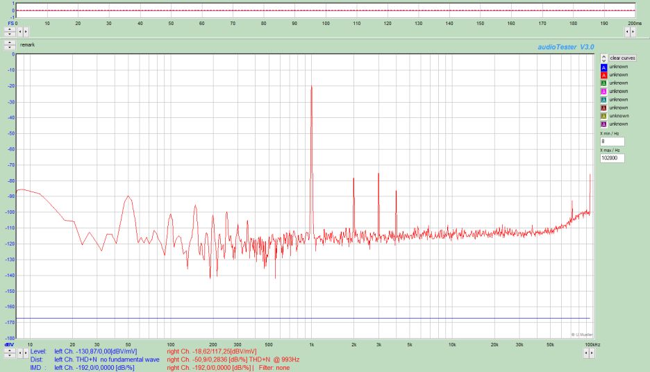

I made some measurements at 1W and 5W and the results were similar to what I saw in 2005 (see attachments).
E130L is a tricky beast. As a high transconductance tube it oscillates if given the slightest chance. Another drawback of E130L is that the variation between tubes can be huge. Some look fine in AVO but give awful results in actual circuit.
Now my next step is to try SpreadSpectrum's feedback scheme. IIRC regular feedback schemes did not deliver back in 2005.

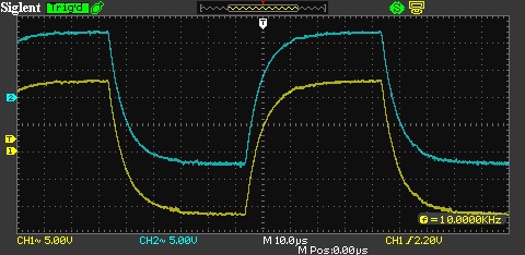

I have attached some 10kHz square waves of the input stage (yellow) and mosfet output (blue). I did some open-loop testing when I moved the input cap to see if there was any ringing there. The roundness of the edges kind of surprised me. I had assumed it would move a bit faster.
