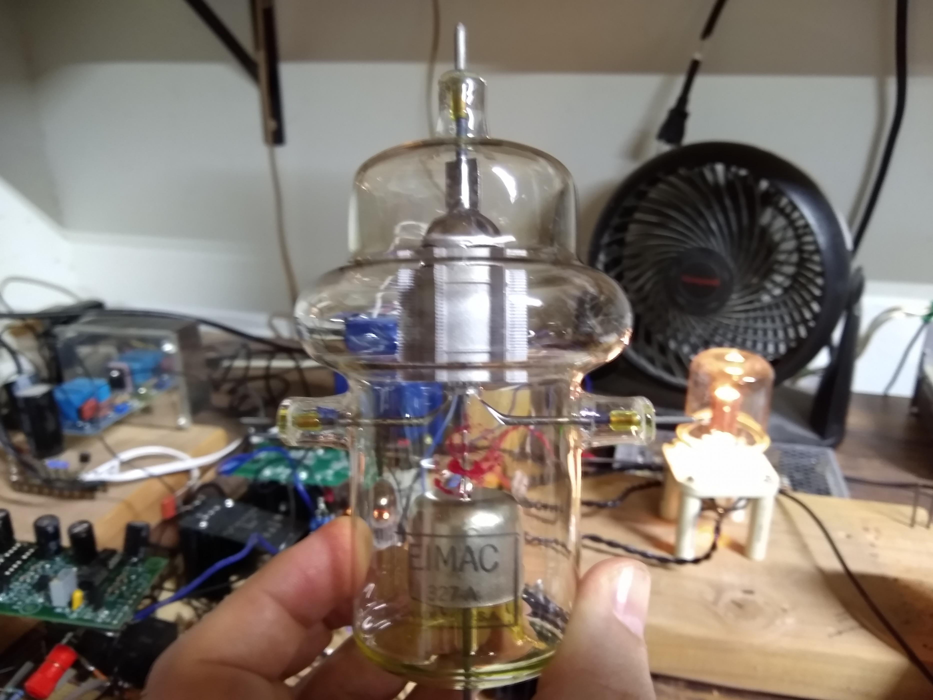

I have acquired a few 100THs, which look really cool. I have 6 good 826s now, which should last a while. I also have a couple of these 327-A tubes. One of them was given to me a long time ago and another I recently came across on Ebay for $25. I don't know if they are good tubes yet and I'd have to build a socket to hold them properly but they are basically a 100TH with a little lower mu and a 110W filament (designed for radar pulse duty in a ring oscillator). Hopefully neither has gone gassy over the years. Filaments are not open at least. Next Mouser order, I'll get a switching supply to light the filaments up and we'll see if we have any gas clouds.

Those 100TH are striking, will look great in an amplifier. Tried and failed to find curves for the 327-A, that is one oddball tube!

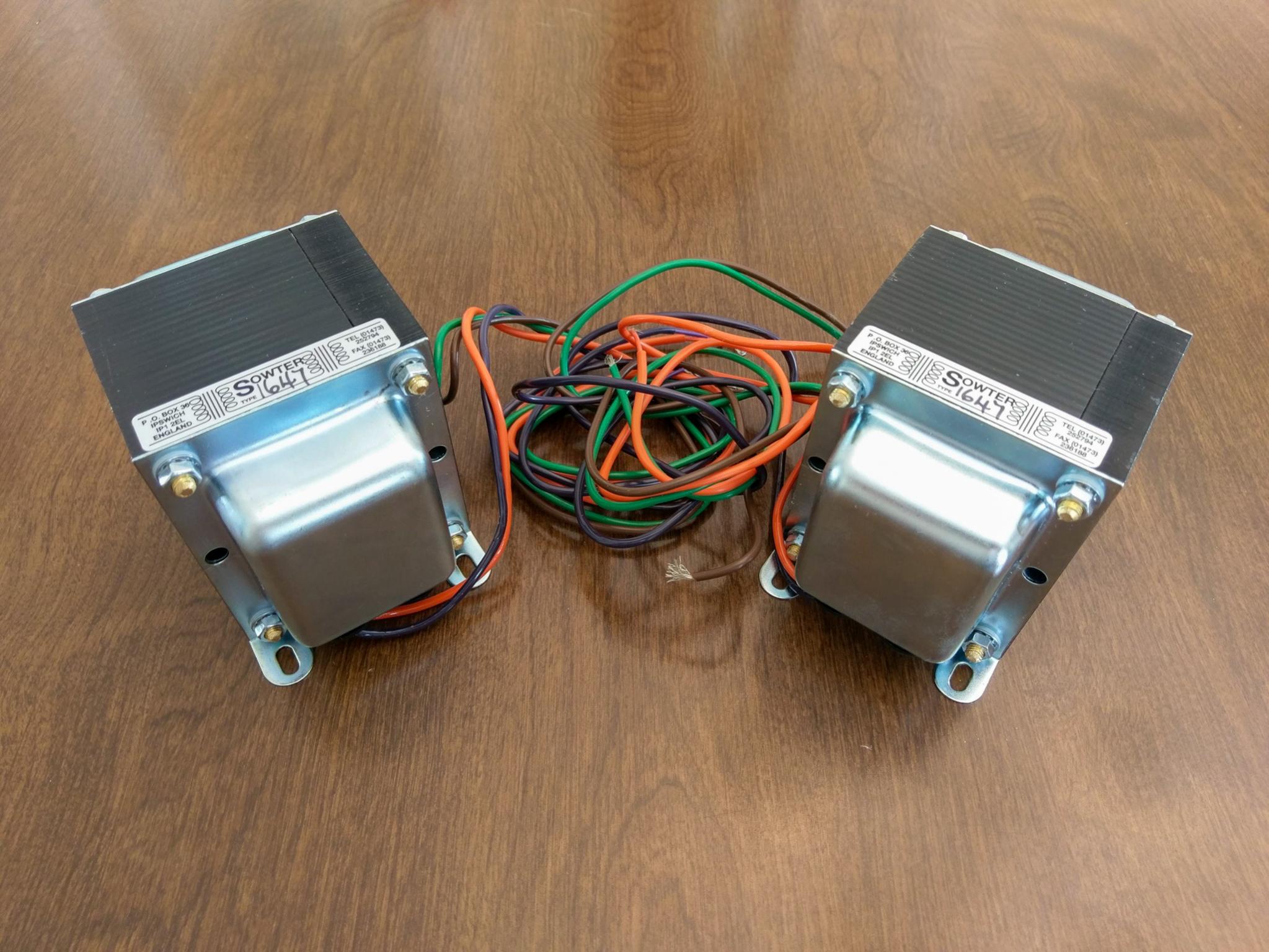

I received the Sowter transformers for my 801A amplifier. I typically work in my garage, but it is too cold to leave parts outside, got a foot of snow last week. Trying to come up with a practical way to throw together a single channel indoors, but soldering inside is frowned upon in my househould ha! It may have to wait until spring.

Yeah, the 327-A were specially made for radars so I don't think Eimac ever tried to market them to the public. I'll have to do a little curve tracing on my own. It is wild that they have a 110W filament and a 100W plate. Very inefficient but it should be quite the light show! They must have needed a lot of peak emission during the radar pulses.

Would you mind telling me the basic specs of these transformers? I believe you are using A2. I have several 801As and have believed for a while that A2 operation is a viable approach. Excuse me as I have not had time to fully explore the entire thread

Hi! The transformers I showed are 5K:8ohm 60mA for a 0Vg A2 bias point, 320V 60mA on the 801A. Using transformers of this impedance necessitates NFB to reduce the output impedance to acceptable levels given the relatively high plate resistance of the 801A, I have seen others use a 3K primary for the 801A in A2 with more NFB. If you wanted to use them in a no NFB A2 design, a high primary impedance OPT will be necessary.

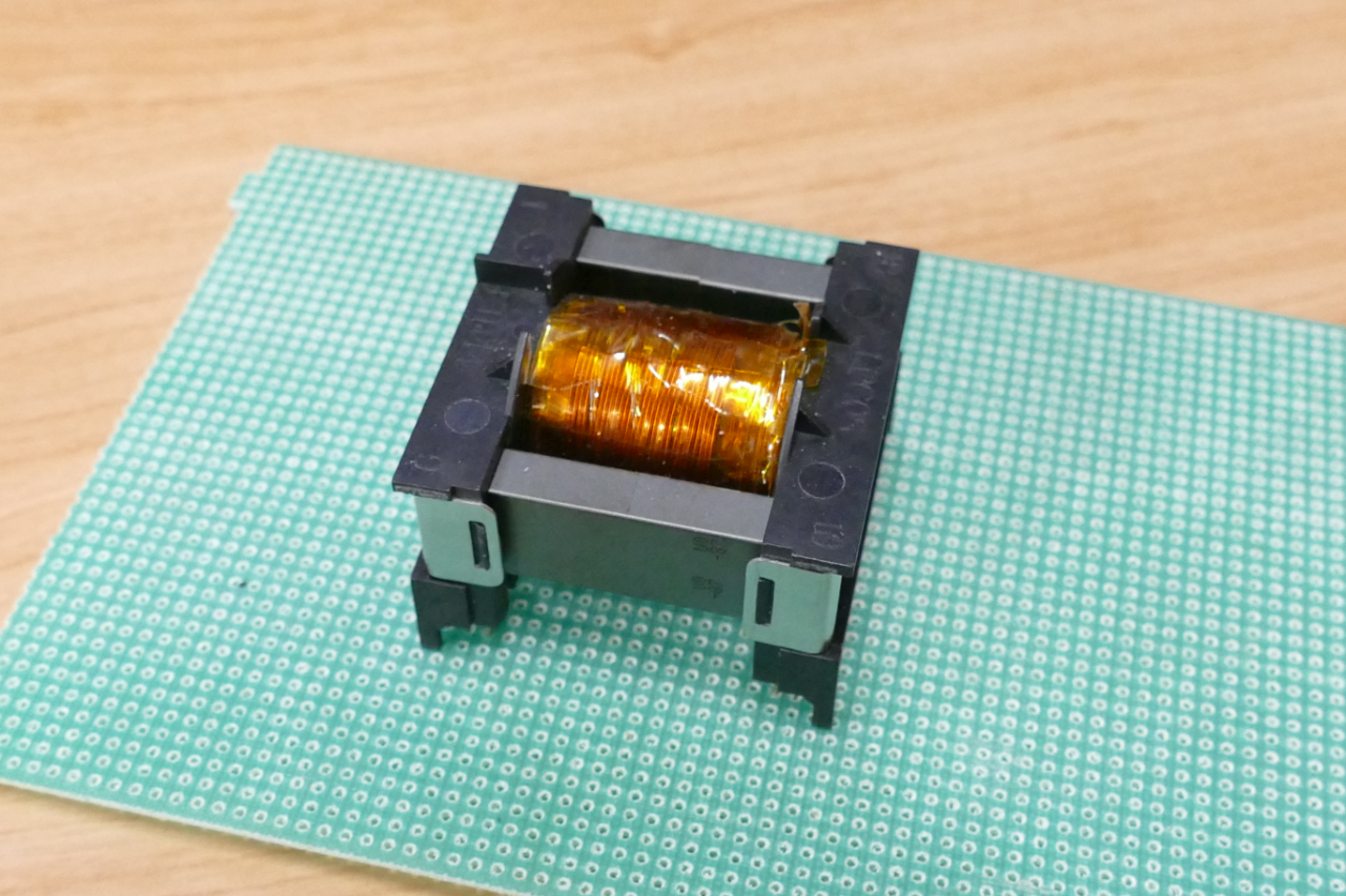

My first experiments tried to make a lower power 650 volt SMPS. Those all ended in fried parts. I think there were just too many turns on the transformer secondary. It got hot even with no load.

I bought all the parts and wound the transformer for one but that's as far as I got.

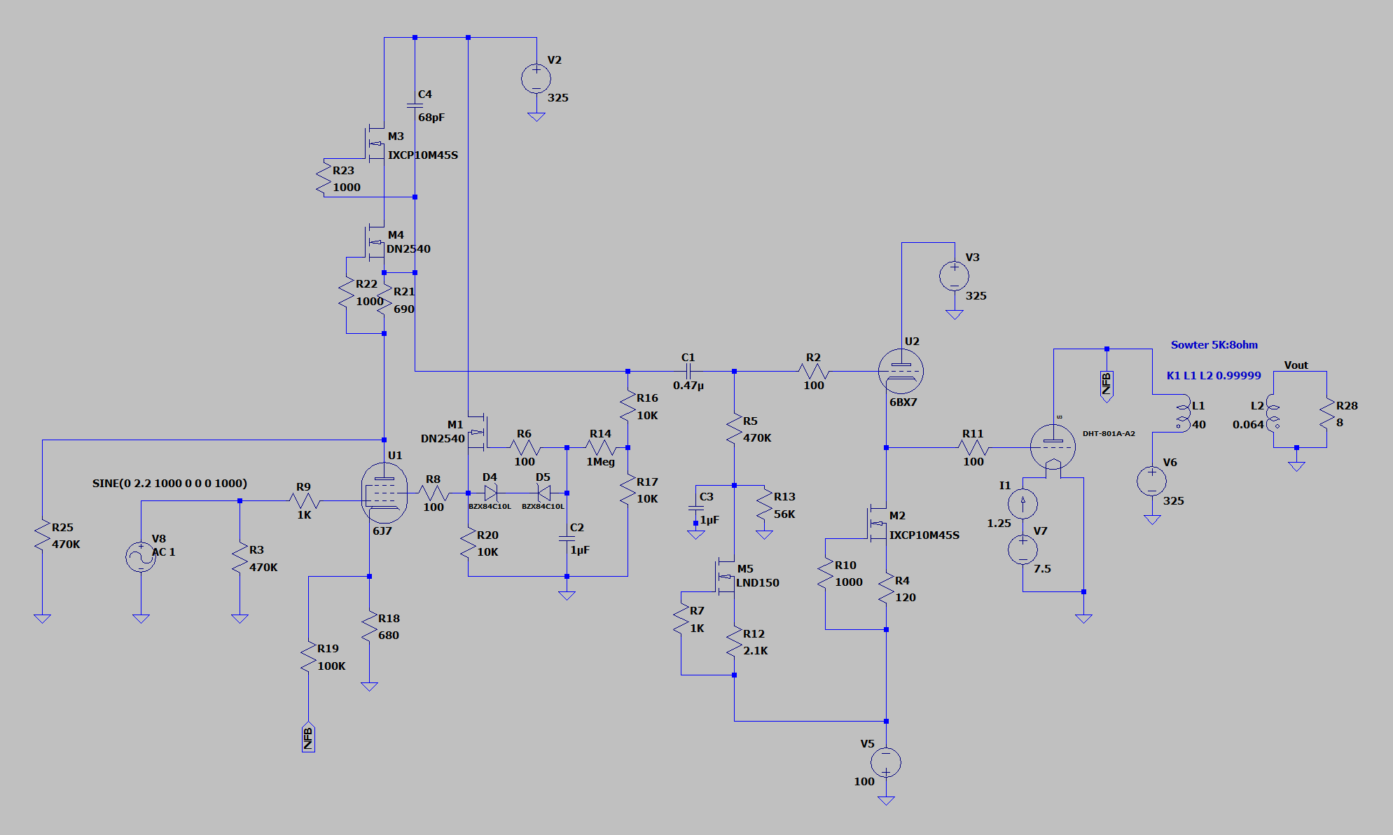

I have been thinking over some ideas on my 801A A2 amplifier. I was using a source follower FET before with plans to get a 0V bias point using a DC regulated heater supply for the EF37A, making the gate of the source follower FET a few volts positive by taking a tap from the regulated heater supply. I tried this out with a filament supply I had laying around maybe two months ago with mixed results. I'm sure I could improve upon it, but I'm not loving the idea.
I am considering dropping the source follower and going with a 6BX7 cathode follower with a current sink instead, like below. Adjustable LND150 CCS sets the grid voltage on the 6BX7 so the cathode can be adjusted easily to both sides of 0V to dial in a perfect 60mA bias on the 801A. I like it!
Other thing I would like to experiment with is using a VR105 voltage regulator tube to get 105VDC on the EF37A screens. Won't be as robust as the feedback mechanism in the schematic above, but drift has not been an issue for me so far even without it, which I attribute to leaving the EF37A cathodes unbypassed - open loop gain is not as crazy high as some of the other CCS loaded pentode stages in this thread. We'll see how it goes!

Recently I've been playing a while with the EF37a. A beloved pentode which I used extensively in the past. The results are here:
Mono Amp: EF37a driver (part II) – Bartola(R) Valves
As discussed with JC Morrison, setting the screen voltage to the right sweet spot is key to minimise distortion of the driver stage. I found it around 115V for an anode voltage of 235V. The DC feedback is key to avoid drift in my opinion.
