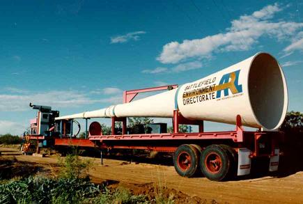

2) Mike Justin, the original owner of Eclipse Concert Systems, one of my business partners 1977-78, was stationed on an island where the military tested a re-entrant (folded) horn over 20 foot long, the path length would be near 60 foot. The exit was around 8 feet (or whatever width military trucks were in the 1950s) in diameter, and the truck was so heavy it left permanent indentations in the asphalt road. The truck carried what looked to Mike to be tons of tube amplifiers, though probably far less output power than the 12.4 pound 6000 watt amps I now use.
Before the test, Mike and his platoon were instructed to go into an underground concrete bomb shelter until some designated time. The sound of the tests, with fingers in their ears, well below the surface, in an A-Bomb proof structure, was nearly unbearable to guys used to pumping off rounds from 45 pistols and heavy armament.
At the designated time, they came out to an eery silence, after a bit of scouting, the reason for the silence was obvious, all the birds lay dead on the ground.
I have looked for any documentation of the horn weapon, but have not found any. Obviously, friendly troops could not be in the vicinity without being deafened, and though deaf enemies are less effective fighters, they can still kill. The military probably just scrapped the project, and locked up the documentation in some long- forgotten file wasteland.
