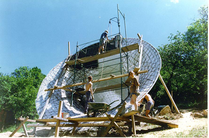

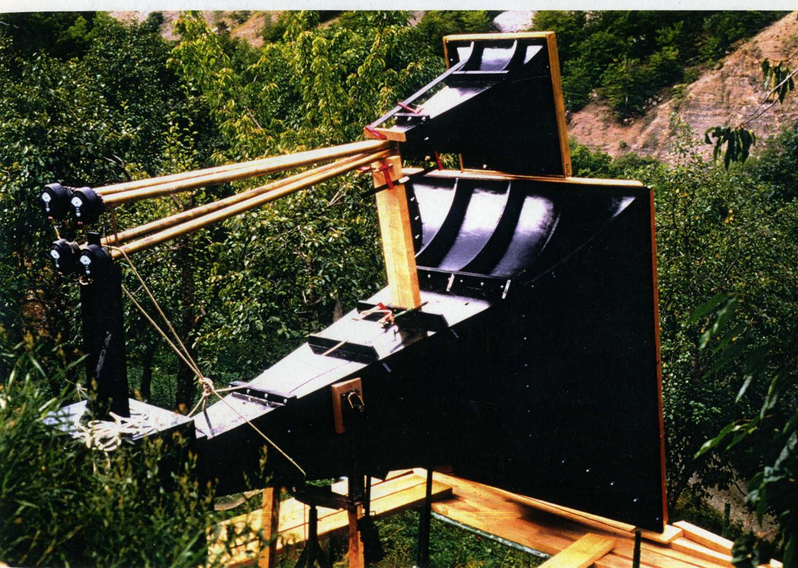

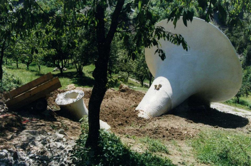

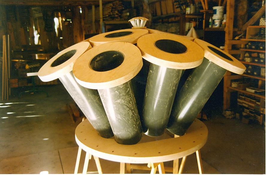

echos

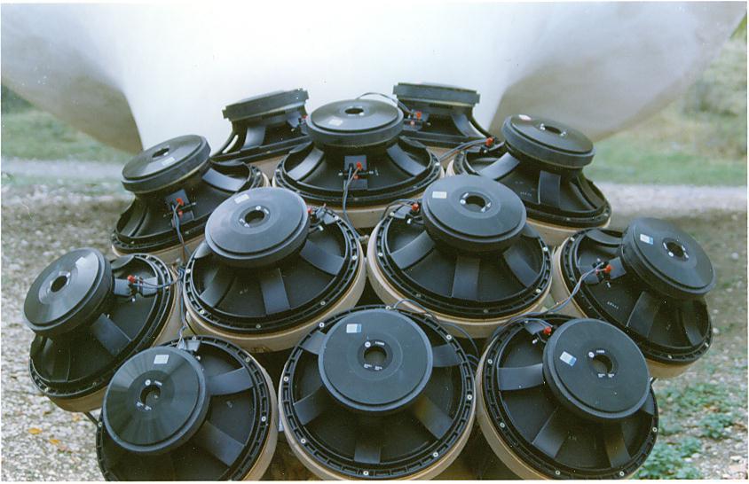

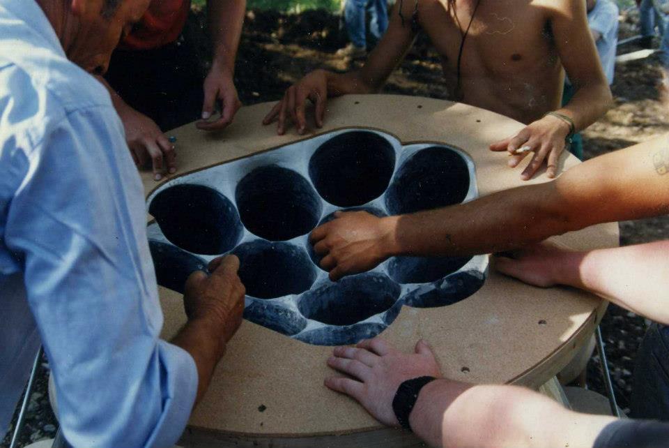

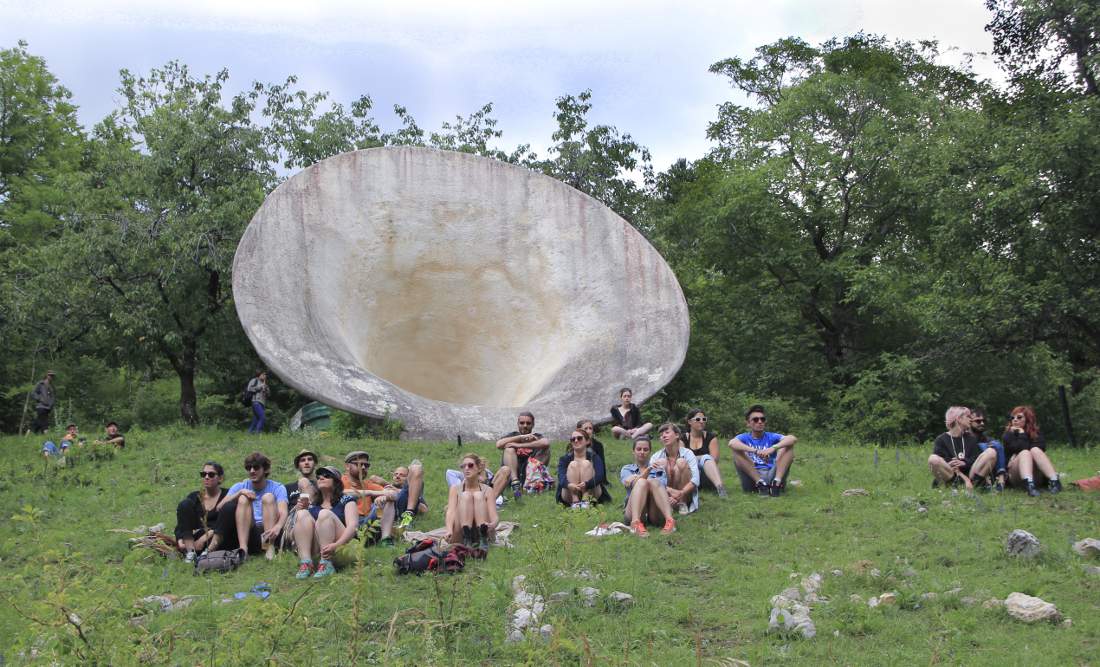

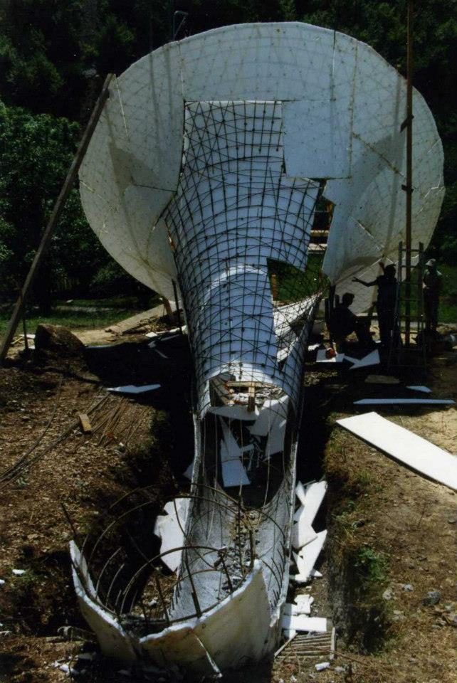

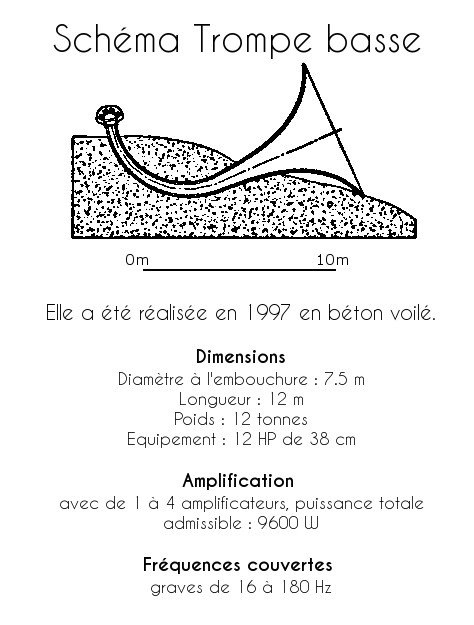

Here is a project similar to yours.
They used concrete shell construction essentially above ground.
I have attached some files for immediate viewing here.
A lot more may be found at the following URL.
Echos 2015 - The acoustic system
Note the waveguides on the tweeter horn used for time alignment.
WHG
WHG
