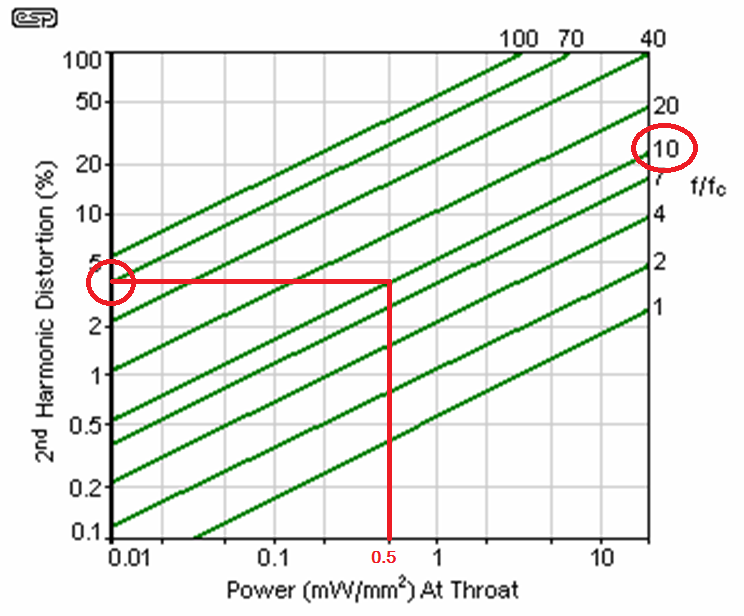

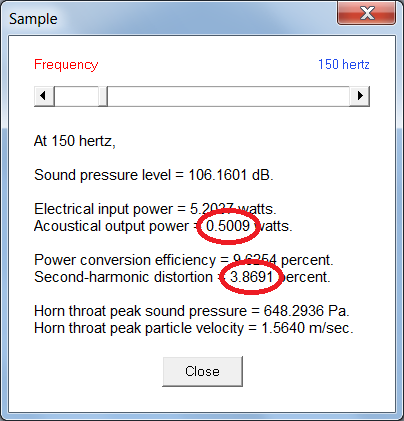

Assume a typical compression horn (1 kHz cutoff), playing at 10 kHz, with a standard 1.4” throat. Using the graph, 1% distortion happens at 0.5 acoustical Watts (117 dB).
I am not sure that you are interpreting the chart correctly 🙂.
Power output = 0.5 acoustical watts
Throat diameter = 1.4 inches
Throat area = Pi * (1.4 * 2.54 / 2) ^ 2 = 9.93 cm2
Power density at throat = 0.5 / 9.93 = 0.05 W/cm2 = 0.5 mW/mm2
For 0.5 mW/mm2 and f/fc = 10 the second-harmonic distortion is close to 4 percent.
The result is consistent with that generated by Hornresp at 150 Hz for an infinite exponential horn having S1 = 9.93 cm2 and F12 = 15 Hz.
I made a type-o last night on the calculator - meant to say 0.05 Watts gives 1% (which is 107 dB). Again, the Plach equation states 1% "second harmonic distortion" happens at 6.9 acoustical Watts (128 dB). This is a fantastic disparity. My assumption is that the Plach paper is simply in-error.

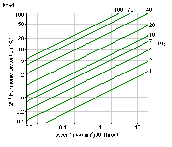

The graph provided earlier is probably from Beranek (LLB).
See attachments that address horn distortion.

Extrapolate Distortion Estimate for [T] < 1
Thank you for the links. I'm slowly working my way through them. Equation 9.33 within the LLB3.PDF file seems to correlate with both the Hornresp program, and the graph you posted on #1187. It also seems that for smaller values of T (i.e. hyperbolic-cosine horns) that the distortion problem is more pronounced - doesn't say by how much.
Note that for an exponential horn
m = Ln(Sm/St)/l
& fc = m*c/(4*pi)
For the longer horn where [T] < 1
assume a longer [l] exponential horn and calculate a new [m] & [fc]
Now on this basis, reevaluate distortion levels from Beranek. WHG
