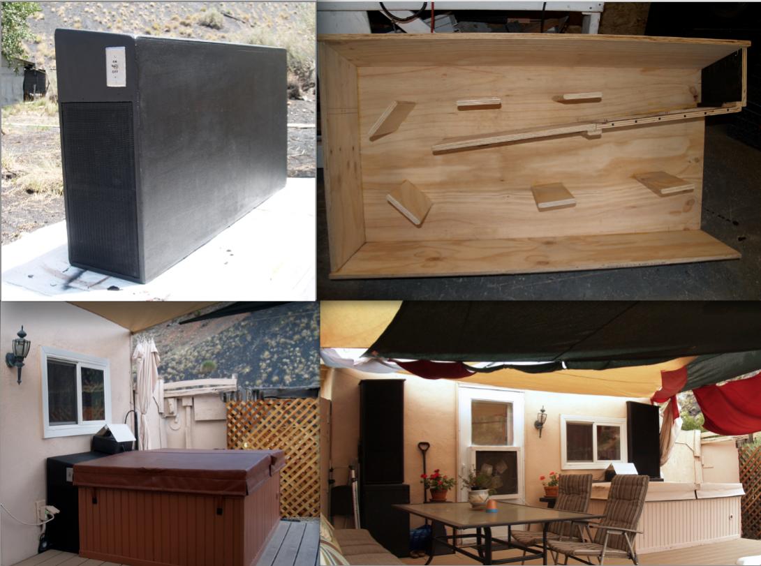

The photos below show a hot tub sub using two $5 "buyout" 10" woofers, it put out plenty of level down to 25 Hz with a Technics receiver set at "11 oclock", powering the patio, kitchen, and living room speakers and subs. When I first tested the "Tub Sub" and patio speaker system, turned up the receiver to just under clipping, the SPL was about conversational level at my nearest neighbor to the south, 900 feet away. It was rock and roll level in the 60 foot fenced patio area.

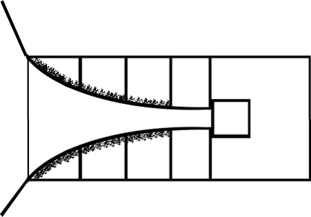

If I was going to do this the container would be the horn, I wouldn't put a horn inside a container. The container walls would be the horn walls. I'm a frugal kind of guy, the only reason I ever even thought about using a container is because it's already an enclosure and it's already in my back yard.
Just to be clear, I wouldn't make it anything like your picture, I would make it a folded horn similar to the Matterhorn.
To use a shipping container only as a shelter for a horn is something I would never do, I'd rather make modular horns out of wood and store them in my living room.
