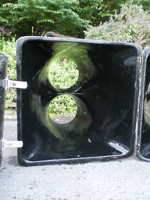

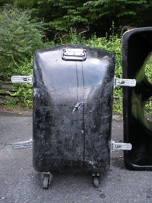

All this talk about huge horns reminds me of the first pro musician gig I had circa 1985, where we used to lug these around everywhere (plus the extension flares not in pic) see attachment. Not sure how effective they were vs other LF boxes of their day (EV 4050's etc), but you could break them down and stack them.
Enough of my babbling, carry on gents, this is very educational...
