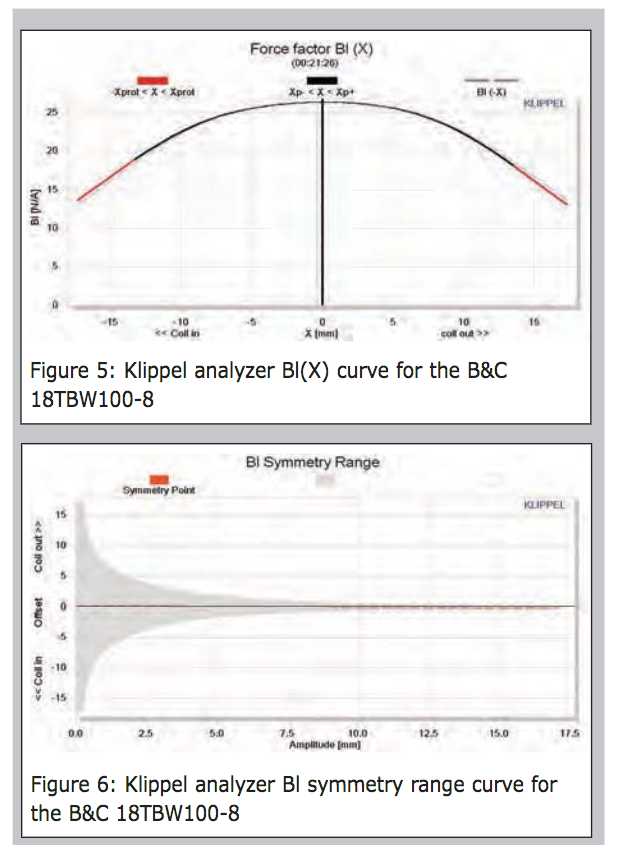

JAG,Here's the B&C 18tbw100 Klippel Bl graph, for those that didn't click the link.
Do you have a link to B&C 18SW115 Klippels? Love to see it.
I searched for quite a while and could not find the 18SW115 Klippels, but the first thing in the search found was a reply by Josh Ricci from 2/26/11:

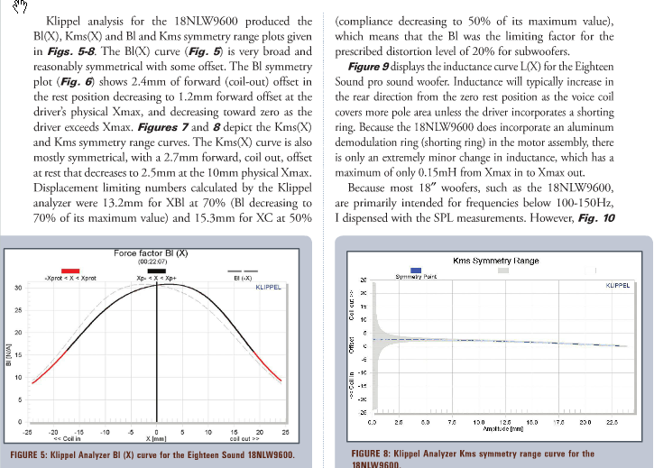

"Really...I did not know that DSL had switched (from the 18 Sound 18nlw9600) to the B&C. Interesting.The top 18" and 21" drivers from both respective companies simulate within a gnats hair of each other in most alignments. There is a full test in Voicecoil mag by Vance D. with Klippel reports for both the 18sw115 and the 18nlw9600 (I figure that you are aware of this but others may not be.). Overall I thought the B&C was very slightly better judging from the symmetry of the BL/x, LE/x, and KMS curves. Both are monsters though.
BTW I have a pair of the B&C 21sw152's and I have a similar "experiment" finding as you did. I free air tested them and they were great up till about 30mm p2p, at about 40mm p2p (guesstimate) they exhibited some motor air flow noise and a little suspension noise. I had the driver connected to a single channel of a QSC pl9.0 run off of 240v and with a 10hz sine wave I was able to drive the amp into clipping without damage to the driver. It seems to brick wall at about 40mm p2p or a little past and further power increases just heat up the coil while not producing appreciably more excursion. The last 3 or so increases in volume did not appear to produce any further cone excursion. Moral of the story is that it seems like you would have to do something really dumb to mechanically damage these drivers. To me it almost appears as if there is a braking action built into the motor perhaps as part of the split winding technique they mention? That is pure speculation on my part. The BL curve is much flatter than a straight overhung design typically is though."
Although at that time I was unaware of "Voice Coil" magazine & Klippel testing, I do recall seeing the B&C 18SW115 Klippel curve, it looked perfectly symmetrical like the B&C 18TBW100 curve you linked, coincidentally the drivers I will be using in the new Keystone "B-Low" version, the driver which I just did the "push-up" test on.
From Josh's quote I'd expect it's BL curve to look like the 18 Sound 18NLW9600 posted below, only symmetrical in both directions.
The non-symmetrical response of the 18NLW9600 may have been responsible for the problems DSL experienced using it in the TH-118 prior to switching to the B&C 18SW115. Ivan Beaver did say 18Sound corrected some adhesive issues which eliminated the "rocking" problems, but without a bit of "history detective" can't determine if the Voice Coil magazine Klippel tests on the 18NLW9600 were the "before" or "after" correction- my rough guess based on recollection of the TH-118 release would be the test was after correction.
Art

JAG,
I searched for quite a while and could not find the 18SW115 Klippels, ...
Thanks anyway, maybe I'll have a look around when i get some time to waste. I'd like to see the 21sw too, and for that matter the 18tbx ... oh who am I kidding, I'd like to see all of them. Too bad there's not a database or depository for this kind of stuff.
Art
