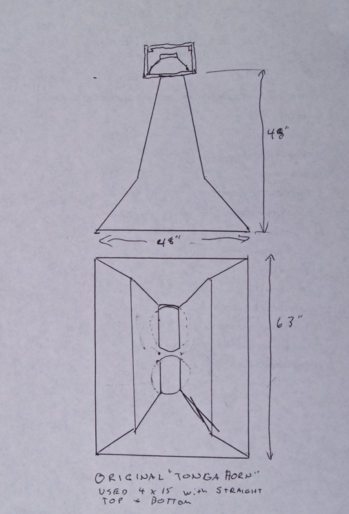

6C) In the mid 1980's I designed a large straight horn system that was built by a former employee for a free concert provided by the Minneapolis based group "The Jets" on the island of Tonga. I now like to take advantage of travel opportunities myself whenever possible, so my design experience may take me to your property some day.
