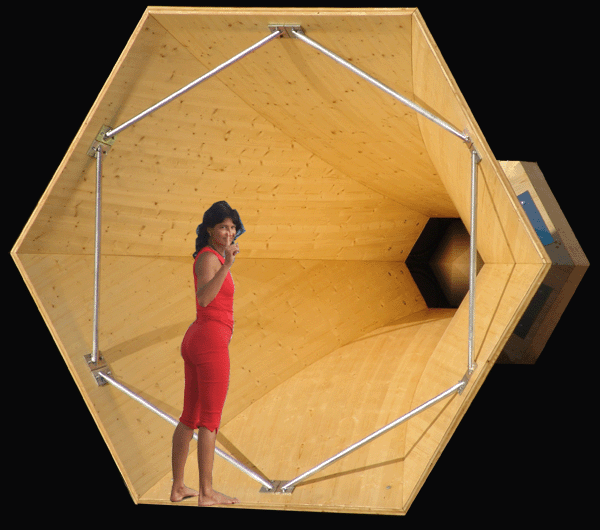

There a quite a few others who have gone to extremes in the name of bass reproduction: here is one more:
REALHORNS - Ultimative High-End Surround Hornlautsprecher

Hi Entropy455,
Post #25: "TB46, those are some pretty clean looking horns. Do you know what the lower cutoff frequency is? Or other design specifications? (I can only read English)..."
I had Google Chrome translate it for me, that seems to work. They have some diagrams under 'Produktion', and a lot more pictures throughout their site. There seem to be some interesting ideas as to the coupling of multiple drivers into the bass horn throat chamber, and water cooled drivers. But not a lot of details. 🙂
They also have a facebook page.
