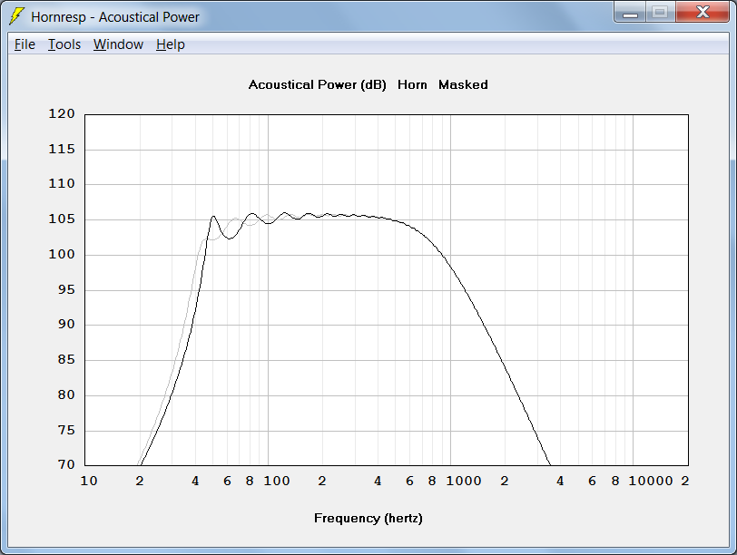

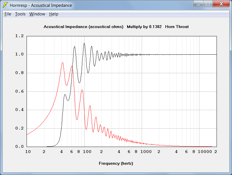

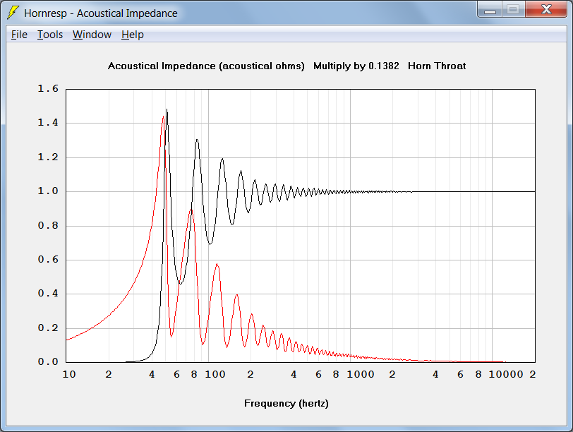

A much more simple test would be to take any small sub (let's say an 8 inch sub in a small sealed box) and put it up in the air. And MEASURE it. Then put in on the ground and MEASURE it. There will be a very significant difference.
If you want to see the effects of diffraction (boundary reflection) in action in a sim (which is a whole lot easier than any experiment and just as valid) just download a diffraction simultator. A couple of good ones are "The Edge" and Bagby's "Diffraction and Boundary Simulator".
I recommend the second, as it shows diffraction effects of a baffle AND from nearby reflective surfaces. It assumes infinitely rigid baffles and boundaries, but you can clearly see that the effect is like a mirror - perfect reinforcement based on boundary loading (which is relative to size, distance and frequency) in addition to notches in response related to sound source distance to boundary.
Like I said, these simple sims are just as relevant as physical experiments and take a lot less time and effort. And sims WILL match measurements if you do an accurate sim and measure what you simulated accurately.

Your proposed experiment is flawed in several ways. First, you need to measure. Forget trying to critically listen to a horn 26 feet in the air and then a different horn on the ground. It's impossible to judge this by ear for several reasons, not the least of which is that auditory memory is very fickle and fleeting. A mic will be a much better judge.

However, what exactly is being compromised when I cut the mouth of my bass horn in half???
If the horn flare rate and throat area are held constant and the mouth area is reduced by shortening the horn axial length, the ripples in the throat acoustical impedance will become larger, and further apart, as shown in the attached examples (2 Pi radiation assumed in each case).
Attachment 1:
S1 =300
S2 =50000
L12 (Exp) = 360
F12 = 38.90 Hz
Attachment 2:
S1 =300
S2 =25000
L12 (Exp) = 311.24
F12 = 38.90 Hz
Attachment 3 compares the power responses of the two horns - the black trace shows the response with the mouth area halved.
There is nothing special about a horn that has a mouth circumference equal to one cutoff frequency wavelength, it is just a convenient arbitrary value to use. For a given flare rate and throat size, the larger the mouth the smoother the overall response. Cir = 1 is often used in horn design simply because it is a reasonable compromise between size and performance. It could perhaps be considered an "optimum" value for that reason, but not for the reason given by Don Keele.
