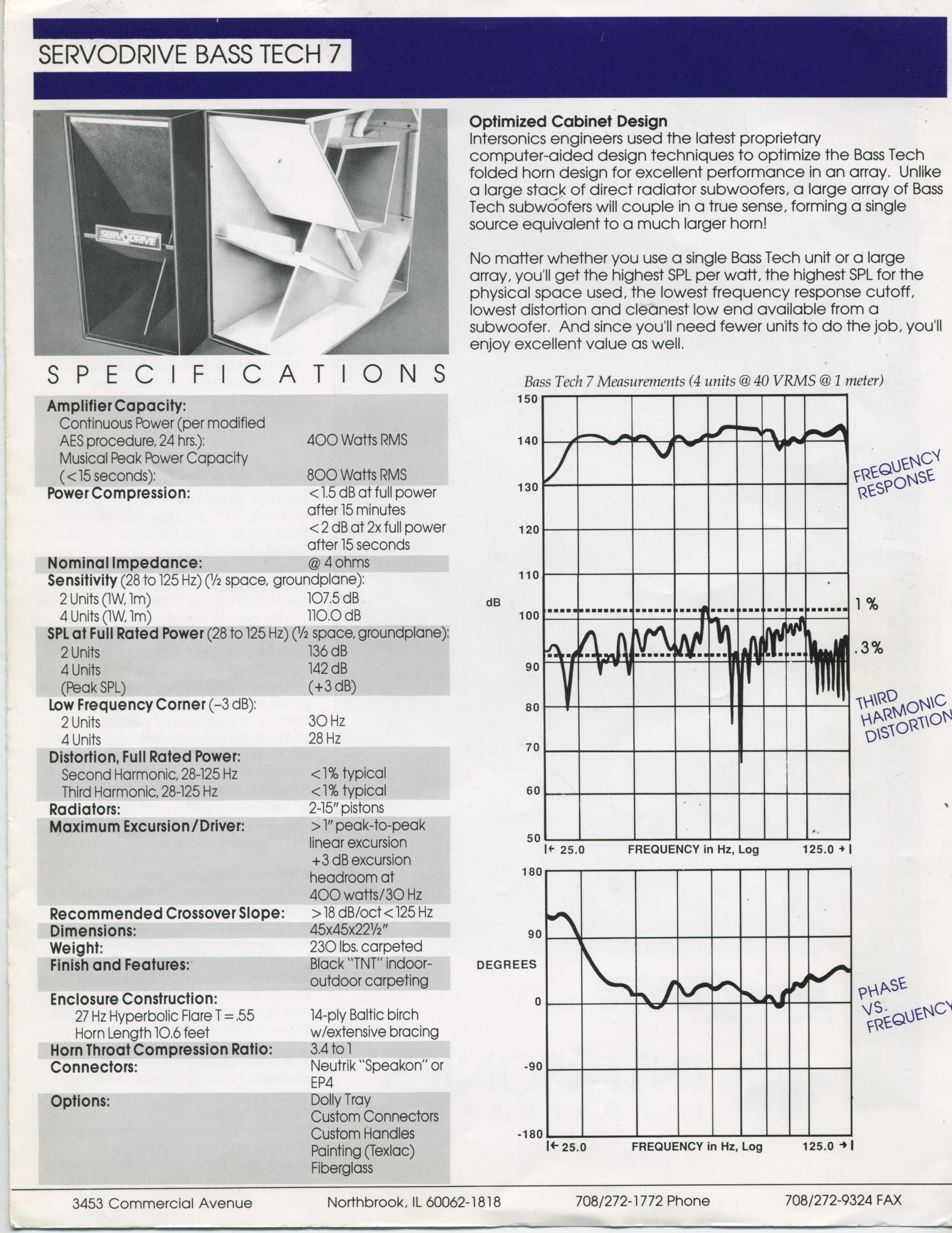

Tom Danley simply reproduced his SDL BT7 design from the mid-1980s as the LABhorn, after he had determined one could get a lot more "bang for the buck" using "tapped horns". There are good business reasons he "gave away" the LABhorn design, but has not been quite so generous with revealing the TH designs.
The BT7 was an upgraded version of the BT5, which was a redux of Cerwin Vega's original 1970's Earthquake folded horn, which were based on centuries old horn knowledge.
I have a great amount of respect for your input on these matters, you were on the scene as all this was going down and actually had personal communications with Danley over the years. Your own personal experience in the field makes you a historically relevant figure whereas I didn't even have my own dial up internet connection until 2006 when I started to sporadically semi seriously study enclosure design. As such I don't want to insult you and I also don't know how far you want to get into the details of history the science of tapped horn vs other alignments but some of this is wrong and some needs major clarifications.
1. When Danley was creating the Labhorn he wasn't simply reproducing anything. It's true that he recycled concepts that he had used previously and that horn design math was around long before any of us but the Labhorn was a new implementation.
The Labhorn design notes I have don't start from the beginning. Danley even notes that it had been a long road in the first of the notes that I have, he was already folding the horn and the prototype driver had already been built, so the notes I have are from the tail end of the project.
Regardless even with what I have, you can see that the Labhorn was designed from the ground up, not a reproduction. If I had notes that went back to the beginning of the process I can almost guarantee that he used Leach's math to design the driver and the horn, as he has talked about Leach's horn model extensively in the past. Here's what I have though, this is the horn spec after simulation and tweaking of the theoretical ideal.

1.You should be able to see from the reprint I posted that the BT7 is the same physical size as the LABhorn, and it's spiral fold is virtually the same as the LABhorn.
The enclosure dimensions have more to do with truck pack dimensions than anything else. Almost everything produced for live sound strives to have dimensions divisible by 22.5 inches. And a common horn size for designs using 1000 - 1200 sq cm of Sd is a Labhorn size enclosure. Sticking to truck pack dimensions, if you made it smaller (decreased any dimension by 22.5 inches) it would be too small to work well and if you made it bigger it would be hard to physically handle. So it's hardly surprising the dimensions are the same in the Labhorn and BT7, it would be weird if they weren't.
The fold being the same also isn't surprising, based on the required path shape and length the snailshell fold is one of the best options.
And since the physics and math of horn design haven't changed it's not odd that they would have similar physical characteristics and dimensions for the horn flare.
None of this negates the fact that the Labhorn was designed with theory and math from the ground up to be a unique design. The fact that it resembles his own prior work just proves that form follows function and horn math and theory didn't change in the short period between the design of those two subs.
If by reproduction you simply mean that they are both horns and that they have the same physical dimensions and snailshell fold, then this is valid. But I would consider a reproduction to be more like sticking different drivers in the same old horn - that's not what happened.
