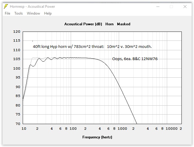

More pondering on the horn subwoofer
Hi Entropy455,
Post #202: "...mouth is under 12 feet square. These are dinky horns compared to what I was originally planning to build (i.e. full-space horns). I’m a happy about this...
Question: Should I drop the tune down to 18 Hz... or should I just stick with my original 20 Hz goal?"
I'm just messing around in Hornresp w/ a fixed length (40ft long Hyp) subwoofer horn w/ different throat/mouth/chamber sizes. From this, I would stay w/ the single horn, and just increase the mouth to the point I'm comfortable constructing. The larger the mouth (for a given chamber/throat/length) the lower the ripple.
Somewhere around 25m^2 I hit the point of diminishing returns w/ a 4:1 compression ration (I think that's a lot of compression.)
I recommend you go w/ a single horn, and determine the horn flare, etc. from the construction viewpoint. The radius for a 50m^2 horn mouth is 5.64m[18.51ft], and for a 10m^2 mouth it would be 2.52m[8.28ft].

Question: if I go with a single mono bass horn, how exactly do I go about getting my mono signal? I primarily listen to CD recordings.
I was hoping to keep the audio signal(s) in the digital domain, as long as possible. Specifically, I’d like to find a high-end (or otherwise capable) computer sound card that has an all-in-one adjustable multi-channel active crossover (digital), as well as a multi-channel time-delay feature (digital). Some of the newer amplifiers have D/A converters built right into them – and I’d be willing to pick up some of these amps if necessary.
I’ve currently got a really nice analog crossover that sounds great. However the only adjustable time-delay devices I've found (to properly time my horns) are digital. It has been my experience that whenever analog signals are converted to digital for processing, then converted back to analog – the system fidelity suffers (compounding errors).
Ummm, while some folks is running off playing with their sims late at night to three decimal places, you're still at Stage One in system design.... as you should be.
In short, you get a Behringer DCX2496, like a whole lot of those on DiYaudio. It does the rest beautifully. My system is likewise mostly digital. You can feed the Behringer with an AES coax digital signal from an inexpensive USB device ("Breeze" on eBay is one such) and thereby avoid slipping into analog between the computer and the Behringer downstream digital stage.
A mixed bass is simply L and R added together, not that there are many sources where they differ in the low bass and if they do, probably was simple-minded of the engineer to do so. And if they differ, certainly just cooked up on the recording console, not authentically spatial. (There are some people who say it is better bass to have distinctive sub signals, but a lot of reasons not to such as building two horns and two amps.)
As I said before, you need to sort out system design (including considering your room) before fussing over horn mouth size.
Ben
