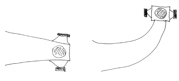

For a horn to use multiple drivers, there will have to be some compromise. For a simple arrangement, using a quad of drivers, all equally distant from the mouth:
a) If the horn is straight, two drivers will be vertical, so their cones will sag.
b) If all drivers are to be horizontal, the horn would need a 90-degree curve.
I imagine both effects are only small deviations from the ideal, and a) has probably been better quantified than b).
Personally, I'd be tempted to go with b) because it would have other benefits, such as making it easier to build the driver & throat section separate to the horn body, and then lower it on when done.
Doesn't matter, you can visually inspect the spider after a few months. If there is any sag just switch the 2 vertical drivers so they can sag back in the other direction.
That curve you are showing would have no effect at all at subwoofer frequencies. You could fold the horn up with a dozen 180 degree bends and the effect would be minimal at subwoofer frequencies. In fact it might even be beneficial, as the bends filter out higher frequency garbage.
A third option, option C, would be to do a diamond shape, then none of the drivers are horizontal or vertical, they are all on an angle.
A fourth option, option D, would be not to worry about it. If OP uses the drivers we've been talking about they probably won't have to much issues with sag. The cones are very light and the suspension is probably pretty stiff. I'd have to look at the t/s again to verify the suspension stiffness but it's probably pretty stiff.

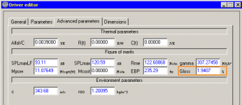

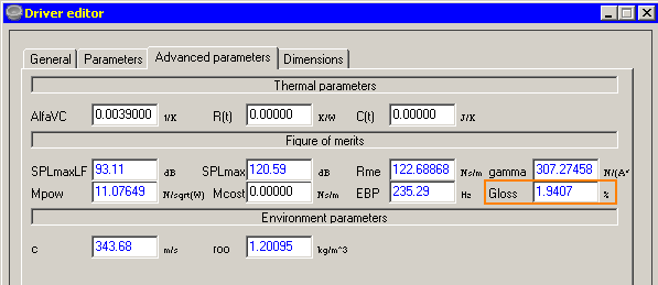

Re - Driver Sag
WinISD can estimate DS = Gloss. From the helpfile
Eg - B&C 12NW76, Go to, Driver Editor/Advanced Parameters

Re - Driver Sag
Gloss
Gloss tells how many percent of Xmax driver cone will sag, if driver is mounted horizontally. This figure is only approximate, because surrounding air shifts resonance frequency to somewhat lower value. So result is somewhat over-pessimistic by some amount. Generally, figures of more than five percent tell you that driver in question shouldn't be mounted horizontally. Value of gravity acceleration used when calculating sag is 9.80665 m/s². LinearTeam
