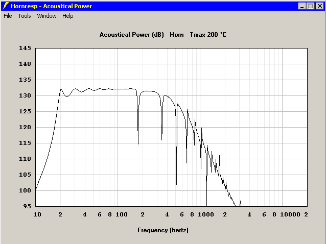

Well i had a tinker & managed to get this so far. See my att HR record
I expect it's screwed up in various places 🙁
But i have to say, HR drives me crazy having to constantly alternate between different single view only screens to see what's happening. And then finding out it's not what i was trying to acheive, so it goes back & forth etc etc ! Obviously you & some others don't seem to find it an issue, but i do & i'm sure others do too.
If you could att your HRR that ports into the horn, i might then be able to try & comprehend what's what.
In the HR help file it lists in LOUDSPEAKER MODELS - Horn-Loaded Vented-Box Enclosure With Port Exit Located Inside Horn Mouth - as an option, but i don't see it in the Driver Arrangement box ?

I already showed you all you need to know, the inputs for the sim with the chamber ported into the horn throat.
Horn-Loaded Vented-Box Enclosure With Port Exit Located Inside Horn Mouth is not an option you can chose, if you read the Help file you will see that you "trick" the program into simulating this kind of thing by using a TH setting with a flh, and then fill in Ap and Lpt, this will port the chamber into the horn mouth.
The extra step that I did was because I didn't want it ported into the horn mouth, I wanted it ported into the throat. So in that case you have to set up it up so S1 - S3 are all very short, they need to be there so a TH sim will run. Then you can define the horn flare with what's left, S4 and S5. But in this case, since the horn mouth was larger than 99999.99 and S4 can't be that size but S5 can, I had to waste S4 as a very short segment too.
Anyway, if you just use my inputs and look at the schematic, then change things one item at a time and continue to look at the schematic you will see how it all works.

When I did a sim for the horn I linked to, post 201, it looked very good. To me, it therefore looked like you, JAG, were wrong. However, rather than concede anything on this, you argued some more. To 'support' your refusal to concede, you wrote several things (quoted below, from post 210) that were flatly the opposite of the underlying info that I used for the sim - and which I've also quoted, in the list below.
The sim you did had nothing at all to do with the reality of what was built. How could I possibly concede?

Hollowboy pretty much hit all the points in post # 290 ...
Hollowboy's elaborate post is a very detailed description of his own unwillingness to evaluate the burning man horn in an accurate technical manner, leading to his disappointment in being called wrong. And he was spectacularly wrong.
2) I don't agree that a simulator is "as good as a measurement mic" ...
For proving points of theory a simulator is arguably better than a mic. Especially at low signal levels, which is where most theory is discussed.

1) Whether a horn is exactly exponential, or a rough approximation of exponential makes very little difference in it's measured response, assuming it is reasonably well braced for the power used.
Small differences in horn flare make small differences in the horn's behavior. Very obviously large changes in the horn flare are going to make large differences in the horn's behavior. The designer pretty much said that he just built something that looked exponential, the reality is that if you do that by eye it's very likely not going to be even close. If you read between the lines and consider the fact that he didn't even bother to measure the horn length accurately, you can get an understanding of how far from the design plans the actual horn ended up being.
2) Yes, the response would be different whether ported or not, though in straight horns of this size it makes little difference due to the distance between the port's output, external to the horn, having little relative contribution to the overall SPL, and that contribution is diminished further by the inverse distance losses in front of the long horn.
The old truck width RCA "W" bins had the 15" drivers open air, and still had solid response down to 40 Hz, in spite of the open drivers being only 30" from the horn exit.
If you had bothered to look closely at the ported rear chamber horn sims I provided you would see that the addition of the ported rear chamber is not the only thing that changes when you add that port. The output from the horn itself changes too, and in very bad ways if you don't do it just right. You can royally screw up a good design by deciding to stick a port in the rear chamber without any idea of what's going to happen.

Yes, of course. But in this case there's a very small picture of a horn in the desert. You can't accurately determine the shape of the horn flare, the horn length, the size of the rear chamber or even what's going on with the port in the rear chamber. There's no way to get even a reasonable sim of this horn because the details are just not there.
4) I have not looked at your picture, have only seen one photo of the horn, as the throat was not visible, impossible to tell exactly the exit size or shape.
You saw the picture, although I don't doubt that you didn't actually look at it. You seem to be ignoring a lot in this discussion. It's very unlikely (almost inconceivable) that the compression ratio is 1:1. It's simply not likely due to the way it was built.
