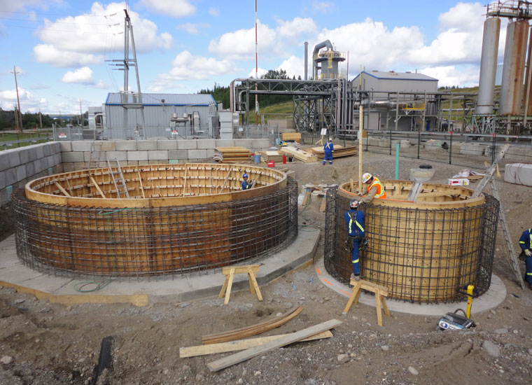

Casting is not the only option. I used to work on large concrete water tanks, building them on-site (regional Australia). We'd:
1) pour the bases (a disc of rebar + a truckload of concrete)
2) set up a temporary form for the walls
3) corset the form with rebar
4) plaster the outside
5) remove and clean the form
6) plaster the inside
...thus creating walls only a few cm thick that would hold many tons of water. All the strength was in the steel. The concrete just filled in the gaps. I couldn't find a photo that matches exactly this method, but have attached one that is similar.
Doing it this way would be a trade-off, turning form-building labour into plastering labour. Costs and planning would be easier: you could make a relatively small amount of formwork, then move it from place to place.
For tight curves at the throat, you wouldn't need any formwork: you could cover the rebar frame with something finer (e.g. a roll of vermin mesh), and plaster directly onto it. You'd need a small mixer and hand tools rather than a truck, and you could make any shape that you can bend the rebar into.
I really don’t want to screw this up. . . . If I cast a mistake into my horns, there probably won’t be a second attempt. .. .
The full-sized thing is more important that the exact shape. Within reason, different profiles are pretty close in performance, if the size is right. Most design wrangling, most of the time, is to maximise performance from a particular size and weight.
