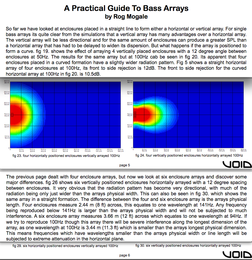

Eric is still posting drawings with his multiple subs in a horizontal array, diametrically opposed to the advice he supposedly took from Void, not realizing he has inverted what Rog suggested.
Four "horizontally positioned enclosures vertically arrayed" is the taller "line array" (technically a vertical array) configuration which has a wide beam-width.
Four "vertically positioned enclosures horizontally", as Eric has been doggedly clinging to like a chew toy since the troll told him what he should be dooing, is the wider side by side configuration with the "bad" comb filtering..
Constantly saying I’m doing it wrong, isn’t exactly helping me to do it right. . . . If you’ve got a better idea, why not post a sketch - and clearly convey your design recommendation?

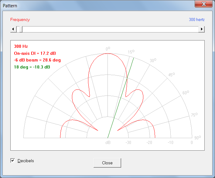

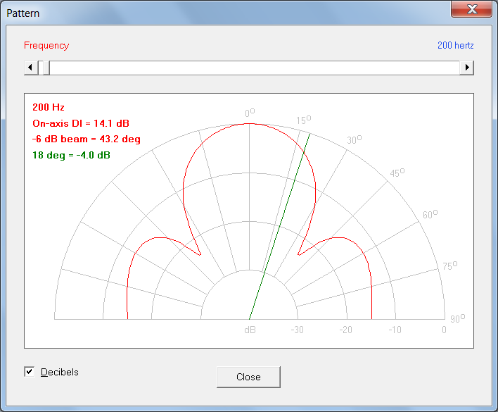

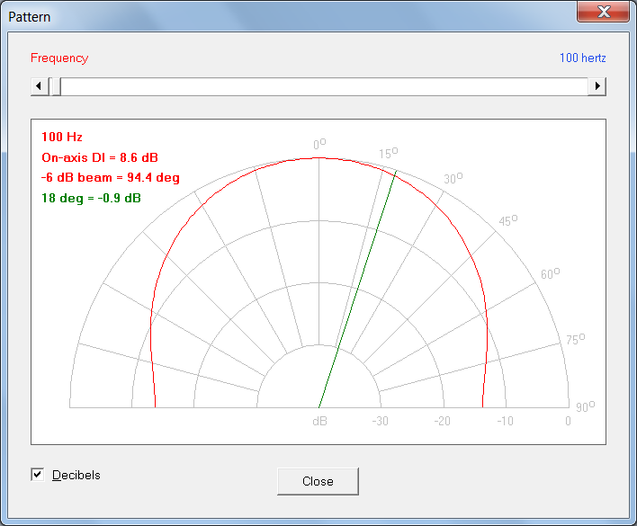

Hi Bill,
So long as the radiation pattern is uniform over the coverage angle for the frequencies of interest, a small toe-out makes no difference.
Another good reason to limit the frequency range of the bass horn system to no more than three octaves (15Hz to 120Hz), and preferably even less :).
The attachments show the predicted horizontal directivity patterns for the "conical" horns at frequencies of 100Hz, 200Hz and 300Hz. With the proposed three horn system, the listener is in effect positioned 18 degrees off the axis of each of the outer horns. As I understand it, the actual listening position will be in the near-field not the far-field. Not sure if that makes things better or worse :).
The system the OP plans on building when completed will be an acoustic first. As far as I know, no-one has built a horn system this large before, particularly out of concrete.
That's what makes this project so interesting and exciting - for me at least :).

1)The attachments show the predicted horizontal directivity patterns for the "conical" horns at frequencies of 100Hz, 200Hz and 300Hz. With the proposed three horn system, the listener is in effect positioned 18 degrees off the axis of each of the outer horns.
2)As I understand it, the actual listening position will be in the near-field not the far-field. Not sure if that makes things better or worse :).
David,
1)I have not been able to keep up with all Eric's posts, but don't recall him mentioning using a "conical" horn expansion, other than his "Dunce Hat" reference.
Did he change his mind about using "exponential" bass horns?
2) The low frequency near-field surrounding a bass horn is a round "bubble" approximately the diameter of the horn mouth, but the size of the bubble is frequency dependent, the "beamy" upper frequencies transition from near-field to far-field after exiting the horn mouth, while the transition from near-field to far-field for a 15 foot diameter horn would be around 75 Hz.
Therefore, at any distance less than 75 Hz, the sound field surrounding a single 15 foot diameter horn would not be uniform.
Any three-horn system that does not use a single driver source location will have gross frequency dependent non-uniformity of response depending on the frequency and center to center distance of both throat and mouth, and to complicate (or ruin) the polar pattern more, the designer must also consider the prior two paragraphs.

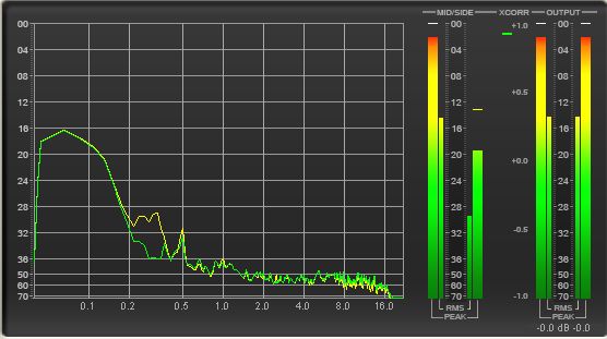

Stereo Bass ???
Who needs it ?
I thought i'd post a screenie of a section of a frequency analysis i did today of Jill Scott - A Long Walk.wav
The whole track didn't vary that much all the way through. As you can see, below 150Hz it's totally Mono ! I tried various other tracks from her & different artists, & the result wasn't a lot different, especially below 100Hz.
As you're main goal is music, you won't miss aircraft/trains etc etc, being panned from L-R & R-L, i would have thought ;)
