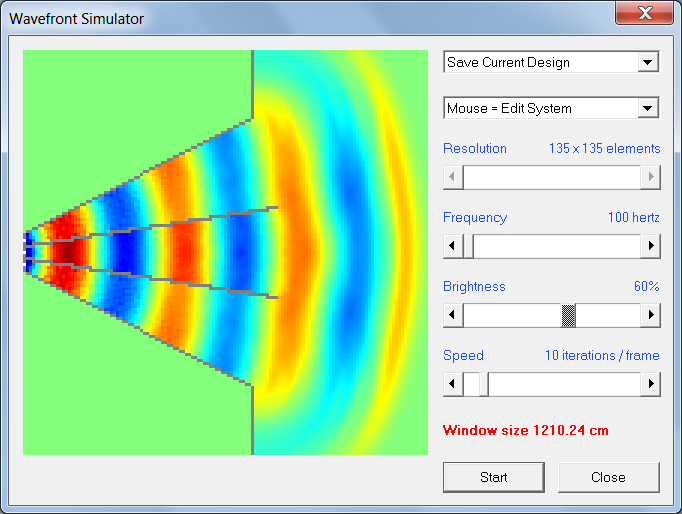

I am using four radially dispersed straight stem walls in the vertical plane
I’ll have parallel horn walls at X = 125
Horn duct height is approximately 45 cm at X = 125.
45 cm is half a wavelength at around 380 Hz.
What exactly are we looking at here? It looks like three horns, with the throats converging to a common vicinity - resulting in a convex curvature of the horn mouths. This seems to produce a pretty nice combined wave front – and happens to be the exact opposite of “toe-in” (heh weltersys?) Page 7 of the below link, also supports a convex horn configuration. . . .

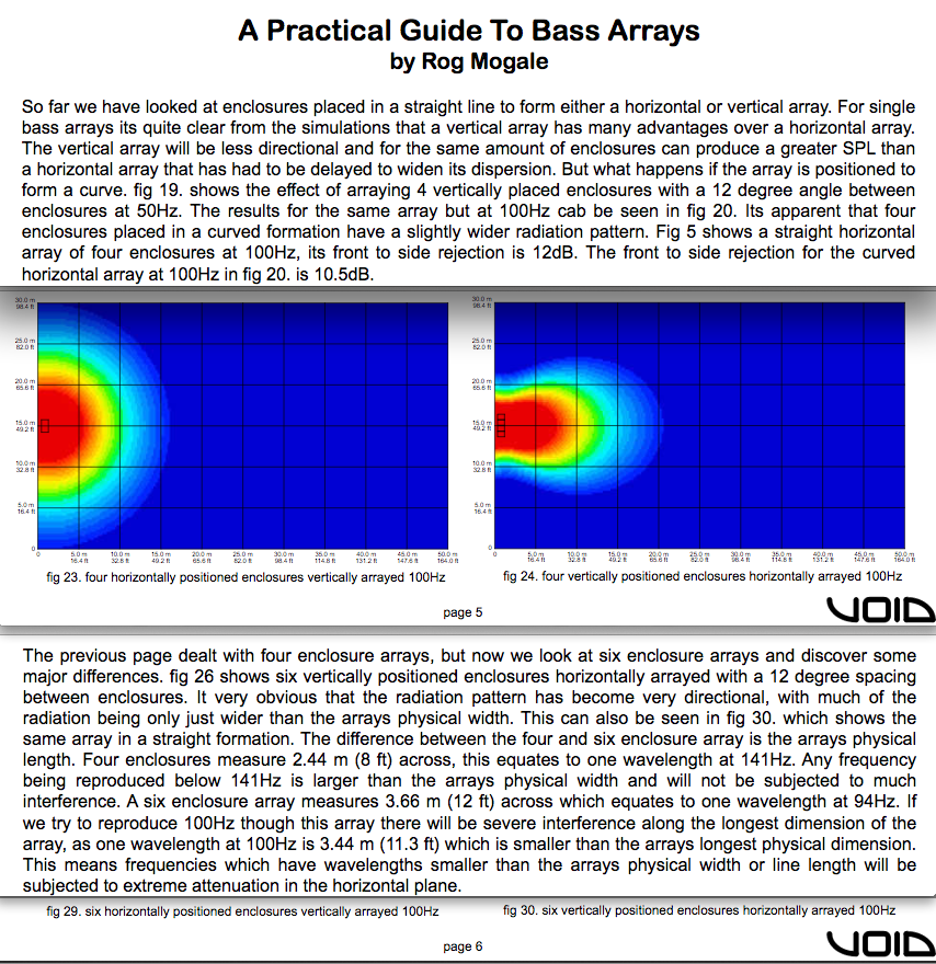

http://www.voidaudio.pl/attachments/article/147/A Practical Guide To Bass Arrays (angielski).pdf
And the convex wall clearly produces a better wave front than a straight wall. . . .
So the real question is, if a convex wall is good for three horns, will it also be good for four horns??? I must admit, I like the idea of having all four horn throats in near vicinity to each other - it means I only need to build a small outbuilding behind the horns. . . Perhaps I can use conical (straight) vertical walls, and incorporate a curved exponential profile into both the horn floor, and the horn overhead. Hmmmm . . . . .
1) Rog Mogale clearly states on page 5 of his "Practical Guide To Bass Arrays":Void Audio's Practical Guide To Bass Arrays by Rog Mogale
(1) Page 5 & Page 6 of the above link clearly show that your recommendation to toe in my horns, was in fact a bad recommendation.
(2) Comparing page 16 with page 8 of the above link, clearly shows that side-by-side placement of LF audio sources will minimize comb filtering, and not maximize it. I can only assume (seeing as you claim to be a sound-reinforcement professional) that you’re intentionally trying to mislead me - again – simply because I refuse to pay you a consultant fee - for your input on a DIY audio website. . . .
3)I ask about horn placement, and you ask me the color of my mustang??? (If you'd been paying attention to post #765, you’d already know. . . .)
4)A more relevant question would be to ask whether or not I’m going to add a coloring agent to the concrete mix. A really dark brick-red would be cool for the horns, with an a grayish-black for the retaining wall. . .
5)Seriously weltersys - either contribute to this thread in a constructive fashion, or please go away. . . .

"So far we have looked at enclosures placed in a straight line to form either a horizontal or vertical array .For single bass arrays it's quite clear from the simulations that a vertical array has many advantages over a horizontal array.
The vertical array will be less directional and for the same amount of enclosures can produce a greater SPL than a horizontal array that has had to be delayed to widen it's dispersion."
Rog's page's 5 and 6 of his "Practical Guide To Bass Arrays" is in complete agreement of every bit of advice I have given you.
This is not Rog nor my "first rodeo" in the horny world of "Bass Arrays" and if you take off your asshat and put on the "dunce cap", sit in the corner and read his practical guide rather than let your "inner troll" advise you, you might actually start to learn something, rather than posture your cement thoughts endlessly across the universal chasm of knowledge and ignorance of it.
Eric, you are obviously able to read and write, when you show some comprehension skills, we might carry on a meaningful dialog, rather than your ignorance of the factual information you cited from Rog Mogale.
Rog is much more used to dealing with the behavior of his primary chosen cliental, dance clubs, and the "DJs" that are the "talent" in said dance clubs that used to be referred to as "Discotheques", or "Discos" for short, back in the age when DJs did more than hit "play" on a setlist they prepared before showing up, and then proceed to masturbate or collect the money while the "Disco" turns around, generation after generational loss.
On the other hand, the hand that holds our "collective soul", I prefer dealing with live bands that can "shake that thing" and make us "feel alright", like Ray Charles or the Red Hot Chili Peppers, who used to perform with nothing but their socks covering their Red Hot Chili Peppers on their encores, and engineers like Dave Rat, who has mixed them since those halcyon days that your "20Hz Concrete Bass Horn Design Question" post made me recall.
I was trying to illustrate one advantage of using Bill's suggested layout. In theory, the isophase wavefronts leaving the three horn mouths will be entirely coherent. The slight differences shown in the simulation results are due to the three sources being aligned in the same plane. In reality, the drivers in the two outer horns would be normal to their horn axes, resulting in perfectly coherent combined wavefronts being generated by the three horn system at low frequencies where beaming is not a factor.
That's what I was hoping to demonstrate 🙂.
Even better, I suspect 🙂.
For one thing, the frequency at which beaming becomes an issue should be higher.
Note however, that with Bill's proposal the two stereo signals are in effect being directed slightly "outwards" from the on-axis listening position. Art's alternative "toe-in" proposal avoids this.
Decisions, decisions...
Kind regards,
David
