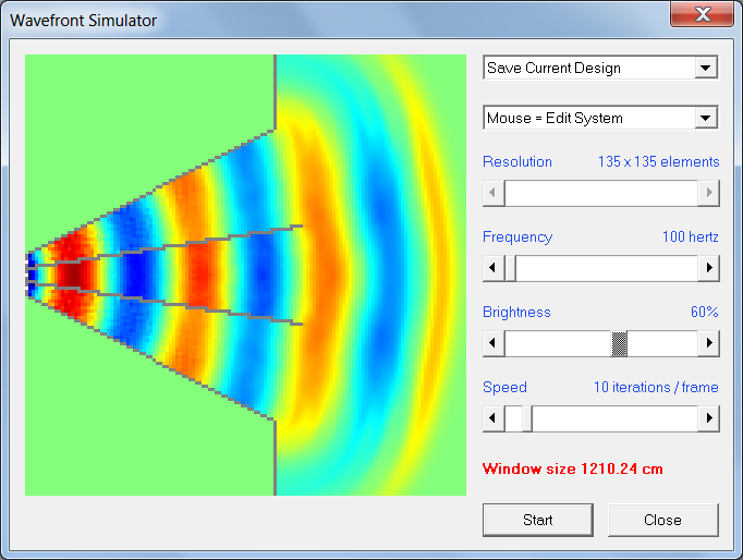

What exactly are we looking at here? It looks like three horns, with the throats converging to a common vicinity - resulting in a convex curvature of the horn mouths. This seems to produce a pretty nice combined wave front – and happens to be the exact opposite of “toe-in” (heh weltersys?) Page 7 of the below link, also supports a convex horn configuration. . . .
http://www.voidaudio.pl/attachments/article/147/A Practical Guide To Bass Arrays (angielski).pdf
And the convex wall clearly produces a better wave front than a straight wall. . . .
So the real question is, if a convex wall is good for three horns, will it also be good for four horns??? I must admit, I like the idea of having all four horn throats in near vicinity to each other - it means I only need to build a small outbuilding behind the horns. . . Perhaps I can use conical (straight) vertical walls, and incorporate a curved exponential profile into both the horn floor, and the horn overhead. Hmmmm . . . . .

Hi Entropy455,

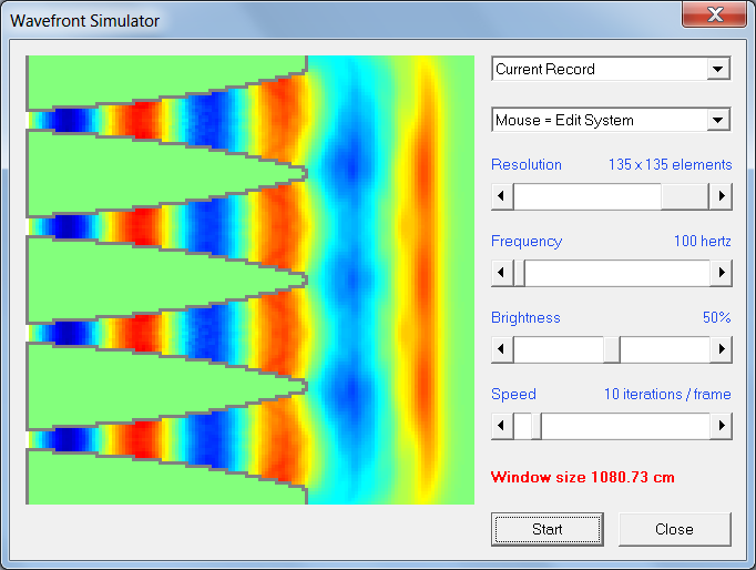

I was trying to illustrate one advantage of using Bill's suggested layout. In theory, the isophase wavefronts leaving the three horn mouths will be entirely coherent. The slight differences shown in the simulation results are due to the three sources being aligned in the same plane. In reality, the drivers in the two outer horns would be normal to their horn axes, resulting in perfectly coherent combined wavefronts being generated by the three horn system at low frequencies where beaming is not a factor.
That's what I was hoping to demonstrate 🙂.
Even better, I suspect 🙂.
For one thing, the frequency at which beaming becomes an issue should be higher.
Note however, that with Bill's proposal the two stereo signals are in effect being directed slightly "outwards" from the on-axis listening position. Art's alternative "toe-in" proposal avoids this.
Decisions, decisions...
Kind regards,
David
