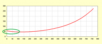

I think he means something like this? I must admit, a flat bottom with straight side-walls would be VERY easy to cast. However the top of the horn is going to be a serious pain. If I am to incorporate a flat surface (for ease of construction), ideally it would be the top of the horn - as the top of the horn is a reinforced slab in bending-tension, simply supported on ends (in other words, the top of the horn must be cast thick, and with lots of rebar). . . . I look forward to seeing his design proposal nonetheless. . . .

Post #1040: "Quote by David McBean: ... this means that the initial roof flare near the throat will be negative...", and "see sketch"
David is indicating that to maintain the proper area expansion w/ straight sides (top view) the top of the horn will initially slope downwards, not upwards as in your sketch.
Exactly this. You asked (in post 149) and were advised to use a flat bottom, but until now, none of your sketches reflected this.
I think what you have drawn in 1040 (or similar) would be the way to go.
Rather than have the walls conical all the way, I'd make the walls expo for the first metre or two, and then conical for the mouth, so that the initial roof flare near the throat will not be negative. To me, that goose-necking seems bad (but maybe my intuition is wrong, and it has no actual penalty).
A side benefit of a flat base (or near-flat; I'd use a very slight incline for drainage) would be that you could easily roll the main boxes in and out on something like a garage creeper: position them in front of the horns for listening sessions, and roll them into the horns the rest of the time.

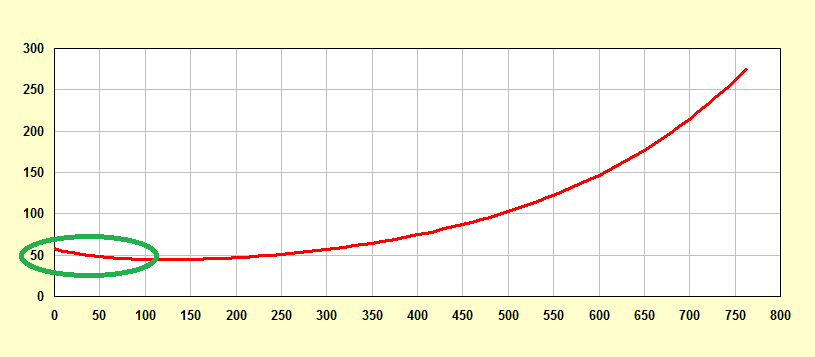

Note that when I sim a bad version of the linked horn (a crude conical approximation of the flare, halving the box size and doubling throat area), the sims stay within 2dB of the 'ideal' version. This is much less than the normal in-room bass variation you get from standing up or changing seats. ....thus even a quick & dirty build should give you a fair taste of what a bigger, better version could deliver.
As shown in the attachment.
Bill proposes a throat adaptor transition in this region, so it should not be an issue in practice.

As shown in the attachment. Bill proposes a throat adaptor transition in this region, so it should not be an issue in practice.
I busted out the graphing calculator, and sure enough - there's some concavity in the roof of the horn near the throat, when using a flat bottom (ground-plane) joined with two tapered flat-straight walls.

18)I busted out the graphing calculator, and sure enough - there's some concavity in the roof of the horn near the throat, when using a flat bottom (ground-plane) joined with two tapered flat-straight walls.
Question - what am I sacrificing if I do this?
Nothing AFAIK if done correctly as this RCA horn [AKA the 'Ubangi'] was done and referenced earlier by Art:
The biggest potential issue I see with building the below horn (with the top wall actually having a slightly concave shape as shown above), is that I'll have two approximately parallel horn walls from X=50 to X=200. One thing practically every horn design reference has in common, is that parallel surfaces inside a horn are bad. . . .
