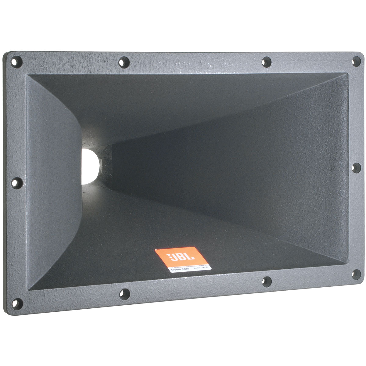

Based on smaller horns, I think a flat base should be fine; at 10x the cutoff frequency of the horn, the sound 'beam' will still be at least as wide as the angle of the horn walls.
e.g. this JBL unit is a midrange horn with approximately the shape you are proposing - almost all the curve is in the side walls, the top and bottom are very close to being flat & 20 degrees is the nominal vertical angle.
https://www.jblpro.com/pages/pub/components/2386.pdf
At 4kHz - 10x the horn's cutoff frequency - the vertical beamwidth is still 25 degrees.
Why not make a rough pair of 1/10 scale 150Hz horns from scrap ply (or even a few layers of cardboard) to test this for yourself?
A mic at 5m should give you far field info for your full-scale build.
I got curious, and made a mock-up myself, using scrap ply to build up the 'floor plane' and a horn like the 2386, at different angles to that floor plane; basically a 1/30th scale model of what you're proposing

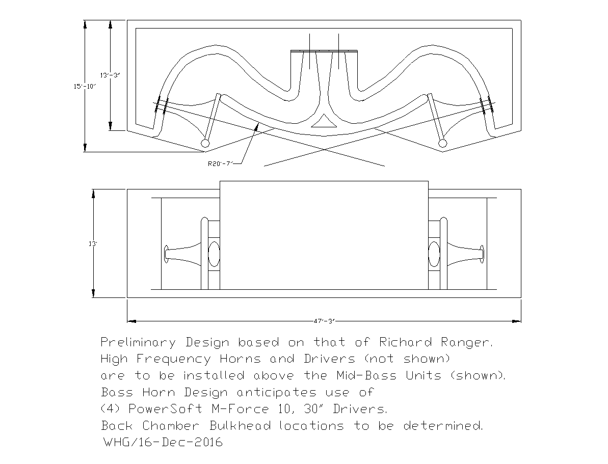

WHG
Wise?
For Project Extraordinaire, wise is not an applicable notion.
This is Disneyland stuff without the commercial incentives built-in.
Note that structures this size come with acoustics of their own that cannot be fully appreciated or evaluated outside the realm of the designer's imagination, until built.
When built, no matter what design specifics are chosen for the bass horn(s), the acoustic and visual impact will remain primarily the result of scale only.
Integration with the rest in a manner necessary to present a coherent acoustic image is where the action is.
RR's design will do this in a way unavailable to other system configurations, while also delivering a structure with an aesthetic visual appeal and extreme seismic resistance.
That is why it is being presented here as a option worthy of consideration.

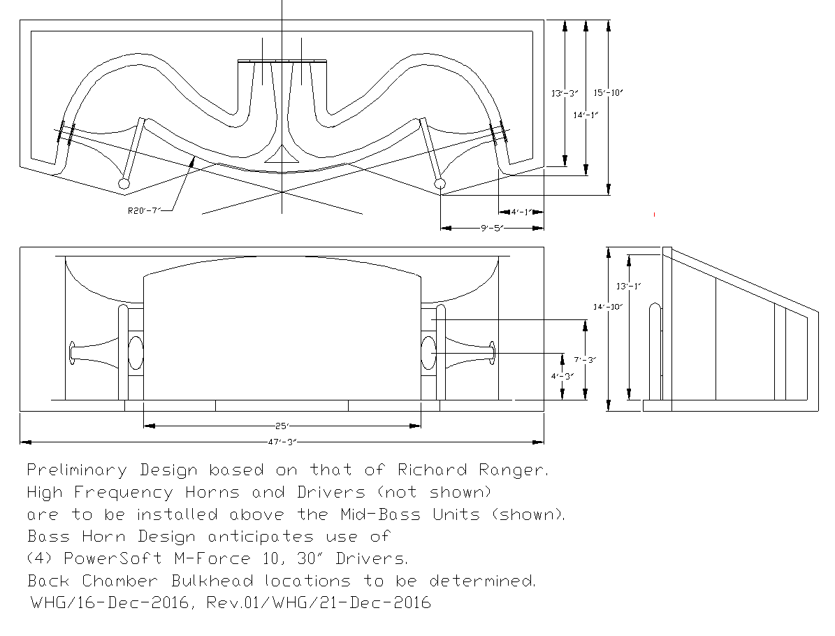

Megagon Rev.01
Still working on it when spare time permits. WHG
See attach drawing and related patent for details.
WHG
