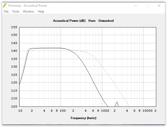

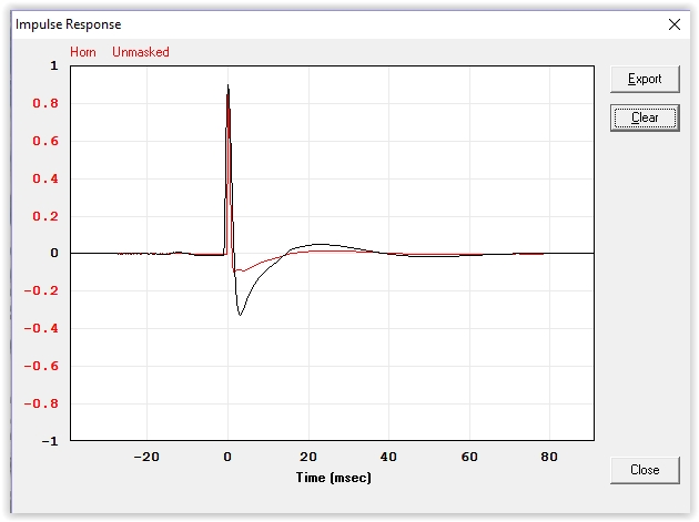

I did a little comparison between the 18SW115 and the 12NW76 on similar horns using the '10ft x 21.5ft' mouth you earlier suggested. I'm pretty sure the same holds true for the latest greatest... A common 10ft x 21.5ft (or so) mouth looks like it would be plenty big to reach to 20Hz (15Hz cut-off). I would probably use 4 long throat/inital horn sections combining into a common final/mouth section. Looks like w/ about a 16ft break point between the throat and mouth sections you could arrive @ 8ft height @ 16', and then gently taper your height to 10ft @ the mouth, using the width for majority of the mouth expansion... I also would use Hornresp Hyp to calculate the flare, and would not exceed a 4:1 compression ratio.
It's interesting, that you need 16x12" v. 4x18" to arrive at similar SPL (looks like I used Xvar for the 12", and Xmax for the 18", so you might even need more 12"); the 12"s have much wider high end extension, and an improved impulse response, maybe that's what you are hearing when comparing these. I cannot hear a difference between 12" and 18" subwoofers of equal quality, in an appropriate enclosure, with the correct bandpass filter, but then I'm old. 🙂

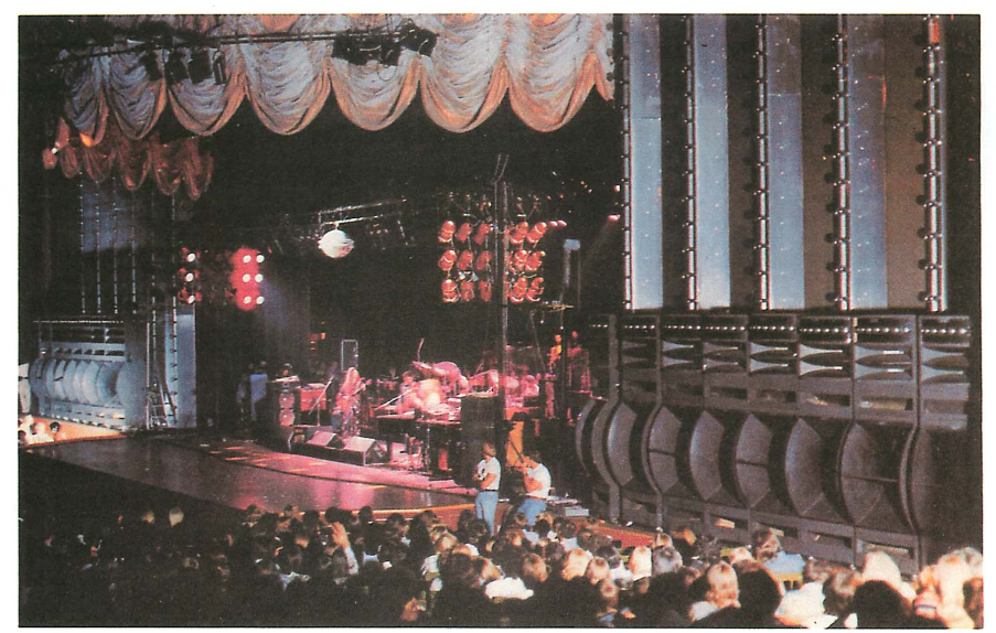

Taking a broader look at horrid 1970s system he described we have this -
"... 2x15" bass section, and two dual driver JBL radial horns topped by an arc of "Bullet" tweeters. "
Sounds like two 15s side by side, two mid horns side by side on top of the 15s and a horizontal row of bullet tweeters across the top of the box.
In this system, the only part that makes sense is the woofers. If they are crossed over low enough it makes no difference if they are side by side. The rest of the system though, is a comb filtering nightmare - side by side mids and a horizontal row of tweeters is terrible design and this was known well before the 70s.
This is the epitome of bad design and has nothing at all in common with your system except for the fact that the woofers are side by side - the only part of the 70s system that is arguably ok (as long as they are close enough to each other and the crossover point is low enough).
So why did he chose to talk about this botched example of engineering while referencing your system? HINT - your first sentence assessment of his post is right on the money.

8)Taking a broader look at horrid 1970s system he described we have this -
"... 2x15" bass section, and two dual driver JBL radial horns topped by an arc of "Bullet" tweeters. "Sounds like two 15s side by side, two mid horns side by side on top of the 15s and a horizontal row of bullet tweeters across the top of the box.

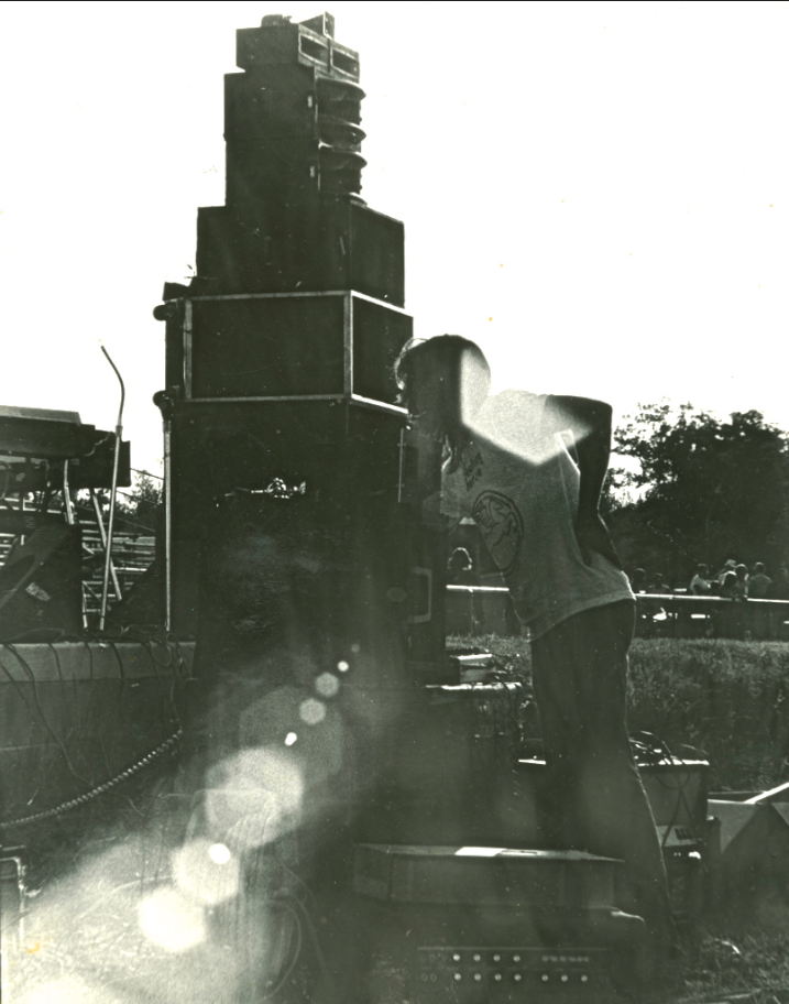

7) Wrong, I have been using vertical line arrays since the summer of 1975, as the photo below proves, as I still have 8 fingers and 2 thumbs in it- I lost 2 fingers and half my left thumb in a metal crushing accident just before Christmas of 1975. The only "side by side" horns in that system are the two EV diffraction horns near the top of the stack, their dispersion is about the same ether way, and I think we may have run out of speaker cord length, as we had rented several PA systems to put together the Big One for the concert after a road race at Donnybrook International Speedway. Although the system sounded great at over 100 meters distance, there was hardly more than 100 people that stayed for the show, they were all ready to leave as soon as the last race of the weekend was over.
The good thing about my hand accident was the "huge" $12,000.00 workman's compensation settlement allowed me to purchase equipment needed for Eclipse Concert Systems to tour with Sha Na Na across the country, setting up my DIY 3 way straight horn system in almost every conceivable configuration in venues ranging from "in the round" indoor and outdoor locations, to theaters with as many as three balconies, standard state fair grandstands, and arenas from 5000-to 15,000 capacity across the country, including "lost wages" (Las Vegas).
I got to hear the "VIP" system there, and thought "why are these clowns getting the big bucks for this re-furbished 1940s theater system that only should be used one per side, but is rolled in with as many cabinets wide as the stage allows?".
As I matured, I found out why they got the big bucks- once a system tours with a successful band, others that want to emulate that success story are more than happy to "jump on the bandwagon", and systems that roll directly off the trailer and on to the stage that only require a single AC and input connection (the "VIP" was an innovation in that regard, each cabinet had it's own three-way crossover, and amps built in) save stagehand expenses, which can easily exceed the cost of the rental price of a sound system if set up takes too much time or bodies.
JAG, please read my posts a bit more carefully, it is an aggravation to correct all the mistakes you continue to propagate about what you think I have, or have not done or said about my experience while doing those things.
Art

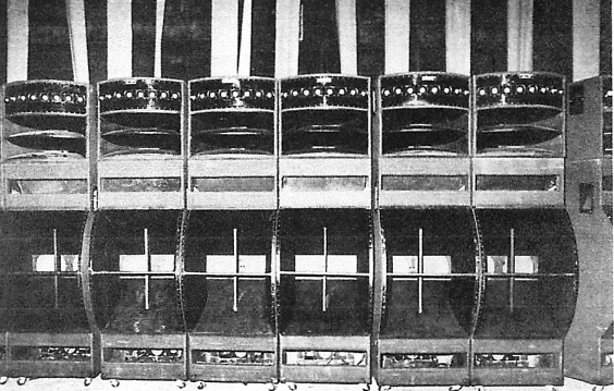

2) If you would research the "VIP" system I described, you would recognize the similarities. The RCA or Western Electric (I don't recall which) "Ubangi" horns featured the 2x15" in a vertical radial exponential horn, the mid frequency horns were placed horizontally in the cabinet above the LF section, then multiple units were rolled into place, side by side, just as the OPs picture shows.
One specific difference- the "VIP" acoustic point of origin for the bass and mid drivers are at the same vertical depth, but as the OP has not suggested putting his top cabinets at the acoustic point of origin of the 15 foot deep bass horn, the off axis distance to the mains and subs will be different everywhere, the cancellation will be almost random. In that respect, the upper comb filtering of the side by side "VIP" system was not quite as horrible as one would expect looking at polar response, it changed so much with so little movement from side to side that it almost sounded the same everywhere- uniformly lousy sound!
My analog "meat computer" memory banks failed, the "A1 Audio" "VIP" cabinet's MI-9588 Motiograph Western Electric radial bass horn section's 2x15" were side by side, not vertical like my bass horns from that era. In their "normal" horizontal orientation, the MI-9588 had the drivers vertical- Western Electric engineers knew something about what worked, and what did not.
Another errata from a prior post, the pair of 90 degree horizontal JBL 2350 horns above each VIP only used a single JBL 2482 mid driver per horn, it was ShowCo that used double drivers on their endless side by side stacks of Motorolas Piezo tweeter lined 2350 horns above the "Hurler" miid horns and "Pyramid" quad driver folded bass horns.
The A1 boxes were "Hi -Fi" compared to the ShowCo rig, but the ShowCo rig could tear your effing head off if you got near the mid-high section.
Sorry for the mistake, I guess Eric can put the 2 cents he owed me back into the kitty litter box 😱 .
Art
