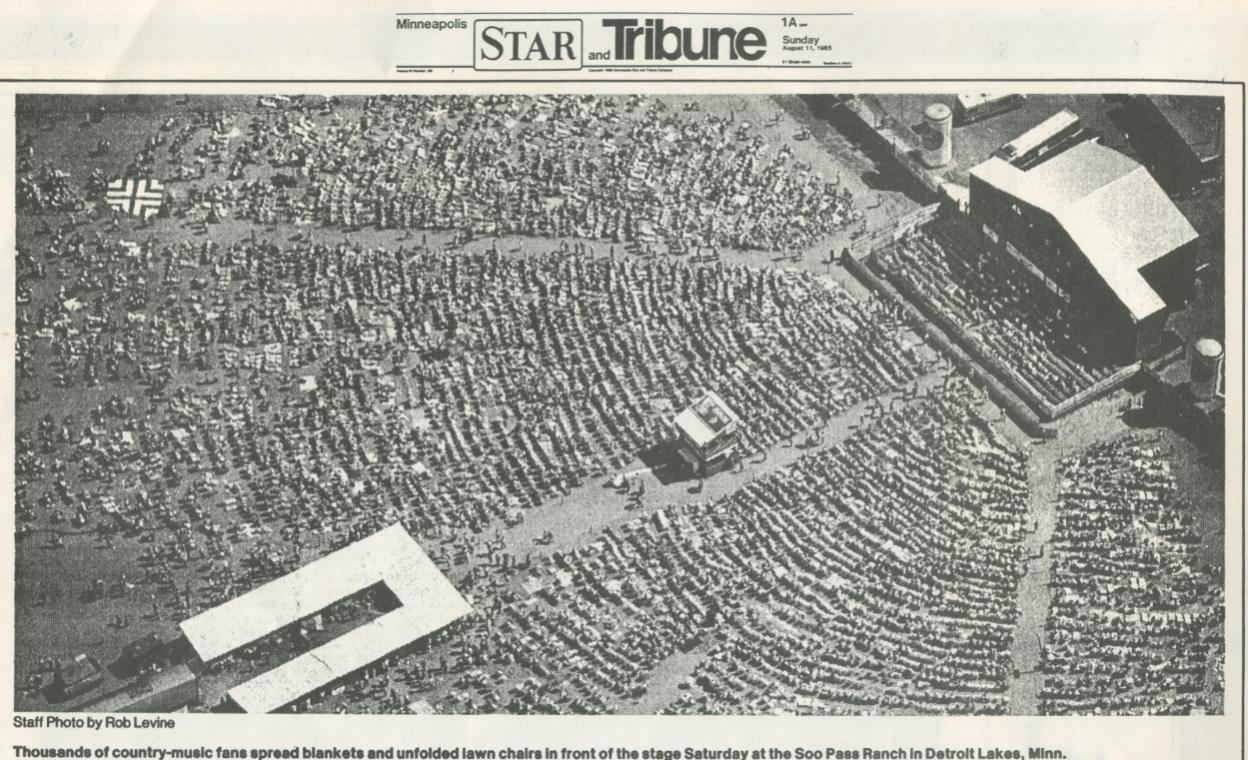

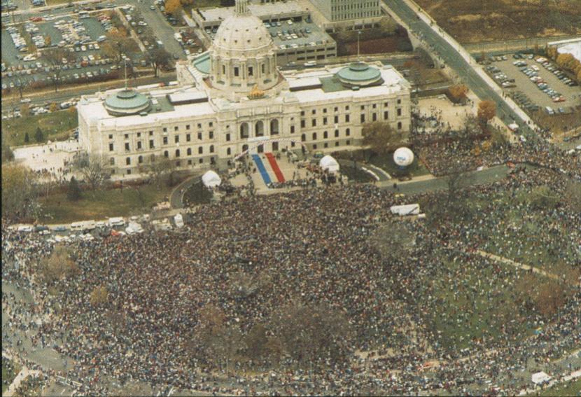

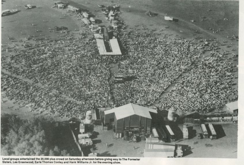

Below are some arial photos demonstrating people "fanning out" around sound systems, and a photo of the Alive in '85 WS PA system. People fanned out hours before the first act appeared, in a mad dash through the gates running across acres of land with lawn chairs, coolers and cameras under each arm, to the music of the William Tell Overture, better known as the theme song of the "Lone Ranger". Wish I had the videos I shot of that, but they were lost with hundreds of other archives when my ex-wife's house burnt to the dirt.

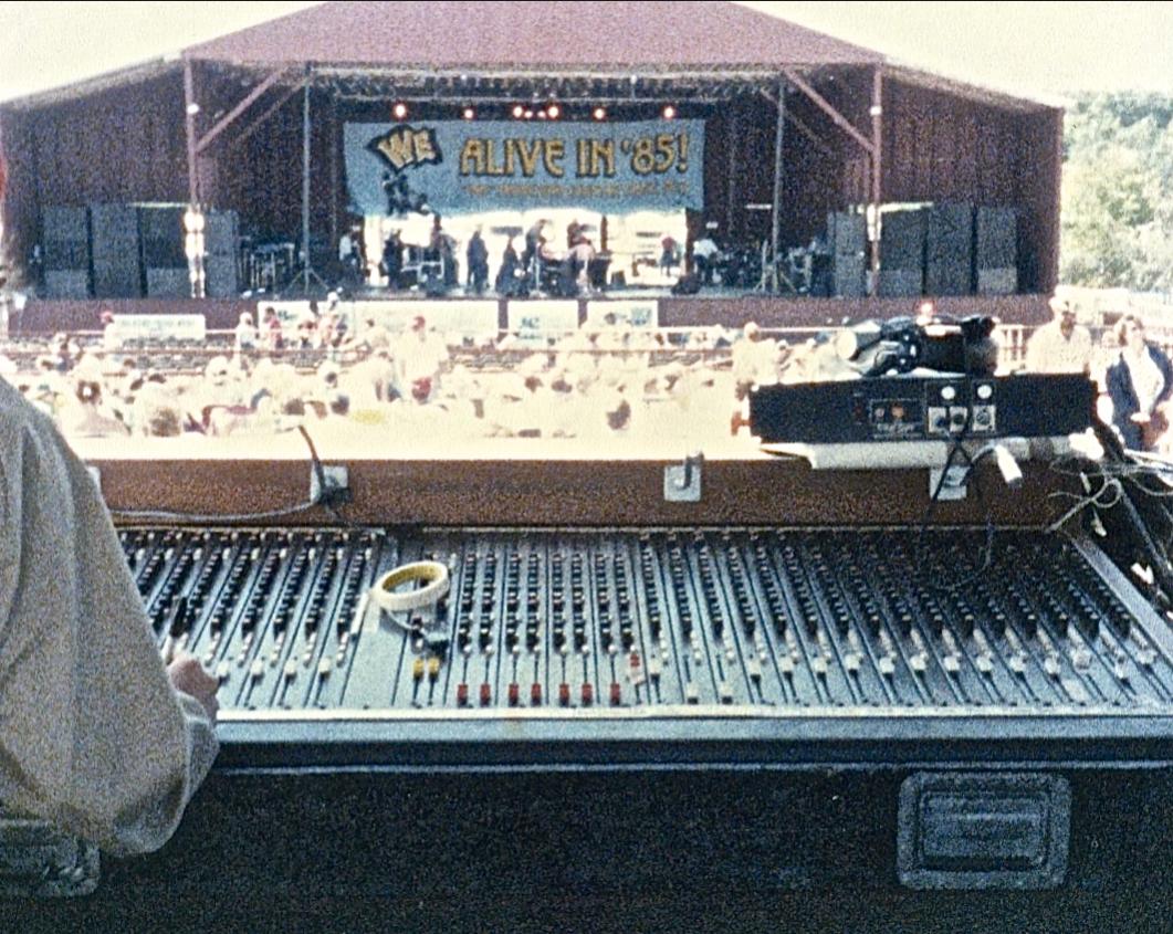

The 4 "block" WS We Fest "Alive in '85" system was less than 25% of the frontal area of the 16 block dB Sound/WS system described in a prior post, but satisfied the country rock audience at distances from the stage where performers looked the size of ants, roughly double the distance to the cheap seats at the Milwaukee Brewers Stadium. Sharp-eyed readers may recognize the Terry Hanley intercom on top the custom console doghouse, Hanley provided sound for Woodstock '69, for all I know that used intercom may have been used at that show too.
