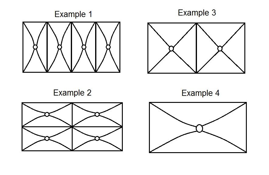

That is not at all the example I was expecting though - - - I seriously thought you were designing your newer iterations of your horn in a more complex manner.
I'm sorry if my example came across as overly trivial. Nonetheless, the horn dimensions remain proper for a “generic” 15-Hz straight exponential bass horn. You have been pounding home the subject of lobing, and how it should be avoided – and I have been trying very hard to understand, and how to control the problem. Again, this was a generic example, intended only for conceptual understanding.
Permit me to be more specific with my question – Example 1 through 4 above have identical overall mouth dimensions (14 feet tall, 32 feet wide). I’ve already stated my rationale for example one – but I’ll state it again for the sake of clarity. Four quarter-space 15-Hz horns, with the left two playing the left channel – the right two playing the right channel - stereo. And assuming the bottom octaves are recorded mono anyway, the bulk of the sound will be a mono full-space horn. And with an 8 foot projected horn-throat spacing, they’ll sum nicely up to about 35 Hz. And at about 141-Hz & up, each horn will appear as a very discrete signal source.
Example 2 - aside from this setup being 10 times more difficult to cast out of concrete than example 1 (requiring a complex foundation), does this setup buy me anything? (still running stereo, similar to example 1 - just rotated 90 degrees). The 8 foot spacing remains, as well as the resultant lobing issues – however they’d be in the vertical plane, and not the horizontal.
Example 3 - this is just two half-space 15-Hz stereo horns, side-by-side. I liked the idea of example 1, over example 3, because I'd have more room for drivers in example 1 (less driver clutter)
Example 4 - a mono full-space 15-Hz horn. I acknowledge this could be a half-space horn, but then I'm back to a mono system, and with a VERY cluttered horn throat. . . .
I would like to know how I may get a pair of 15-Hz "stereo" bass horns to sound good outside - feeding a relatively small backyard listening area. Your simulations clearly showed that bringing the stereo horns together would be much better than a 60 foot spacing - and that is what I've done, conceptually. . .

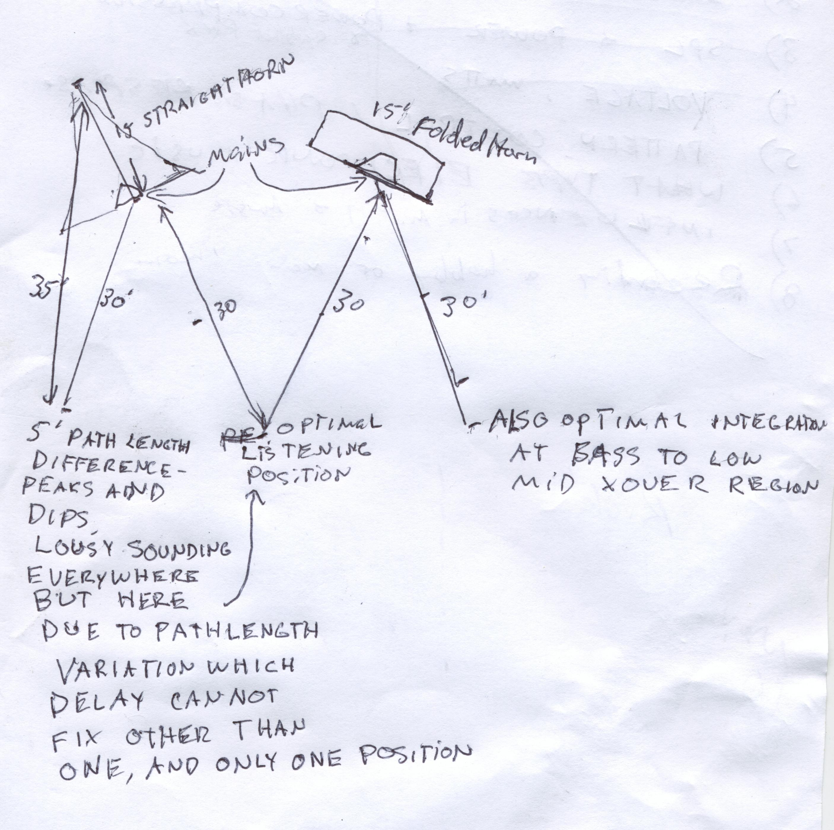

There is one serious sonic disadvantage to a 15 foot straight horn vs. a folded horn (which can also be made of concrete) shown in the diagram below.
Although a folded horn is more complicated to build than a straight horn, it will use considerably less materials, and has a distinct sonic advantage for your (and my) preferred embodiment, stereo subs, located with the top cabinets directly above the horn center.
The diagram below shows a more distant listening position than I would prefer for optimal stereo sound, which would be at the apex of an equilateral triangle. At any rate, if built using folded bass horns, at any distance from the L/R speakers along the center line will sound great, and no position off axis will sound "bad".
OK, my work here is done ;^).

Four quarter-space 15-Hz horns...
This is where the problem came from, it's semantics. Instead of calling it 4 quarter space horns, if you would call it one half space horn chopped into 4 that would be more accurate to the process you used to create it, more accurate to the environment it's working in and a lot easier to parse.
You can sim this stuff with Direct. Example 1 - 3 will have lobing issues, example 4 won't. The reason is that example 1 - 3 are well more than 1/4 wavelength apart (center to center) at the top of the passband. To be clear, the lobing issues will be a lot less severe than having the subs 60 feet apart, but there will be issues.
Like I've said a bunch of times, there's no stereo illusion at subwoofer frequencies unless the sound is panned hard to one side which is not really an effect worth recreating. This is the whole point of the non localization of subs - you can't locate where the sound is coming from. And as pictured, even if you could localize the subwoofer frequencies, and even if you did play them in stereo, you would have no stereo effect because they are simply too close together in these examples. It's like listening to a ghetto blaster from 12 feet back - sure there's two speakers and they are playing in stereo but they are very close together, so at 12 feet back do you really hear it in stereo?
If you absolutely have to have stereo in the sub frequencies you might as well just build your dual subs and place them 60 feet apart and just live with the comb filtering.
I've said it a dozen times, I'll say it again. You need to do some testing outdoors and determine which aspects are truly important to you.
Art
This last paragraph and the concept it describes is not going to be an issue.
If you draw it to scale and calculate the path length difference it isn't going to add up to much more than a couple of milliseconds at any point on the horizontal plane, basically inaudible.
If you draw out the folded horn to scale and do the same thing, this will indeed cut the problem roughly in half but since it's already basically an inaudible non issue it doesn't matter.
OP is going to make straight expo horns, this much has been clear since the first post of the first thread he started. So this issue doesn't matter, it is what it is and it certainly isn't any kind of deal breaker.
Agree with a lot of weltersys's comments.
In the diagram, he properly points out difficulties with time alignment (ummm, didn't somebody mention that on Page One, ahem, ahem?). And all on an order of time-scale unbelievable to home music room listeners. Ballpark echo???
But Art's comment about ONE good seat, while correct in a purely math-compulsive way*, isn't quite the whole story. The intersection of the whole areas covered by decent speaker dispersion of the two speakers is the sweet area, providing time-alignment is OK. But as you can tell from his helpful diagram (at last), the separation of speakers is key.
While Eric seems dead set against putting the mains inside the horn(s), the might be the best way to go. However, the whole process is much more agreeable, if Eric stops sticking to a needlessly low crossover point. Otherwise, the mains can be pretty small, eh, or even horns for a spectacular all-horn system. And if the mains are inside the giant horn mouth, zero problem with stereo image, need I add, eh.
Glad to see we are addressing system design like grown-ups. Did I also raise that on Page One?
A wide horn array like example 1 looks good to me.
bob4 showed a sim of a wide row of horn subs that looked good at 80Hz - no nulls. If that's accurate, I don't see why your example 1 would be any different.
To sort of re-hash this + adapt what I said earlier, http://www.diyaudio.com/forums/subwoofers/297953-concrete-bass-horn-design-question-67.html
If it were my project, I'd be tempted to:
  • Run the inner two horns purely as subs <60Hz (ish).
  • Run the outer ones as part of the mains, e.g. from 20Hz-300Hz (as high as they can go, while sounding good) - so the mains don't have to be so big.*
  • Stuff the mains inside the horn mouths.
...or, in other words: the outermost horns would be ~point sources above about 60Hz, and below 60Hz, the whole horn array would be firing.**
I could position them out in front of the bass horns. This method would probably require building my mains on wheels, and rolling them out into position each time I want to play music - probably not the best long-term solution.
Opinions?

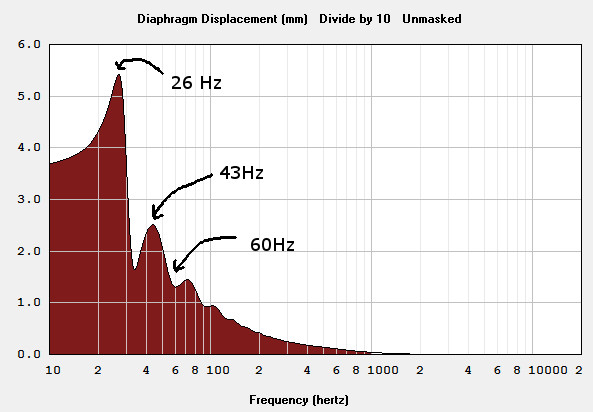

As a long-term thing, if you give the horns a flat bottom (slight tilt for drainage), you could build a very short railway into them, so it would only take a shove to roll (even very heavy) mains in and out.
*Note: I hacked your example 1 illustration (without consideration for scale) to show how you might get a bit of toe-in + wider horizontal coverage. You'd probably want to walk around & sketch out your site to work out for yourself what horizontal pattern you'd want.
**Note: in the attached displacement plot, you'll see that a nominally 30Hz horn has quite low excursion above 60Hz. That is: the heavy work (where you would want all drivers operating) is in the bottom octave.
This also looks like an argument for making the horns huge. If the cutoff of the horn is low, relative to the tone being played, excursion is small.​

Example 1 through 4
You are arraying these horns so it may be time to look at them geometrically. Example 2, each of the four has straight side walls. At all frequencies when the wavefront reaches the mouth it will be the shape of a scoop of ice cream on the cone with the centre of the arc being the apex of the cone just behind the driver.
Example 1, the higher frequencies will beam somewhat in the horizontal, and the primary wavefront will be more narrow than the mouth. By the time it travels until it achieves the same width, the radius will be larger and the combined wavefront will be less like a 'w', but a little more straight.
Neither is necessarily perfect, just pointing out the more obvious concerns. Also, the lower walls in example 1 are pointing toward the ground. Either curved walls top and bottom to reduce this at the higher frequencies, or maybe better, remove the bottom half of them (the top wall could be optionally curved)
Just talking shape, not size.
