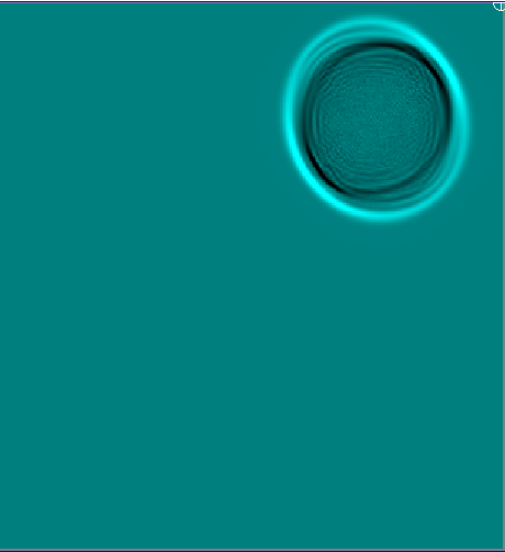

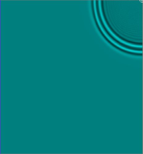

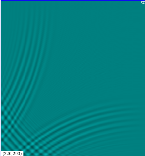

So let's get to the pretty pictures.
First pic - this is just mains playing fullrange shown at 0, 2.86, 5.71. 8.53, 11.31, 21.8, 26.57, 33.02, 38.66 and 45 degrees. It looks nasty but for the most part those notches are not very wide, so pretty benign. The exception is the lowest one, it's two octaves wide and moves down in frequency as you move off axis.
Second pic - this is the single sub configuration with mains added. Crossover is 80 hz 4th order LR for both the mains (high pass) and the subs (low pass). The 4 steps show 0, 5.71, 11.31 and 20.8 degrees, roughly corresponding to the black tic mark virtual mic locations on the picture. As you can clearly see, at 0 degrees there's already a problem, a 7 db notch at the crossover. At 5.71 degrees you get a 2 ocatave wide notch at 200 hz and as things move further off axis there's no more deep 2 octave side notches. In fact, below the crossover point this system is very well behaved at all points on and off axis.
Third pic - this is the dual sub with mains inside the subs. Crossover is the same, 80 hz 4th order LR for both subs and mains. Clearly, on axis everything is beautiful. At 5.71 degrees there's a massive 2 octave wide notch at 100 hz and as you go futher off axis the massive notch lowers in frequency.
Fourth pic - this the dual sub with mains configuration with a different crossover. I've moved it up to 300 hz LR for both the subs and mains. Clearly this isn't any better (and not a whole lot worse) than the same configuration with a lower crossover.
Hopefully these gifs will all play properly. In case it's not clear, in each case the flattest summed response (black line) is the 0 degree start of the gif. It should also be clear by looking at the red and blue lines which show the mains and subs individual contribution.
The big issue here is not the comb filtering at mid and high frequencies, those notches are not very wide and won't be distracting. The big issue is the lower frequency notches that are deep and two octaves wide, these are a huge problem.
The single sub configuration has only one such notch, it's at 200 hz and only appears at 5.71 degrees off axis. The dual sub configuration has this deep notch at EVERY off axis position at some frequency.
If you average the results, the single sub comb filtering as a whole is a lot more calm than the dual sub configuration. Furthermore, when you chop that single horn up into modular pieces, all the pieces will comb filter with each other (this is not shown here, maybe I'll sim that up later).
What I cannot show in sims is weltersys' insistance that the soundstage will wander around at the crossover point with the single sub setup. All logic and empirical evidence shows this is not true, especially not with a steep 80 hz crossover, but I can't prove it either way.
What I can prove is that the comb filtering is a lot worse with the dual subs than the single sub and I think I've done that pretty effectively here.
No matter what you do there's going to be a lot of comb filtering, but the point is that you can minimize it's effect by eliminating most of the instances where it's causing a deep 2 octave wide hole.

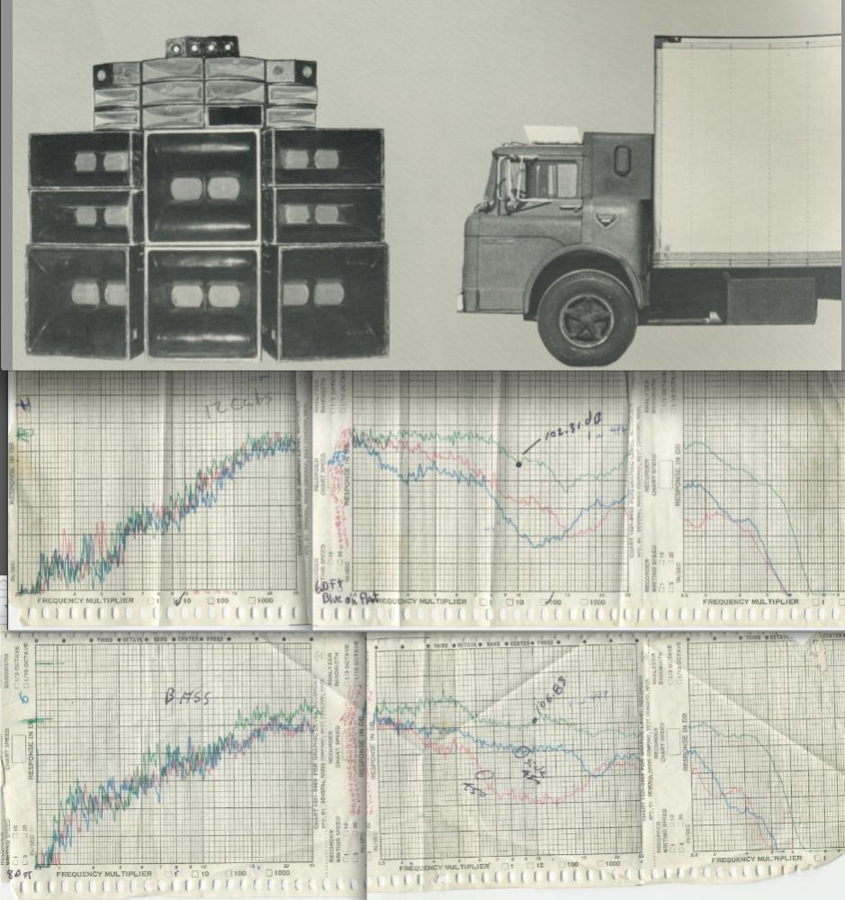

5)Designing for an octave of overlap is a good "quality assurance" that the system will sound good through the crossover overlap range, which even with 24 dB per octave crossovers covers around an octave. The actual response of my 1979 dampened fiberglass straight exponential horns are shown below, old-timers will notice a "chart recorder" was used.
As you can see by the wiggles, I did not rest my finger on the pen in order to "smooth" the response like manufactures often did in the "olden days".
Now all that needs to be done to achieve a smooth measured frequency response is hit the "smoothing" tab on a measurement program screen, and an almost straight line appears.
Also note the "1 watt at 4 feet", it was some time later that "one meter" measurements were common in the USA- Jimmy Carter was unsuccessful in getting the metric system adopted here, because folks are afraid of something "new" even though it may be far superior.
The single 45" x 45" x 30" deep "bass" horn raw (unequalized) low response was "happening" to 60 Hz, with the "full stack" as pictured, with four bass cabinets per side it did 40 Hz no problem. With a single cabinet well over 107 dB one watt one meter, the on axis forward sensitivity of four cabinets was around 98 dB one watt one meter at 40 Hz, with about 3200 peak watts for the 8 drivers, that works out to about 122 dB.
One Keystone sub using a single B&C 18SW115-4 can do an easy 128 dB at 40 Hz, and is less than 1/8th the size of just the bass cabinets in that old system. Times changed, I had to retire the straight horns.
The response of the 45" x 22.5" x 24" deep low mid horn rolls off below 160 Hz, it is about -10 dB at 90 Hz, I used the cabinet for "bass" on some lightweight gigs, a simple boost on the graphic EQ was all that was required to satisfy the kick/bass quotient. We crossed between the 15" and the 12" at 200 Hz, but (almost) always stacked on cases, stages, or scaffold to get the cones at least head height for the reasons explained in #2 and #4.

[1]The wave fronts don't really combine, they go right through each other.
Something about those wavefronts.
[2,3,4]
Most of us work in rooms, where destructive interference is a necessary and desirable part of the multi sub approach.set up by someone that doesn't know what they are doing.
Of course, but how is an in room multi sub setup even remotely applicable to this discussion? Even in rooms the mid/high frequency comb filtering shouldn't be deep notches an octave wide, which was the point you were quoting when you started talking about multi subs in rooms.

[1]
[2,3,4]
For clarification - destructive and constructive interference in audio (regarding sound wave propagation) does not literally mean destroying the sound waves, or combining the sound waves into one.
Assume you are floating in a large lake. Then two boats drive by - one on the left, and one on the right - both at some arbitrary speed & distance. When the two wakes meet up with you - at any particular moment in time during the event, they might combine to lift you well above the normal surface waterline. They might combine to lower you well below the normal surface waterline. They might combine to have no change whatsoever for your position on the waterline. The wakes (waves) are not really ever truly combined or destroyed - they pass freely through each other. The important variable is what happens to you, at your particular position during the event. You'll either get a lift (constructive interference), or you'll get nothing (destructive interference). That's my mechanical explanation anyway. .. .
