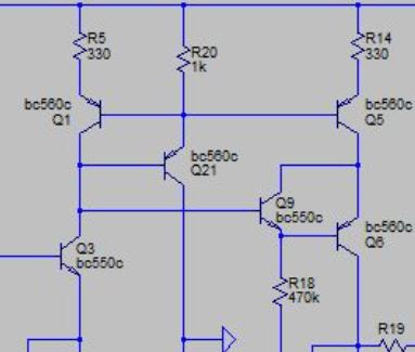

Your circuit is not willson and not darlington. Q21 is emitter follower to provide the base currents of Q1,Q5 for perfect mirror. The voltage at collector of Q1 remains near constant to provide the cascode base Q6 a near fix low impedance voltage by Q9. In symmetric it looks very elegant circuit but far to be anything similar to mine. I wonder if it is not better to link the collector of Q9 to rail.

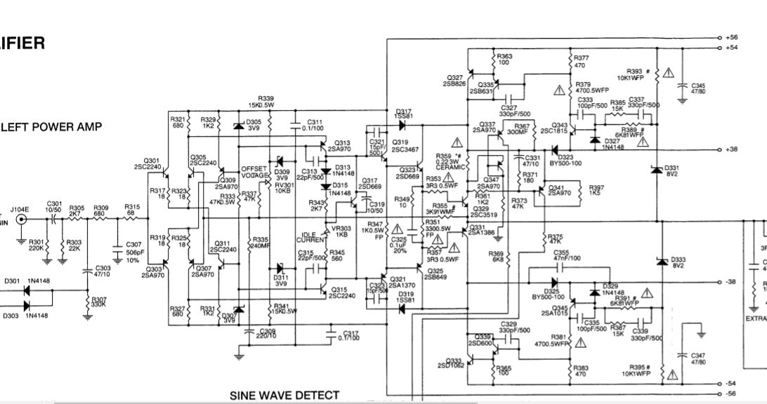

In the above schematic, Q313/Q315 fulfill the role of VAS.
Why do you say it 'disappeared'?

In ordinary voltage amplifier it gets input voltage and amplifies to output voltage of very high gain and it's pole. When the transistor is used in common base mode, it doesn't act as amplifier but I/V converter with extremely high pole equal to its Ft, in cascode . By this in the transfer function it disappears, and the 3 stage amplifier behaves as 2stage. If CFA is used which makes the IPS disappear you will be left with OS transfer function alone as single stage.
Hi Minek, Q313 / Q315 are folded cascode transistors. Essentially current conveyors and provide no voltage amplification. Therefore, they are an extension of the input stage.
The best way to see it, is to count high impedance nodes. In this amplifier there is only one.

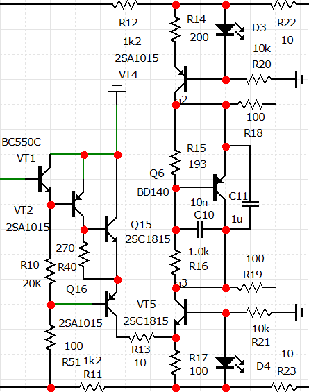

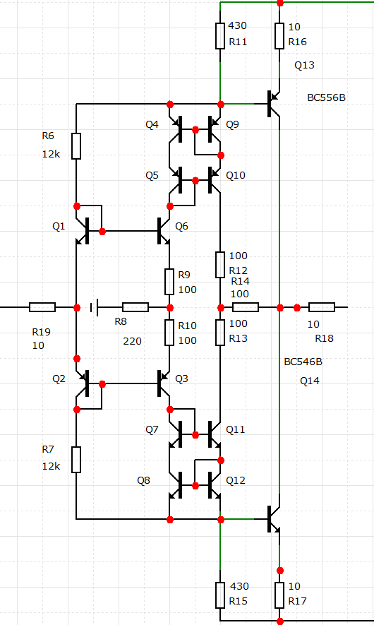

Is this a VAS ?
Hi Stanislav,
1. Circuit 1: What is before VT1?
2. What is input and what is output?
Hard to tell without seeing the whole circuit.

Is this a VAS ?
Hi Stanislav,
Circuit 1 is a folded cascode VAS preceded by an over-complicated multi-stage level-shifting buffer. It doesn't seem like VT2, Q15, and Q16 will turn on, so this one is probably dead in the water.
Circuit 2 is not a VAS, but a current-boosted buffer stage. At least it wants to be.
R6 and R7 should be tied to the rails.
R8 - R10 are actually clever, separating the setting of the quiescent bias from the large signal current.
There's no reason for Q4, Q5, and Q7 - Q12 to exist. Their only function is to double the current of Q3 and Q6. A function better handled by doubling R11 and R15.
I agree with chip that there's no reason for R12 - R14 to exist. Just short them all.

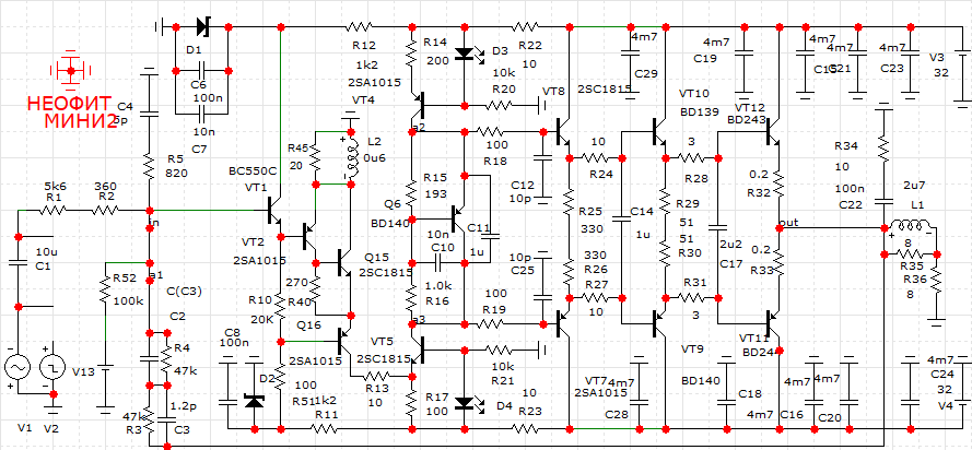

Disappointed. The first circuit is a voltage amplifier of a super-linear power amplifier from the reference in post 83. The second figure is a slightly simplified input stage from opamp AD 844 the input circuit and the OOS circuit are not drawn.
Are you sure? If you check AC voltage (vs ground) on their BASES, EMITTERS and COLLECTORS - there is definitely voltage amplification.
I'm not arguing HOW voltage is amplified, but it has to be amplified SOMEWHERE, and as far as I can trust the sim, and the oscilloscope,
there is amplified voltage present on their collectors.
I treat it as VAS, with input (low voltage) at the emitter, and output at the collector. If this is a cascode or not, or if it has a pole or not, should be irrelevant.
This is just "implementation detail".
