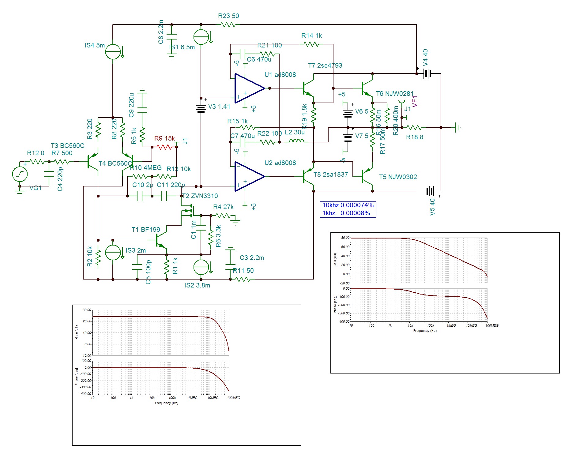

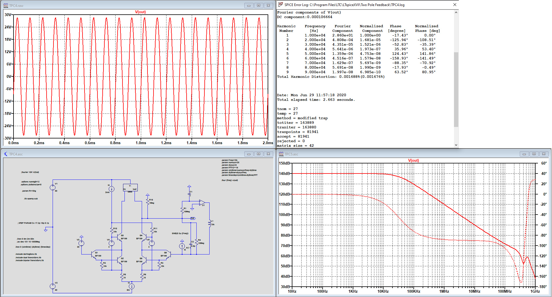

O.k. here you are, now with the BF199.
Distortion at 10Khz at +/-30 Volt with +/-3 uA input in 1Meg out is now 0.0016% and second pole is beyond 100Mhz.
You still owe me an answer why the dominant cap C2 should be that low in your situation and why you have such (over the top) requirements for a VAS.
With a ideal 5mA/V (Fet ?) input stage that you specified and an ideal OPS, both with a FR to infinity, your Amp would have GBW of 70Mhz without the need for a Cdom, a bit high to my taste for an Audio Amp.
But since both the non ideal IPS and OPS will add their phase, you will definitely need a Cdom that will drastically change the current gain at 10kHz.

For now you are working in single pole at 20khz. Later you will pass to two poles, the dominant pole can fall down to few khz. With mine 50khz 2 poles , the dominant is about 6khz. The problem in this design to have the distortion at 10khz adjusted with least feedback as later it will be in 2 poles where the 10khz is out of feedback.
You are right when you say the OS pole is the most important that limits the NFB, but if you followed my thread on 2 way feedback, you see that it can be eliminated , leaving the VAS and the IPS second poles to deal with. I am working on another type of feedback that eliminates all the second poles.
It is also to notice that it is your choice to over do, Is it really necessary to go differential ? If so, something extra it must provide.

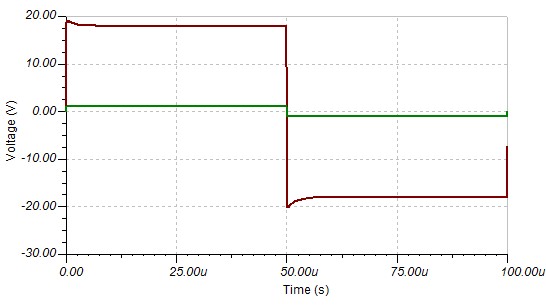

I just finished a circuit that rejects feedback above 1Mhz, but gets it's stability by adding a LCR notch in front of the VAS. As it is no more 2 way feedback but re tailored VAS, I will return back to this thread tomorrow.

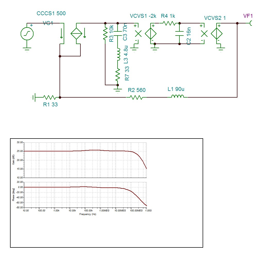

This is a revolution
attachment.php

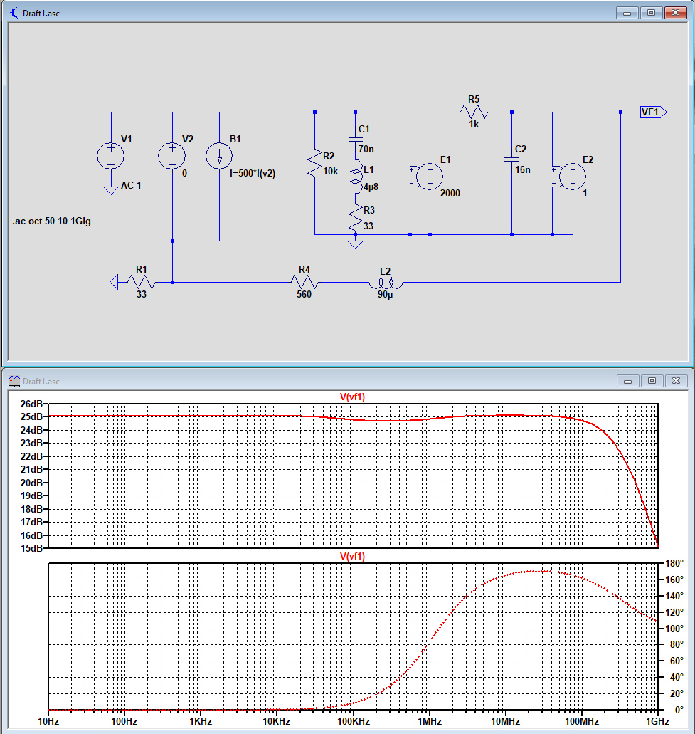

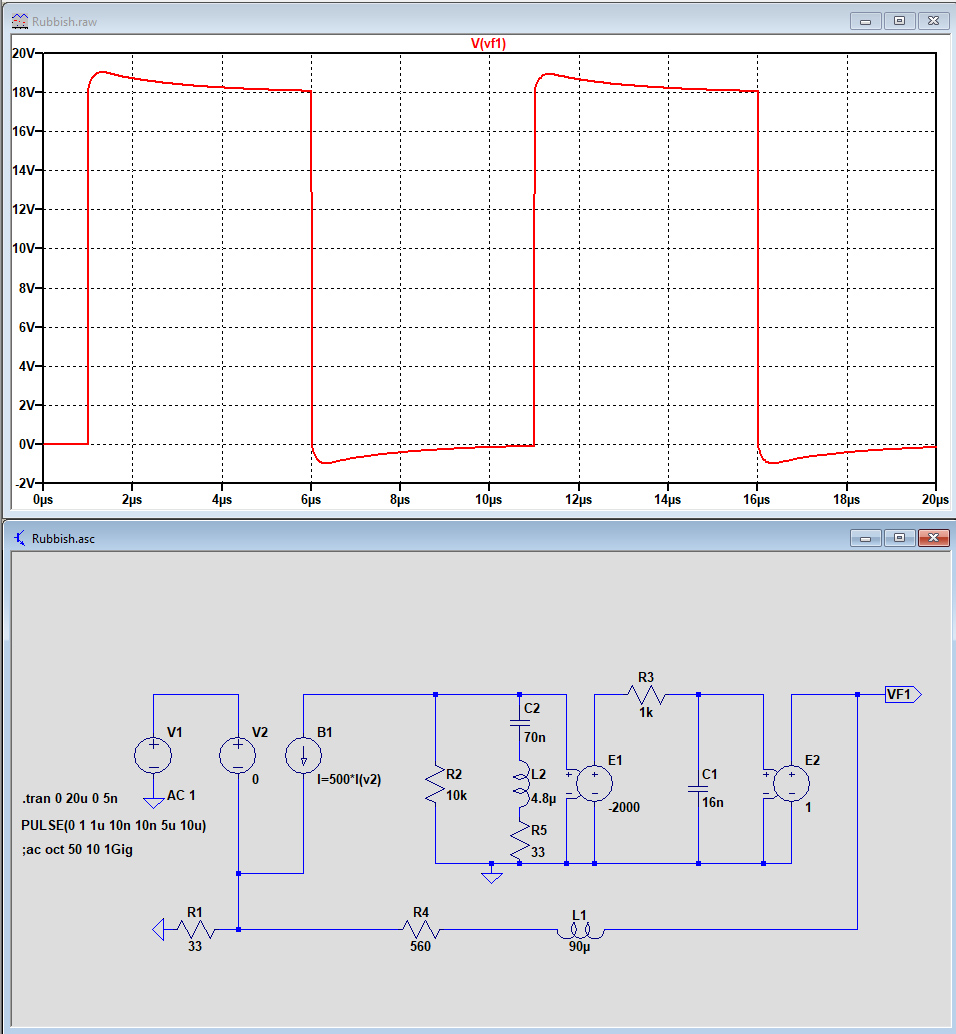

The feedback is limited to 1Mhz by inductor L1. The IPS modeled can be a single transistor of beta 500, working in CFA mode of 30mS , fixed by R1.
The LCR is not a real notch. The R7 must be equal to R1. L3,R7 is the same frequency as L1,R2 , 1Mhz. R7,C3 is about 100khz.The pole is at 6khz fixed by C2,R4.
With this configuration, the amplifier goes to open loop starting from 1Mhz. Finish ,all the stability stories and its margins. Now a new era starts where the HF character is truncated from the audio , finally.
Now, I must integrate the notch into the 2 pole VAS.

Hayk,
I'm still anxiously waiting for the realisation of your closed-loop/open-loop high BW concept.
Hans
