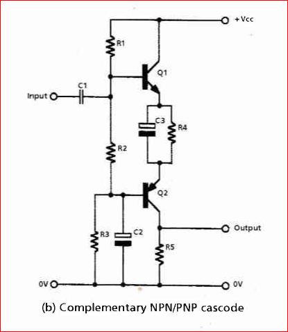

Complementary Cascode
Something a bit different.

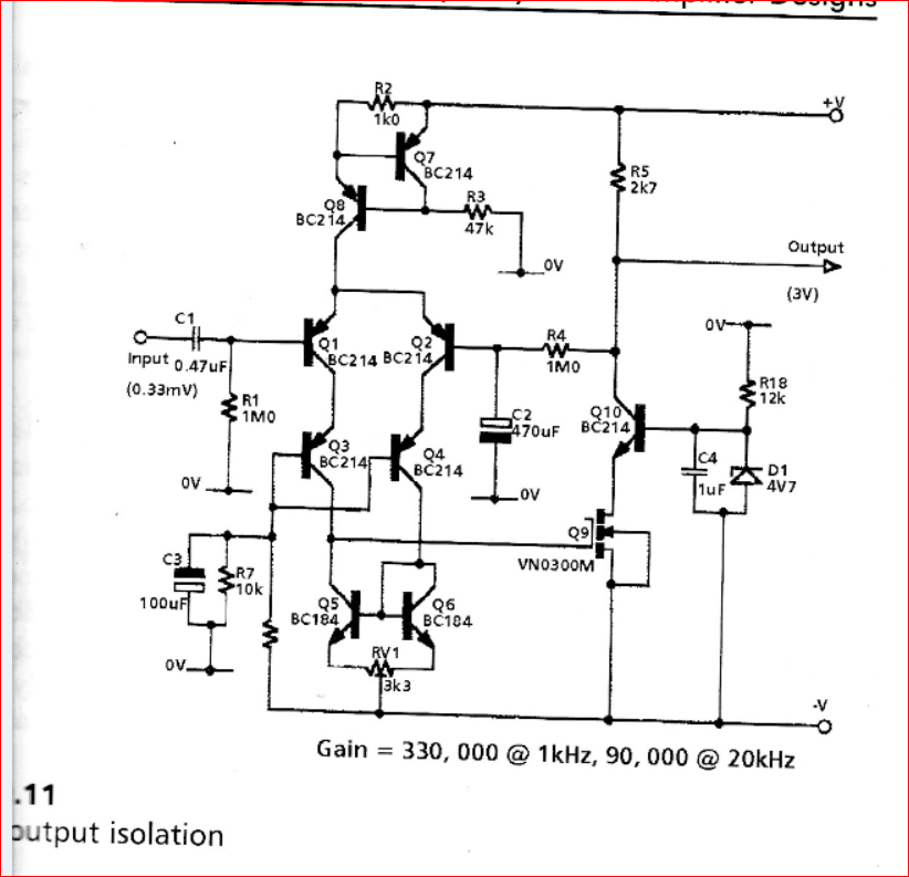

Another Cascode Example
The 2k7 load resistor would normally be replaced by a constant current source. The value of 2k7 possibly with 2000 pF in parallel was thought to be representative of the gain stage load presented by an output stage.
The author published a design in 1972 than had a buffer ahead of the gm transistor. The buffer was dc bootstrapped with phase correction strung networks around this.
This was one of a series of amplifiers I have built. It needed a better pre-amp I than the IC based one I had at the time.
I am responding to the initial request - take it or leave it.
