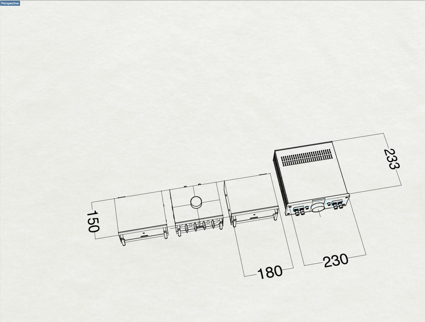

Hello,

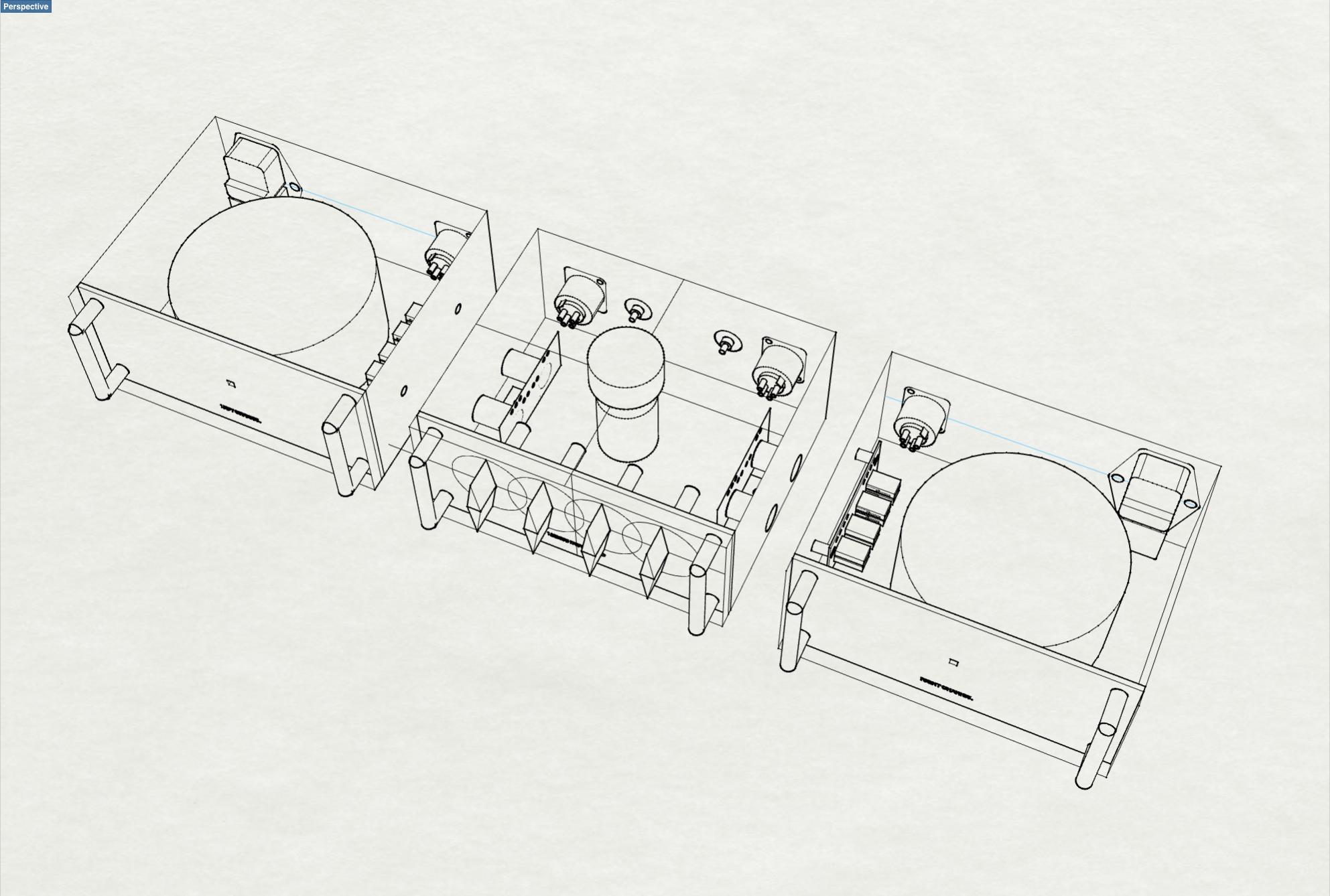

I really want to go for the dual mono power supply.
The chassis I got are too small for two toroidal transformers 300VA in the same enclosure.
I`ve done some research:
1. http://www.modu.it/economicaep.html
It is cheaper for me to buy three of these enclosures than to buy one more (230x230mm ) gallaxy enclosure from the same company.
For this exact build I do think I like the looks of the economicae line better than the gallaxy line...
See attached digital drawings !
I guess there is no problem building two separate PSU enclosures for this build.... - any inputs?
Thanks!
Endre

signal XLRs have the male as output and female as input.
Power when fed through XLRs usually reverse this, to female as output and male as input.
This prevents inadvertent mis-connection when using a standard male to female cable.
Think about how your 4pin power sockets could be mis-connected. You may have no problem if you have no other 4pin sockets.

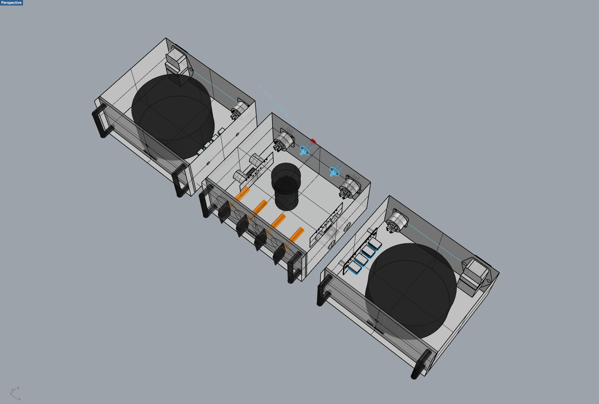

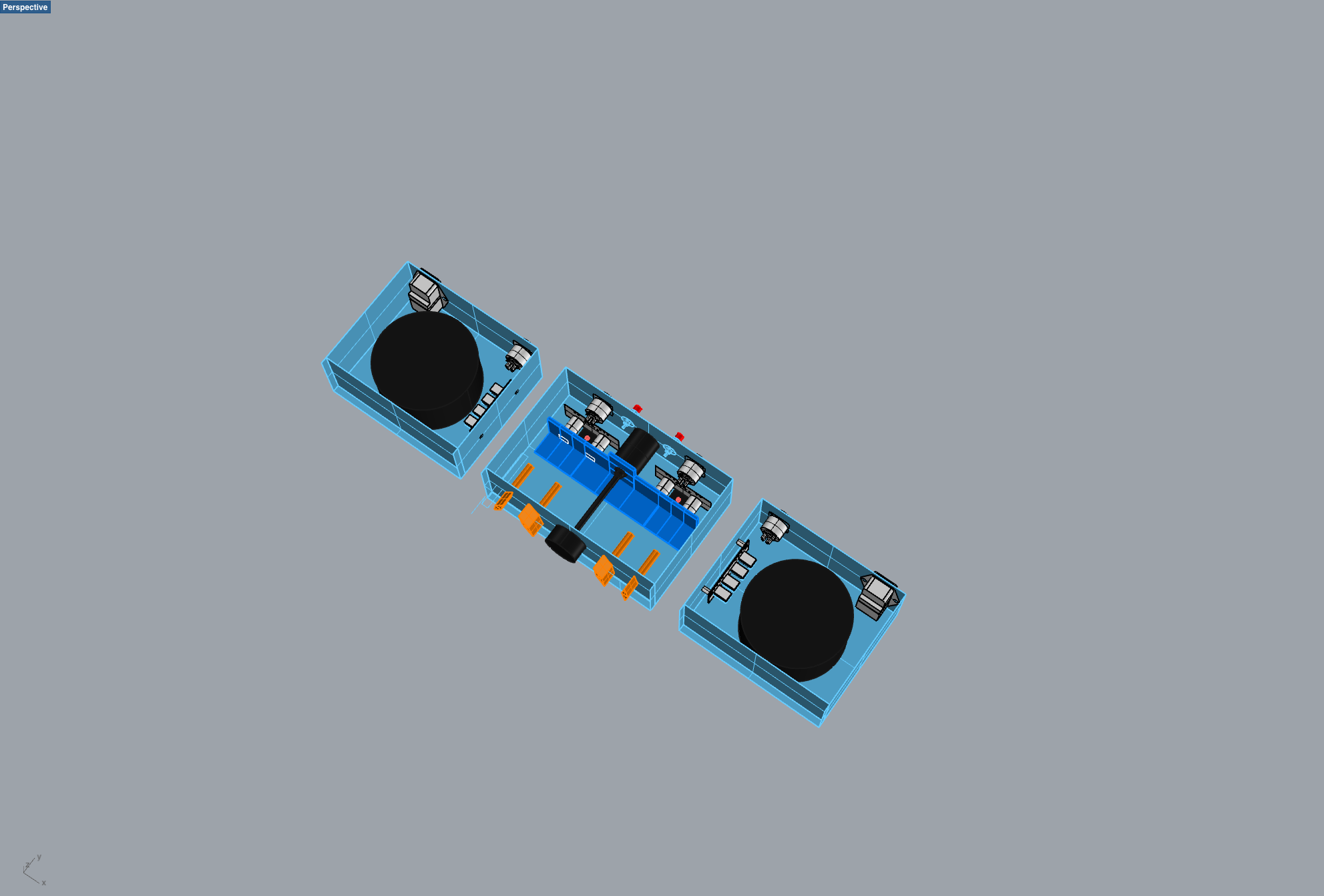

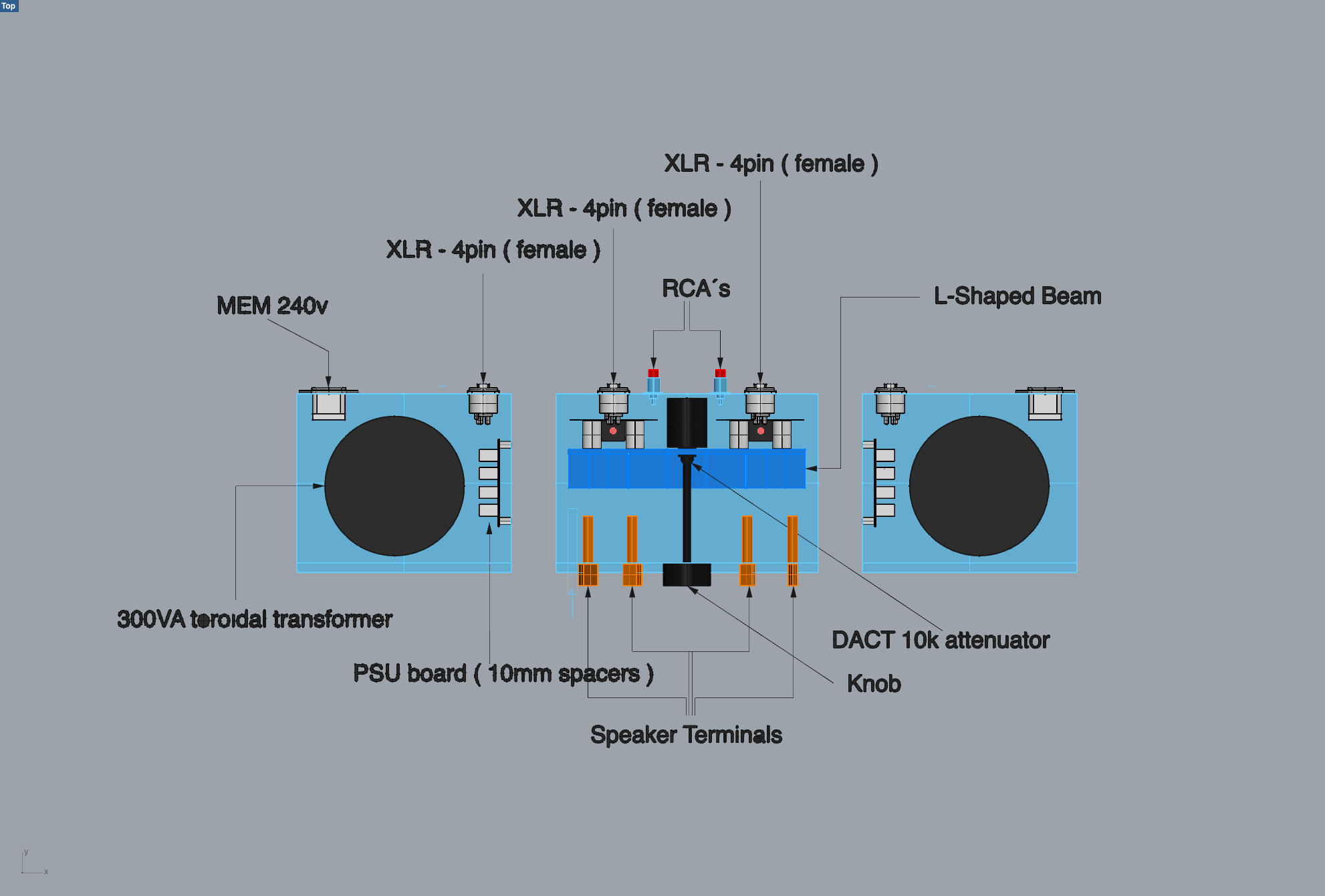

Great pics Endre! Two things came to my mind when looking at your pictures and thinking about my own goal to build two monoblocks. But I still did not order any parts so I can still change my mind...
1) What is your main consideration to separate the PSU from the amp housing? Do you want to shield / separate the mains hash and high voltage influences from the amp?
2) It looks like you put the amp boards vertically with the chips on the bottom plate. Then what do you use the L-shaped profile for? To support the attenuator axle + the capacitors?
3) Will the economic housing distribute the heat well enough? Probably will because it is a large surface connected to other panels at the back and sides.
Yes indeed the Mundorf terminals look really swell at the front and easy to tighten with the wings!
Have fun
Regards, Frederick Joan
Signal XLRs have the male as output and female as input.
I did not know this. Thank you for explaining! Will adjust this to:
Output PS Enclosure = female output.
Input LM3875 Amp = male input.
1. I want this amplifer of mine to look "clean" - I guess separating the different parts will give a simpler layout. I also found out that it was too crowdy putting two 300VA transformers within one galaxy (230x230mm) enclosure. Therefore thinking three economy chassis instead.
2. In the first place I`m using the L-shaped profile to support the attenuator. I guess by making an extension to both sides I have a place to also install the caps on the two main boards too - like Peter did in his manual.
3. I sure hope so....
Endre

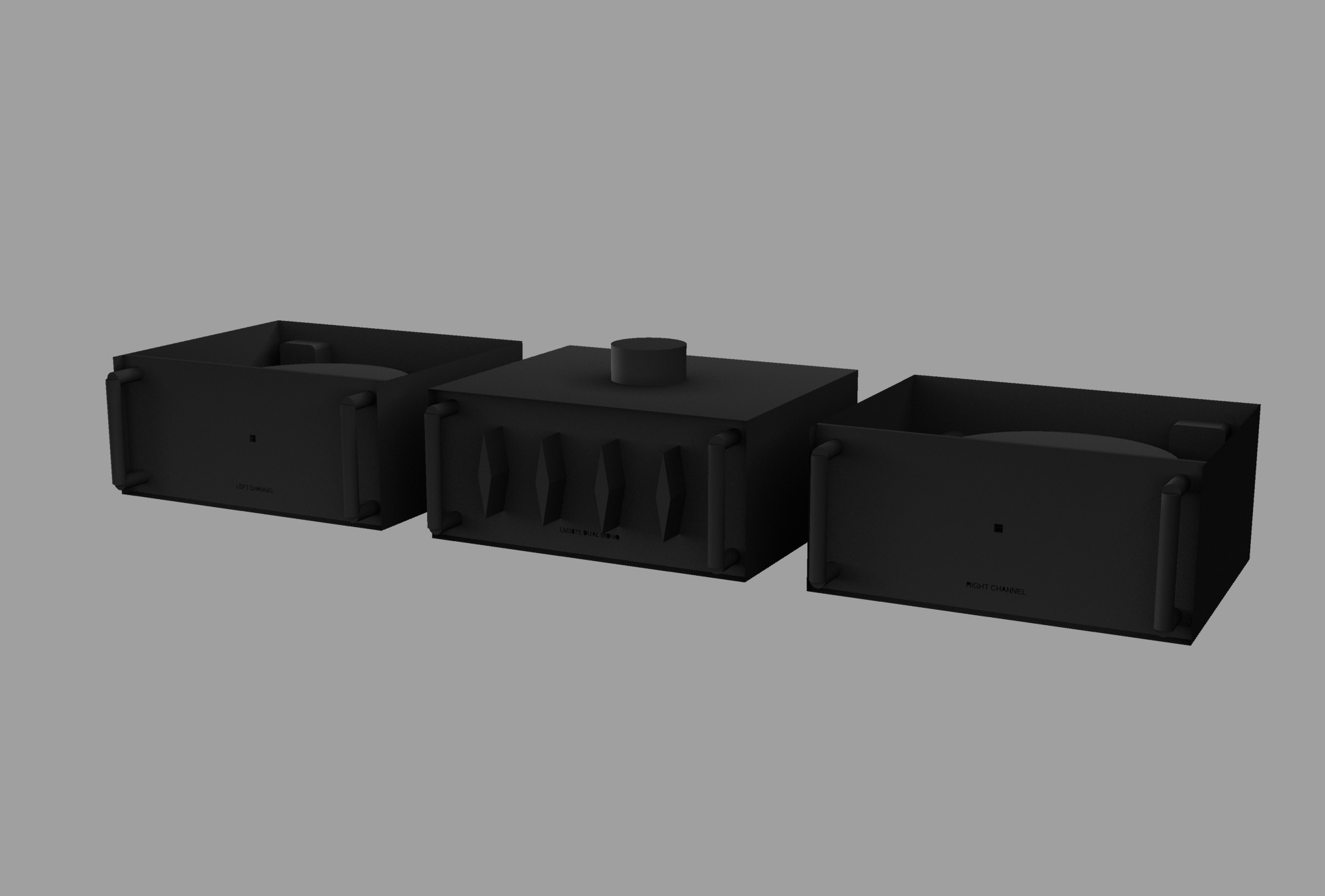

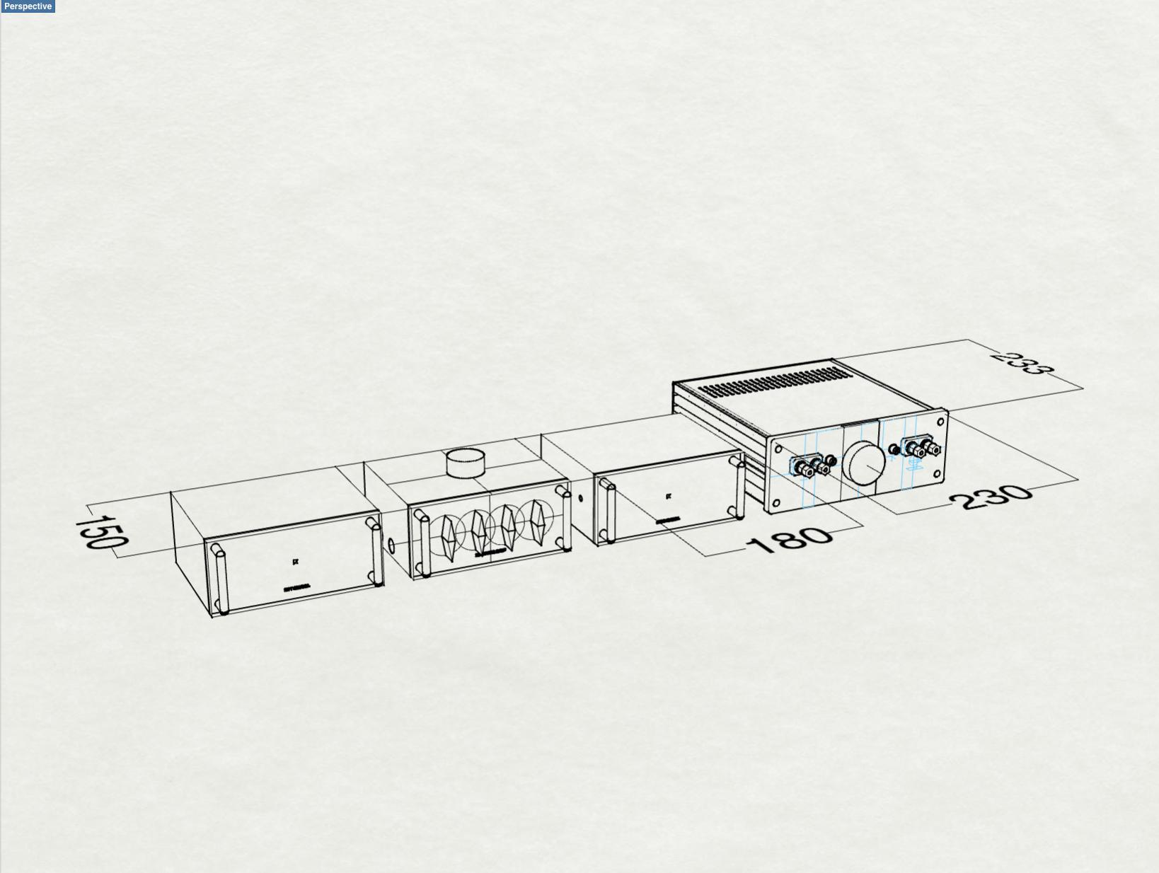

Hi !
now... I have finally landed on a chassis design I think will work really well.
For me ... I just wanted to share this setup.
The chassis I´ve used for my drawings are really cheap compared to other chassis designs out there. Same manufacurer as last time.
The three chassis used for this setup are really small.
All three are 180mm in width and 150mm in depth and 80mm in height.
Thats roughly: 7 inches x 6 inches x 3 inches.
Small enclosures was something I found important in drawing these last enclosures. Before I thought the chassis I had were small... See comparison and you`ll see there is quite a big difference...
Endre

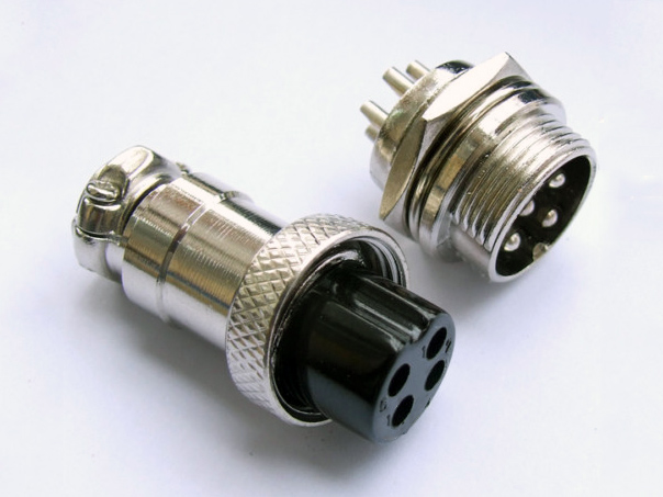

hello !
I have a question regarding the connectors for my umbilical chord.
I´ve found this type of connectors. ----- see attached photo.
These are units used in other designs for power supply.
Will this type of connectors work well for the umbilical chord for the LM3875 kit too?
