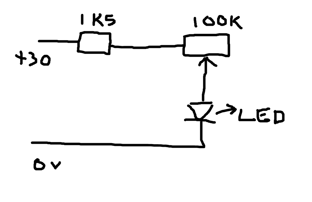

Hi Peter,
Could you give me a hand with the calculation of the resistance R3 suitable for the LED which I would like to have? My goal is to have an LED
* in the frontpanel (10mm thick)
* round diameter appr. 3mm
* blue color
On digi-key I found one which seems suitable for me: VAOL-3LSBY1 Visual Communications Company - VCC | VAOL-3LSBY1-ND | DigiKey.
It is a VCC with Vf of 3,5V; max. 4.0V. I thought it would be easy for me with some high school formula's but I still don't get it when I try to recalculate the red LED in your manual.
Can you show me how to calculate?

Hi John,
Thanks for your suggestion. I have played with it a little bit. Now the question is what source voltage I should use in the calculation. The power supply has a 300VA 2x22V secondary toroid. The resistor is bridged over one of the rectifiers. So should it be 22V or should I multiply by sqrt2 to obtain the railvoltage with 1500 uF of buffering?
Peter uses a 62k Ohm resistor with a red led with Vf of 2.2V. But I cannot get the calculated numbers as shown by the calculator.

You should run the LED from one of the DC rails, not across a rectifier. Either rail, it doesn't matter. If you run it from AC the flicker will be obvious as LED's react instantly, not like a bulb.
You can calculate values but until you actually try it and see it in the room, in its location, you just won't know.
Voltage will be approx, 22*1.414 which is around 31 volts DC. Subtract the LED forward voltage and you get say 27 volts. You need to lose that 27 volts across a resistor at "some" current... and that LED is moderately bright at 1200mcd (millicandela) and so a current of just a milliamp or so may well be sufficient.
R=V/I and so you get 27/0.001 which is 27k.
A dab of epoxy is fine for securing LED's. Do NOT use super glue... it migrates and causes a white bloom.
Modern LED's are generally super bright, so you won't want a searchlight beaming out at you. It really is trial and error to get a value that suits you.
You can go as high as you like, just don't go lower than a value that would cause the LED maximum current to be exceeded which if we say is 20 milliamps would be around 1.5k.
(to get it absolutely correct you could fit a series variable resistor, get the brightness correct and then measure the pot and fit the nearest fixed value to the 1k5 + pot value. The 1k5 is still needed with the pot to prevent you accidently exceeding the max current)

If used in the amp then a small cheap "preset" is fine. In practice I'm sure the current you settle on will be way below 5 or 6 milliamps which is probably as high as a preset will stand long term.

From my calculations the rail voltage will be 35 to 39 volts (25 x sqrt2 x 1.1 = 39. 10% mains over voltage. 230 volts mains supply). What are the consequences of using the transformer I have and do I need to do anything to mitigate possible over supply voltage?
Tim
I like the first one from Bourns, adjustable with bare fingers and solid body to attach somewhere in the chassis.
Going to order it!
Thanks a lot Mooly!
There is nothing to stop you fitting a normal potentiometer (easier to mount) if that is what you want. Just a normal linear (not log) single gang 100k.
