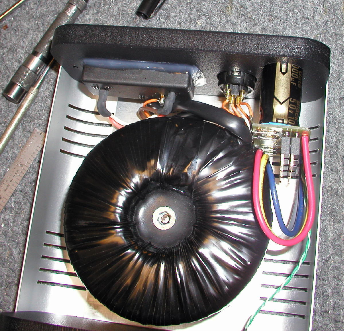

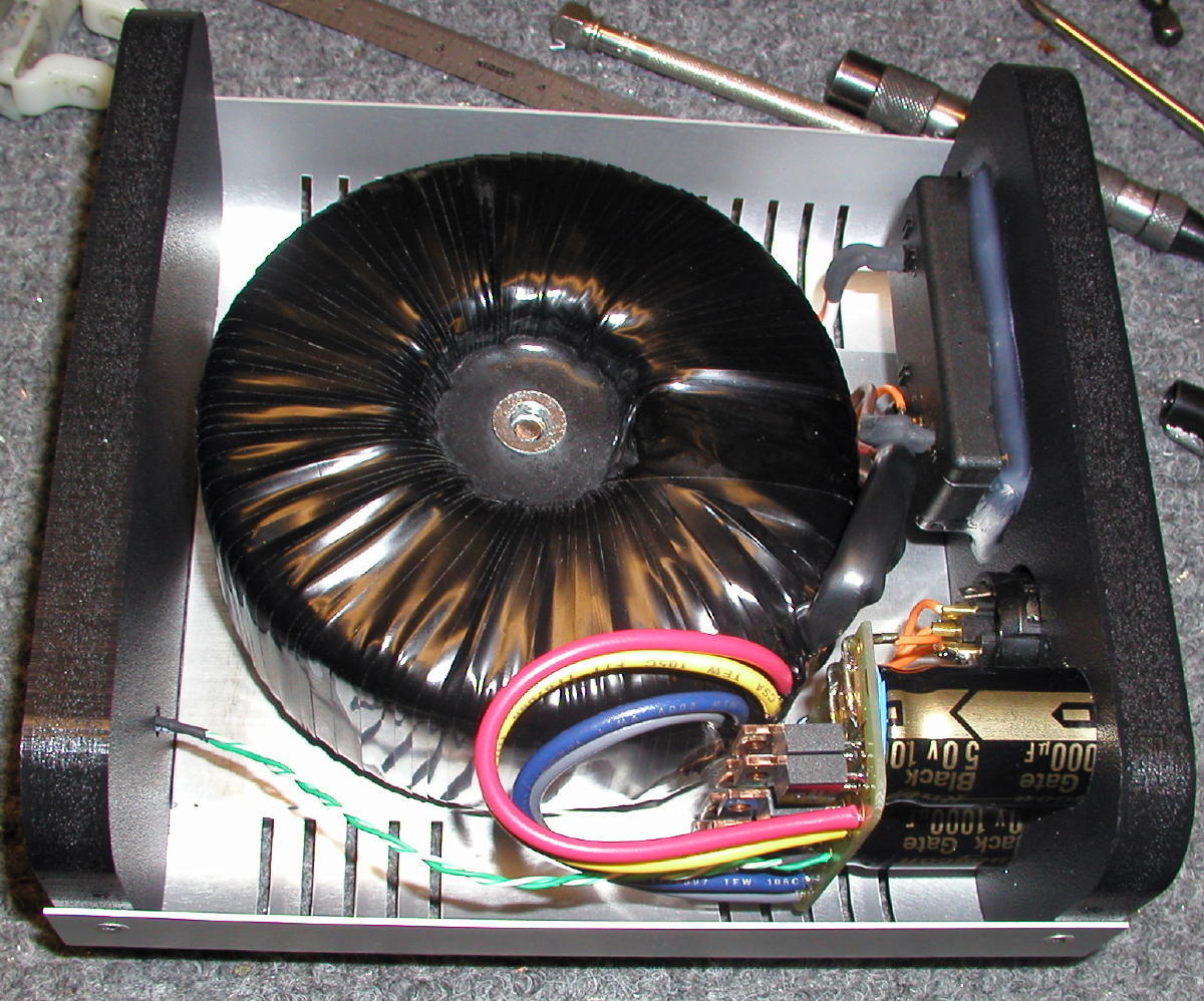

Thankyou for your Answer Peter,
In the meantime I followed Andrews advice and learned some things about grounding of audio components. I found this on the Forum, maybe it will help other beginners too! http://www.diyaudio.com/forums/diyaudio-com-articles/163575-audio-component-grounding-interconnection.html
especially the "design rules" and the short chapter about grounding a PSU is helpful.
there is just a little bit of confusion left. In the pictures of the Patek amp v2 there is no seperate wire for mains ground in the umbilical. I've learned that there should be a direct connection between mains ground and chassis. I don't understand how this is realized in this specific case.
I simply didn't runt that wire in the umbilical, if there is a need for such wire, you can connect the two chassis externally.

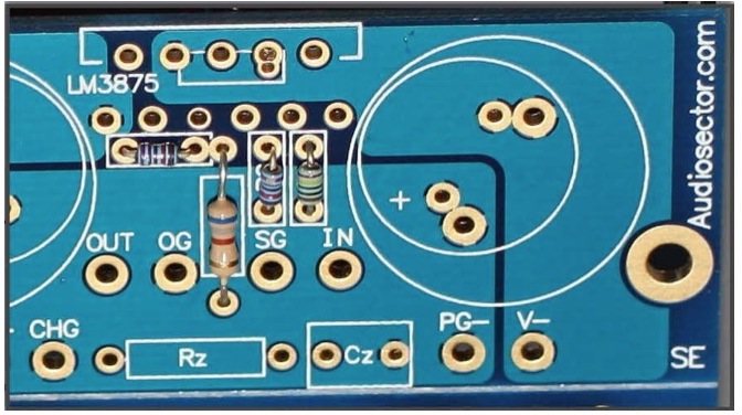

GC kit questions

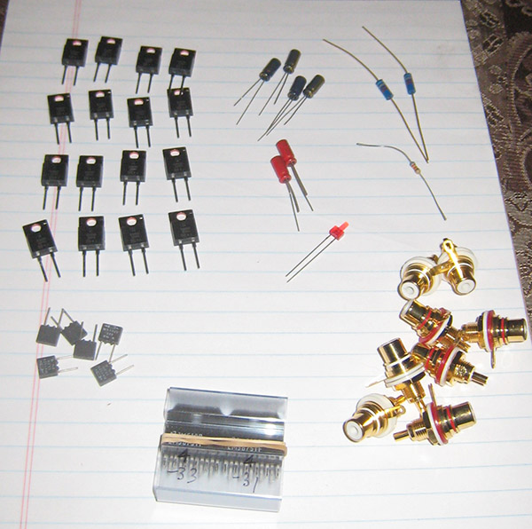

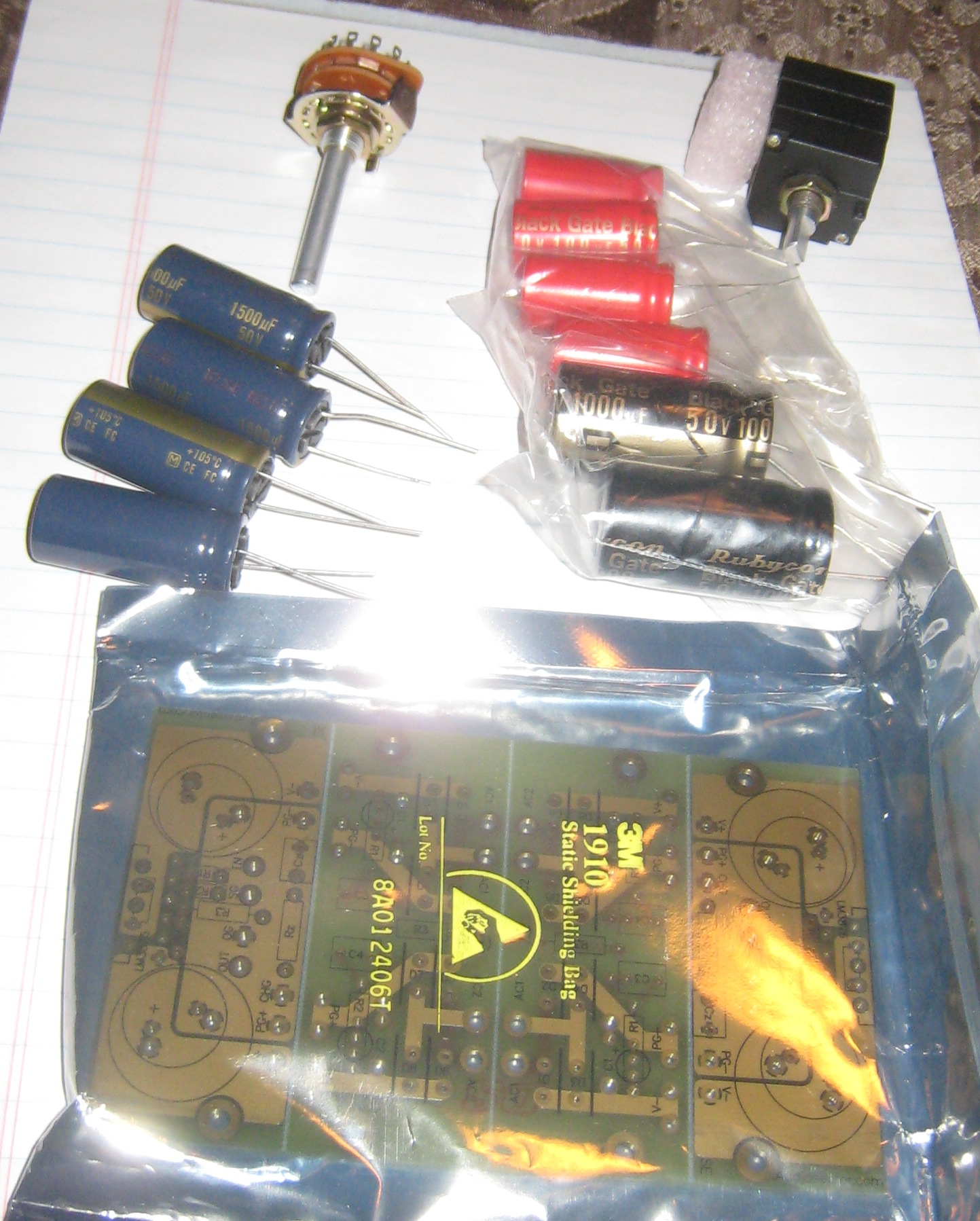

I have some questions. I'm a novice amp builder, though I've made speaker crossovers and cables successfully. I lucked into one of the Special K GC kits, with some upgraded parts, and have been looking at both the LM3875 building guide Peter has on his site, and some updated preferences he developed after making the guide. I'd like to doublecheck I have the parts ID'd correctly and am using the most "recent" build ideas.
First, resistor questions. The original instructions show R1, R2, R3, and Rf on the board.
On the Audiosector site the board has no R1 resistor, and the Rf resistor is mounted right on the LM3875. (I saw directions on this site for doing that.)
Question 1: The directions mention the R1 is optional and Peter says he often just uses a wire; but there is no wire in the later photo, so I guess the current practice is to put nothing there? The parts I have would suggest that, because I have the square 22K resistors and a pair of big R3 680R resistors, but no R1 pair.
Question 2: The single little resistor is I assume the one needed on the rectifier board if I mount the LED. There are images with and without and I believe it is optional to use it?

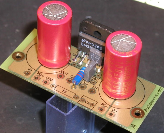

Also, some cap questions. I have four little Panasonic caps, and twice as many diodes as I need, I assume because the original kit was for two monoblock amps, with two transformers.
Question 3: The two little red BG caps are for the kit that was developed to go into the "Specialized" chassis, with one transformer and one rectifier board, correct?
Then I have four Panasonic 1500 uF caps; four BG 100 uF caps; and two BG 1000 uF caps.
The four caps are either/or possibilities for the amp boards, I believe. On the "Audiosector chip amp" thread Peter says, in post 251, "I presently favour 100/50 BG N caps directly beside the chip and 1000/50 BG STD on rectifiers board."
Question 4: Where do the big BG caps go on the rectifier board? The same spot where the little red BG caps would otherwise go? The only picture I could find with the BG 1000 uFs was a review shot, and there the BG caps looked to be mounted on wires to the board presumably because of space restrictions inside the chassis.
Question 5: Peter somewhere he says he likes the BG cap pairing (on the amp and rectifier boards) for the full-range speakers he prefers to listen to. As I prefer generally to listen to speakers with a woofer and tweeter, and a crossover in them, am I better off installing the four Panasonic caps on the amp board?
Question 6: The boards are scored and meant to be separated. Can I just bend them at the score and expect them to break cleanly? or do I need to cut them with a dremel or something?
Sorry to ask so many questions. I'm thrilled to have the amp and don't want to eff it up.

Q1: no resistor as I attach the input wire directly to one of the pads.
Q2: that resistor is indeed for the LED and it's optional
Q3: I don't see any 2 small BG caps in your pics. If you have them and those are 10/50, then they would normally go on rectifier board. And this is still my favorite arrangement: 100/50 BG N caps directly beside the chip and 1000/50 BG STD on rectifiers board
Q4: The big BG STD caps go indeed on rectifier board, no need for small BG N there then.
Q5: If there is a choice between 6 BGs and 4 Panasonic caps, I would definitely go with BGs. Note that those BGs are worth at least $50 ea. now, so you might sell them and go with Panasonics which are still quite good.
Q6: If you bend the boards they will separate easily.

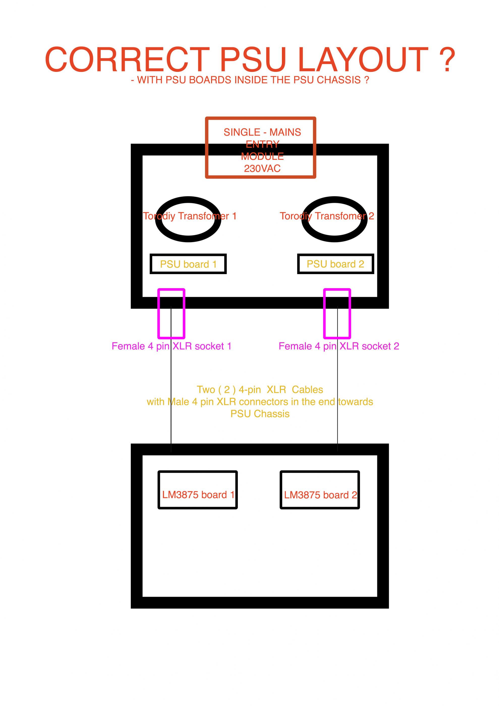

Several Questions About the Build...
Hi !
I`ve just ordered a LM3875 kit.
(with additional rectifier diodes for a dual mono amplifer )
I do have some questions regarding the build:
1. I will need 230VAC Power Entry Module. - This exact item was recommended for me for another build that I never completed. The AC Entry Module is from Schaffner:
FN284-2-06 Schaffner | Mouser
Is this a good choice?
I´ve tried to read the manaul for the LM3875 build thoroughly on the Audio Sector Webpage - the same as in this thread….
2. The 230VAC Power Entry Module ( see link above ) has a 2 A ( will install slow burn ) fuse. Will this be enough? - or should I use a Power Entry Module with a 2.5A ( will install slow burn ) fuse ?
3. I´m planning on using two ModuShop Galaxy Chassis ( modu ) that I already have (230mm x 230mm ) for this build; one for the dual power supply and one for the LM3875 chip amp.
Is it correct to install female XLR connectors in the chassis for the amp and male XLR connectors in the power supply chassis?
4. Any suggestions on what type of power cable I should use for the two XLR cables that will be between the power supply and the amplifier?
5. I see that there are a lot of electrical measurement tools that I do not have described in the last pages of the manual on Audosectors webpage.
Will a Multimeter be sufficient to do the last required measurements described in the manual?
6. Is there a possibility to install diodes in the chassis of the chip amp?
7. I have a DACT CT2-10K stepped attenuator ( DACT audio attenuators ) already installed in a separate chassis ( unit ) - will this stepped attenuator work well as a volume control for this chip amp? Should I install it directly in the chip amp module or can I just use it in the separate chassis where it is already installed?
All help will be appreciated !
Thanks !

2A allows for 460VA (virtually continuously). Do you need that much?
1A does most domestic duties.
The higher the current rating the lower the filtering performance. Size determines what can be fitted inside.

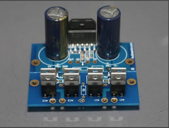

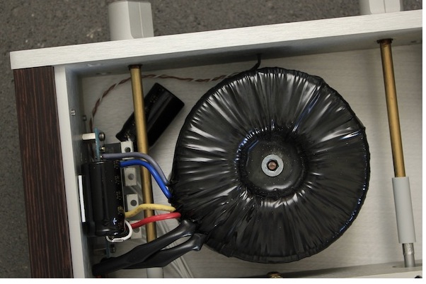

Where to place the PSU boards...
Hi again,
I need someone to confirm my assumptions regarding placement of the PSU boards.
I will use as Peter recommended by email; two Torodiy Audio Transformers with 230V primary and 2x25V secondaries for my 16 ohm speakers.
See attached JPEG files.
I will need to place the PSU boards inside the same chassis of the Torodiy Transformers - right?
I will need two XLR cables between the PSU chassis and Amplifier chassis ( one cable for each channel ) - right ?
Endre
Hi again,
Endre
