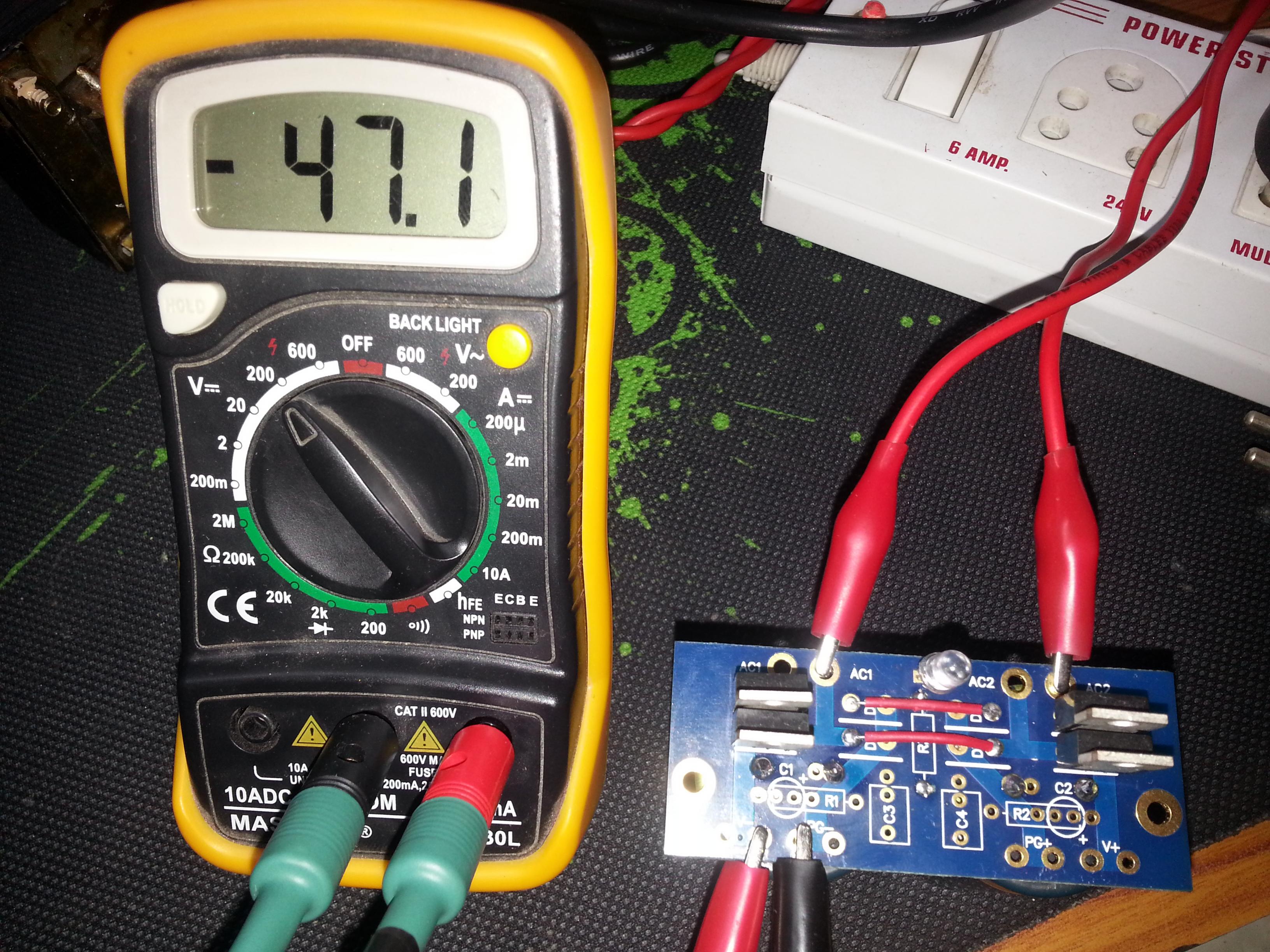

Dear All,
I've a center tapped EI core transformer with 18 0 18 secondaries.
Also, have rectifier PCB from audiosector - I searched on the forum and added 4 diodes and 3 jumpers to use with CT trafo.
The issues I've are that I'm getting a lot of variance in DC voltages.
