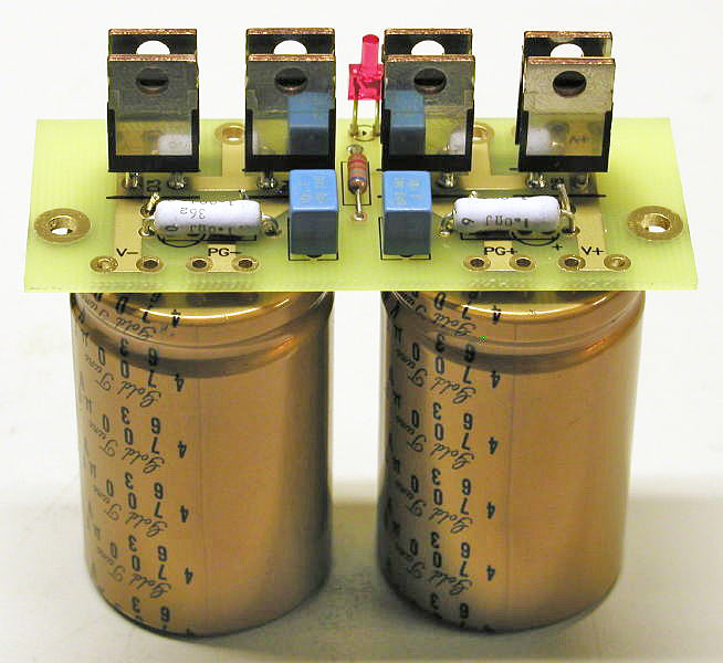

I do not see the power supply caps!😱
Am I blind?😕
You are right, according to Peter D. they are optional?!. well, it seems they are not needed because it sounds good without them.
Trust me....it will sound better with them at least 10000uf per rail.

Power supply caps are not optional and they are not 10uF
The power supply caps are on amp boards and those are 1500uF
Of course you can experiment with larger caps and you may even like them, but then you will be building a different amp, not the Gainclone which is the subject of this thread.
Hmmm, I should have known that. Peter, the amp sounds GREAT, thanks.
Here's the way to attach "optional" larger caps, snubber components are also recommended in such case.

I have an LM4780 premium dual mono setup with 2x 22v transformers. This setup plays fine but it lacks bass. My old standard LM3886 gives better results as does my TA2020. I though about increasing the value off the caps but as Daniel said than i am building amp...
I like to solve this problem because the amp stands in the corner now....

Sorry to say but it seems you or made a mistake or your speakers and/or room have a problem.
The only difference is that I used a 2x25Vac 500vac transformer but i guess that should not make that big difference.

Mmmhh i checked it and all seems fine, and as I play my lm3886 and ta2020 with same speakers in the same room the bass sounds more alive and much deeper. Maybe Peter Daniel has an idea?
The overall sound is extremely pretty...a better bass would make it complete..

How is it built then?
The lm3886 is from chipamp.com is also dual mono and uses 2x25v transformer and the usual chipamp power supply and only the standard parts are used.
I see a lot off builders using caps on the input, could this be the answer?

In that case put the similar caps in LM4780 and you should receive similar results. Previous pic shows that larger caps will fit on rectifier board.
Caps on the input are only needed when source shows DC offset, otherwise, in most cases, they will degrade the sound.
But so much influence??
Thanks for your replies, I will try the swap with the parts.
