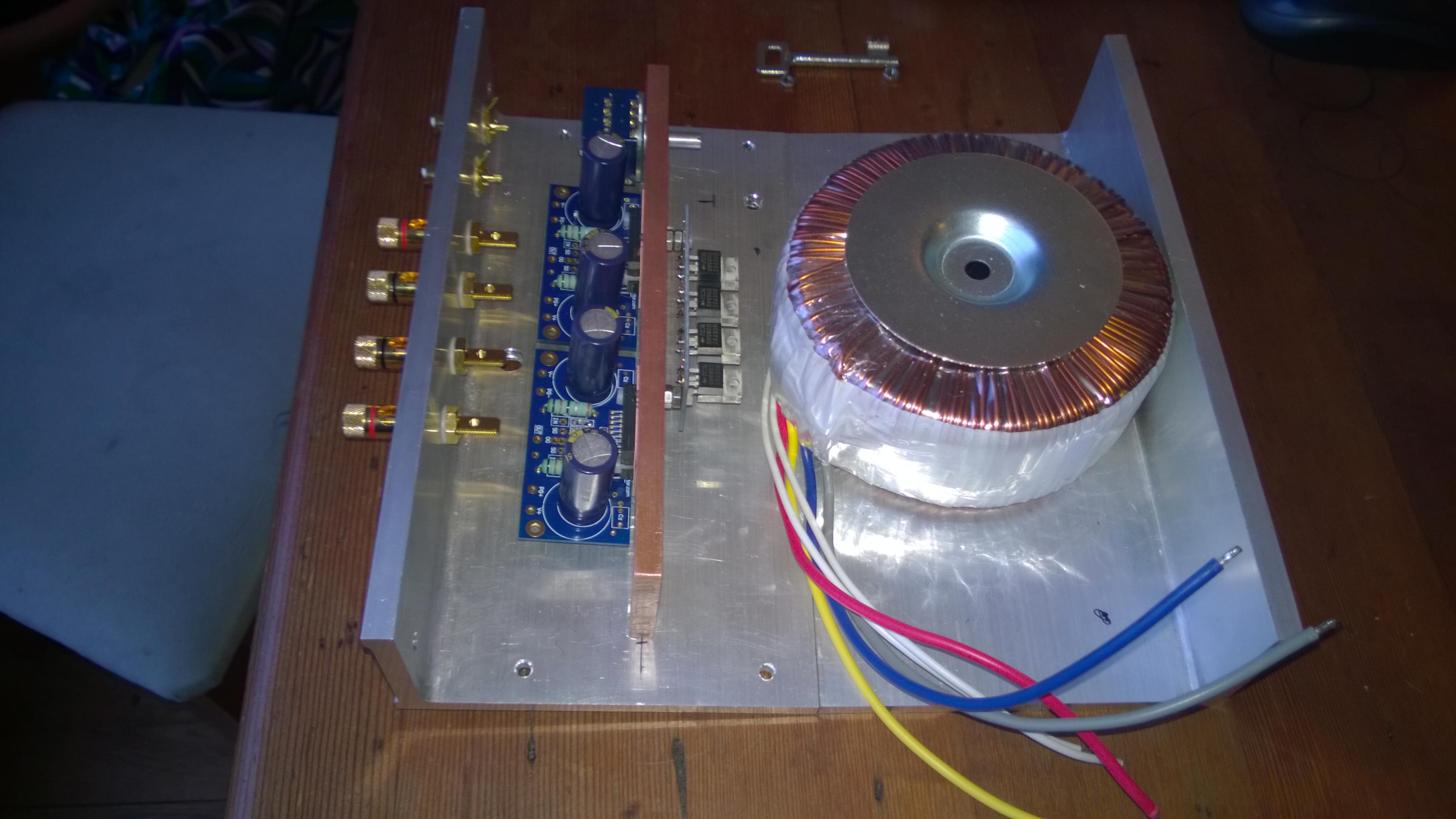

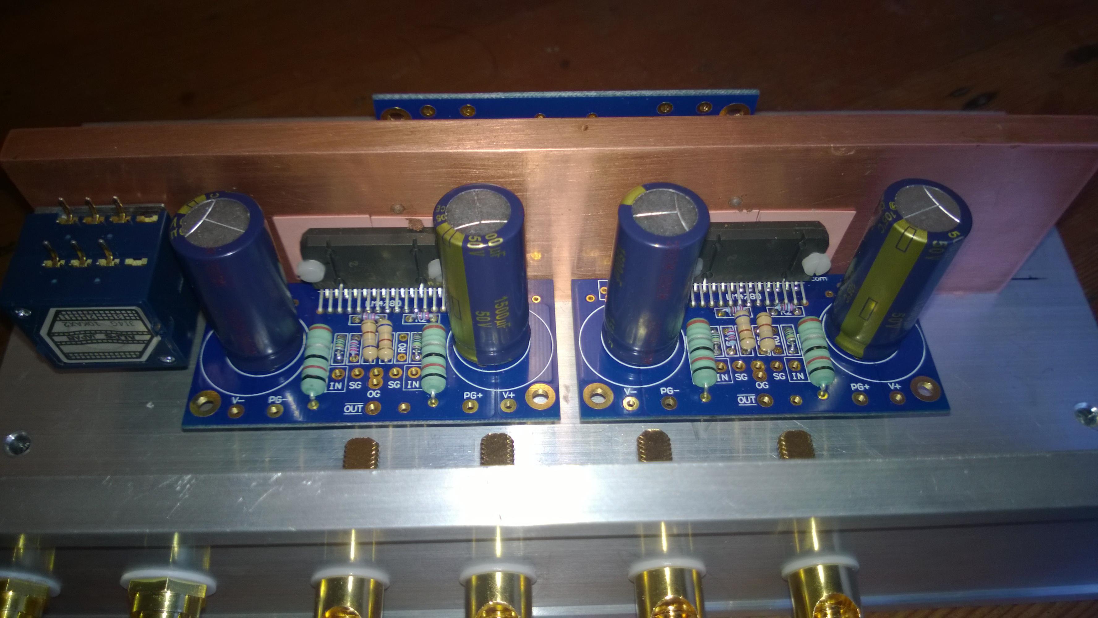

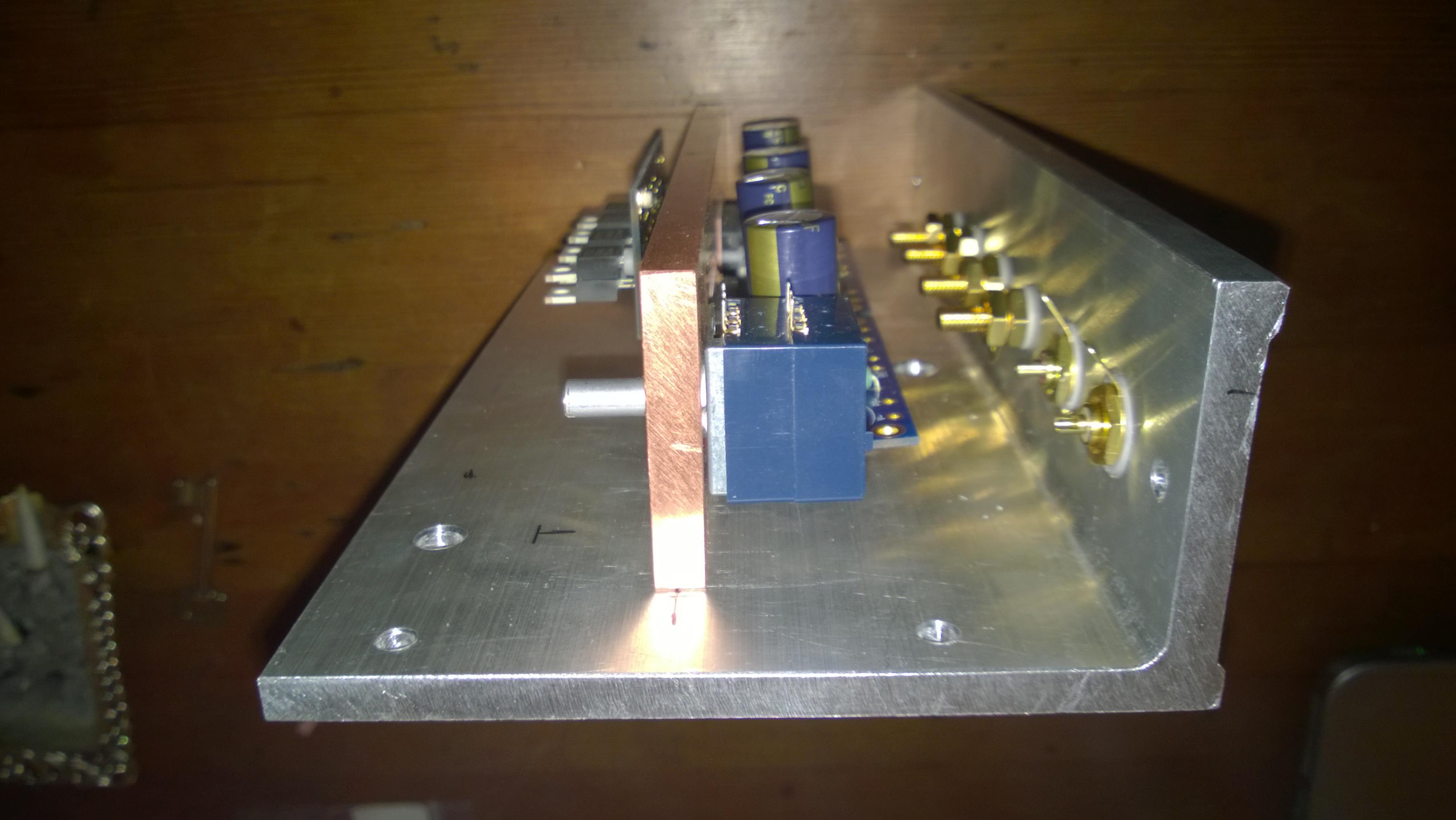

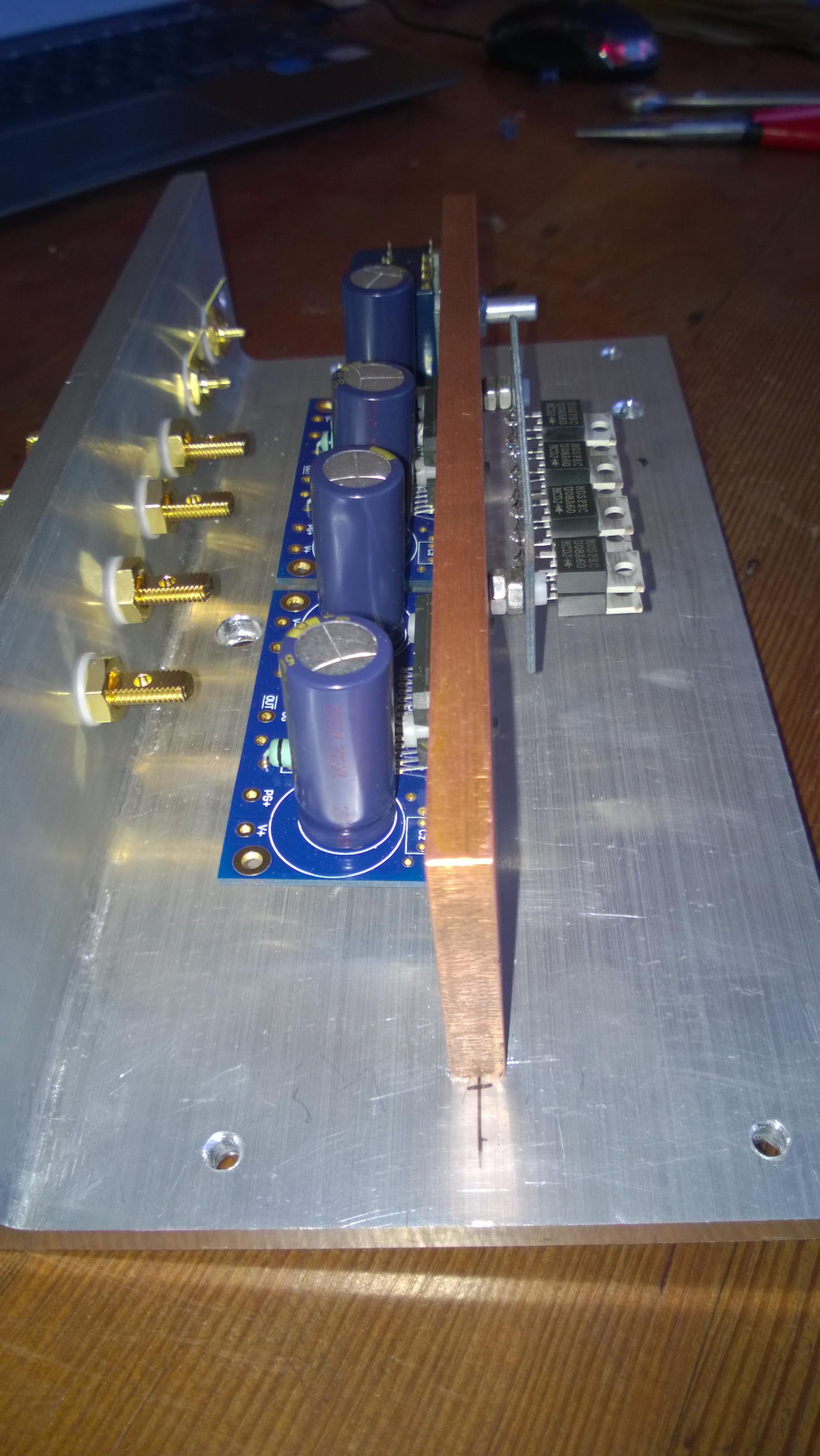

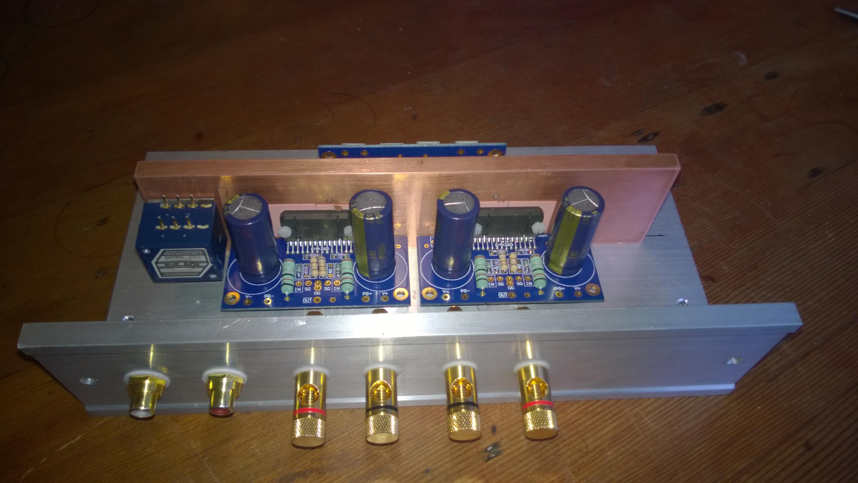

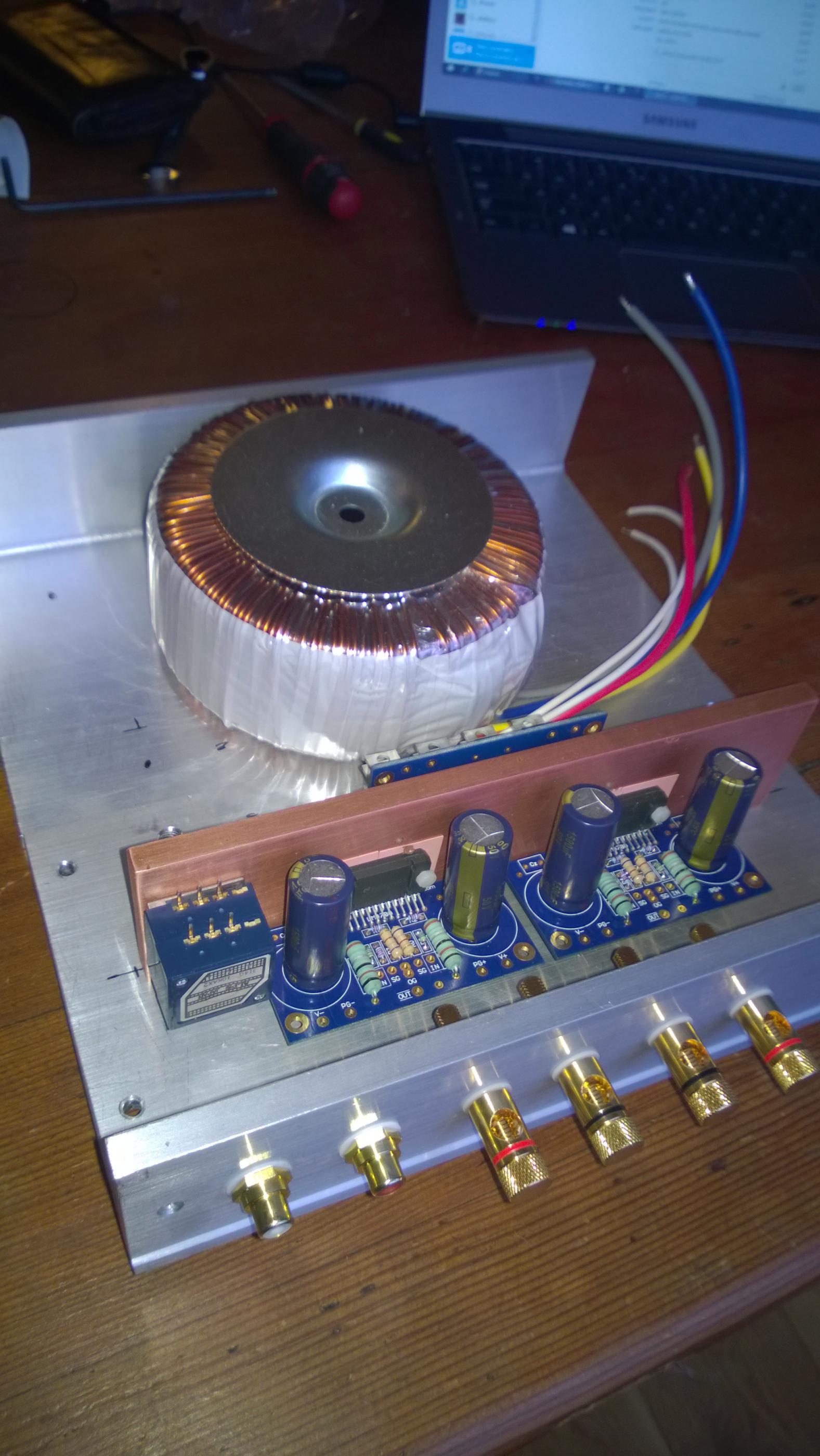

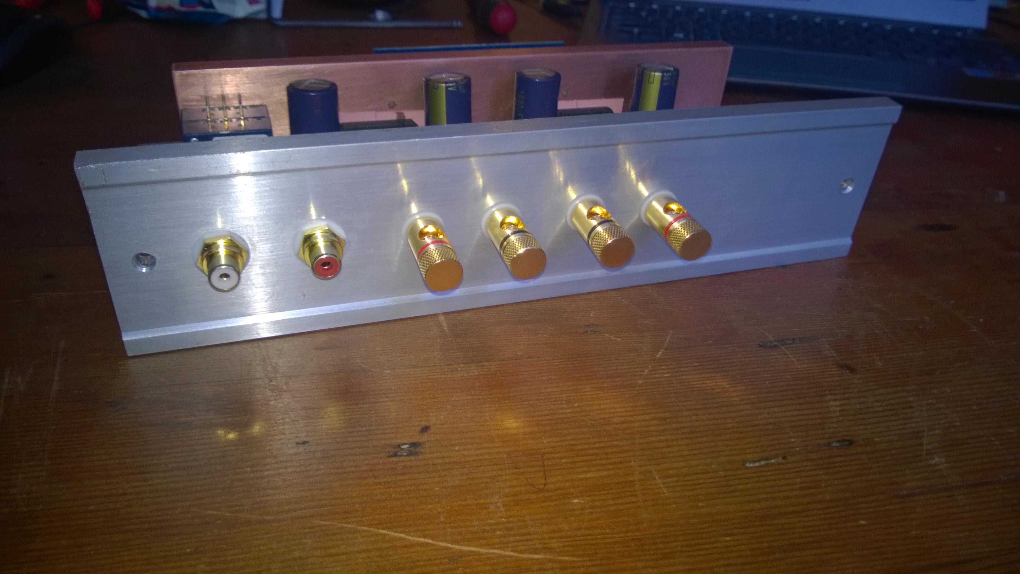

Build LM4780 parallel amp
Here the progress of the build of my LM4780 parallel amp.
The pictures shown are of the amp upside down, the sides I want to cover with oak wood and the bottom will stay open.
The transformer is 2 x 25V 10A 500VA
The heat-sink inside is a copper bar 8 x 50 x 200mm
The cover is aluminum 7mm thick
The star ground I've planned in the middle of the copper bar
The insulation between the LM4780 and the heat-sink is made with silica pads without paste.
I've used an Alps pot for volume control.
Any comments and/or suggestions are very welcome
Greetz,
Joery
